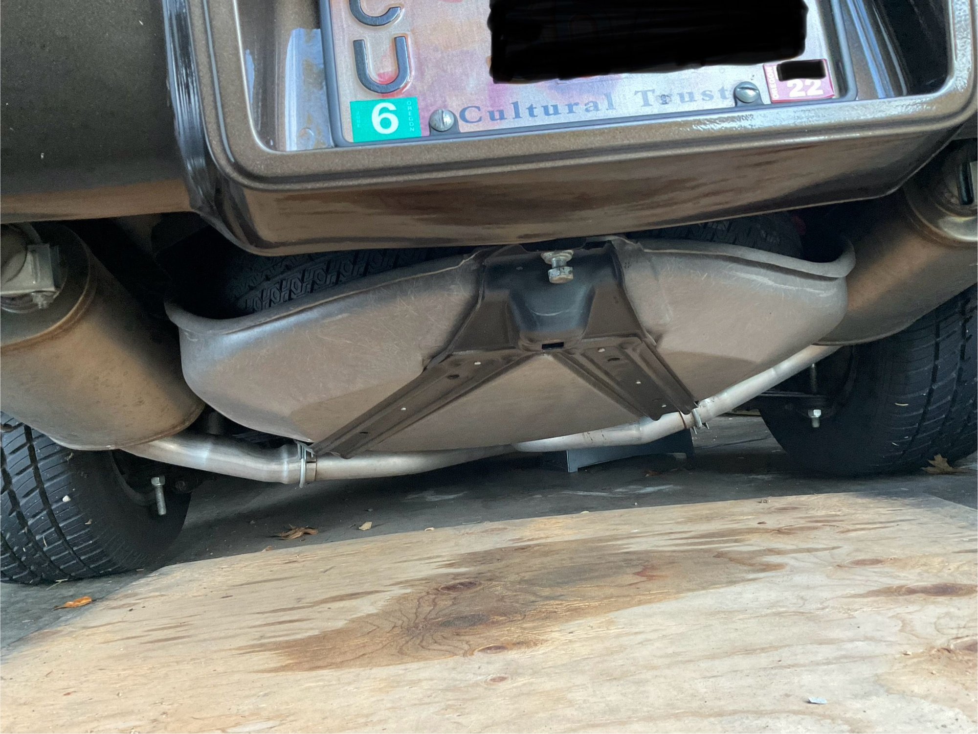

Here’s a picture of my ’78 before cutting off the ends of the lowering bolts. Front and rear springs and shocks have since been changed with a composite spring in the rear. Result; same problem, adjust at the nut and cut off the excess bolt. Saw someone else on this forum use a castle nut with the threads reamed out to raise the low side. I haven’t tried this, but the spring has a little side-to-side play if the mount is loose. With it loose, tap the spring or individual leaves toward the high side with a BFH and retighten.
Charlie
