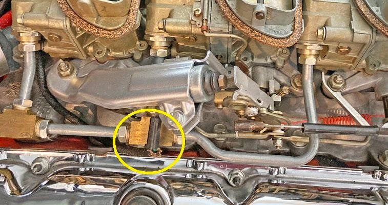

Laying on the intake near the carb. Green and black with a ground connector. This has to be part of a LectricLimited harness,
but it was installed years ago by someone else, so not sure what it could be fore. Any ideas?

On my 78 that goes to the front of my AC compressor

Do you have A/C? The picture is from my 69 tri-power, but in 69 there was a green wire from the A/C compressor to a solenoid to keep the rpm's up a little and to keep the engine from stalling if you dropped the throttle to idle.
On my 69 there is only a single green wire that is run in a black sleeve to protect the wire from heat.

first thought, AC plug

AC is what I was thinking but I didn't want to say that out loud until I got some informed feedback. It makes sense it would be very close to the back end of a compressor, if one were there.

First thought, green and black with that ring on the black. Air-con.
