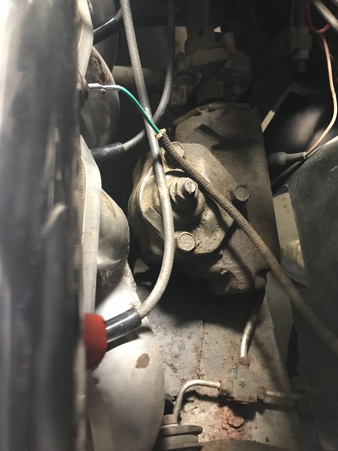

ar is 68 coupe. All new LL wiring installed a few years ago. I noticed this single yellow wire lying above the steering box. It comes out of a harness thru the firewall. Anyone have an idea what it is for?

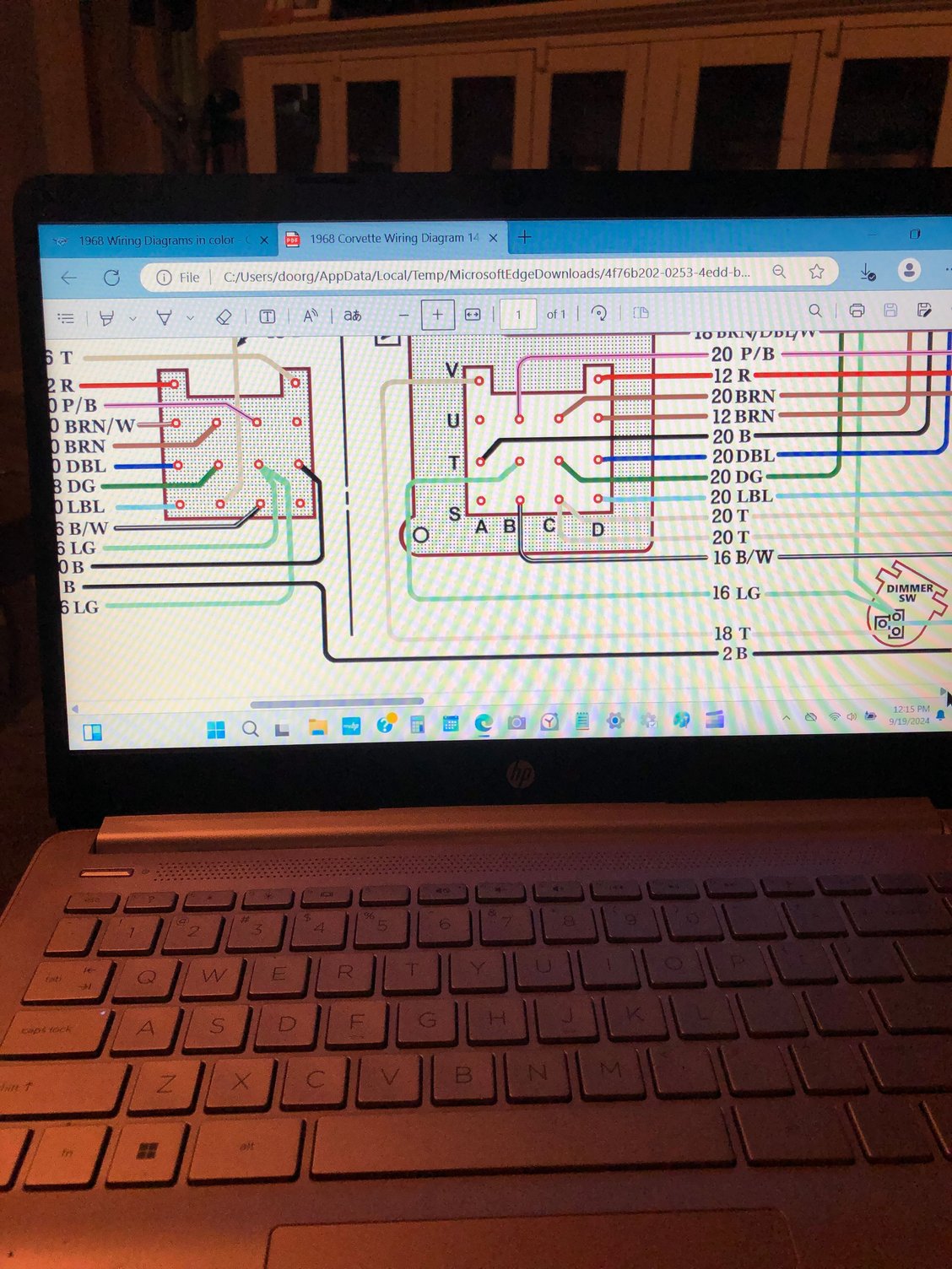

this diagram is for my SB '68...the left side of the photo shows all the wires coming out of the firewall.
Is it possible the loose wire is actually TAN?
It would plug into the Brake Fluid Warning Switch located near the Master Cylinder. The contacts need to be cleaned for it to work correctly at the dash lite (I think).

Certainly looks like the right connector for the brake warning wire

Yes that's it, the brake imbalance warning light.

I checked under that brake block and there was the connector for it. You guys are awesome! Thanks!

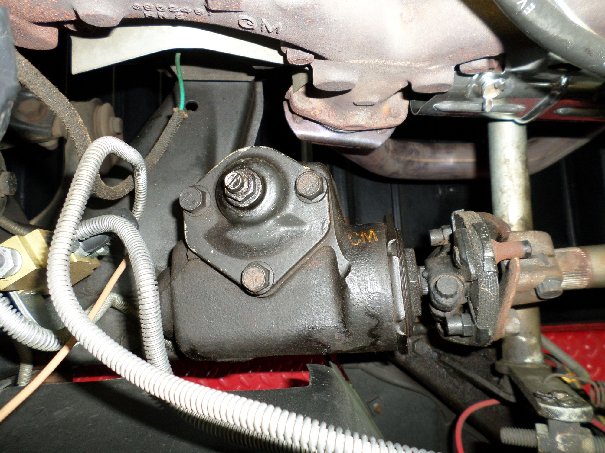

This is what I also think it's for. The green insulated wire is for the intake manifold thermostat.

I believe the green wire with the protective sleeve is from your temperature gauge.

Coolant temp sensor cylinder head between cylinder 1 and 3.
