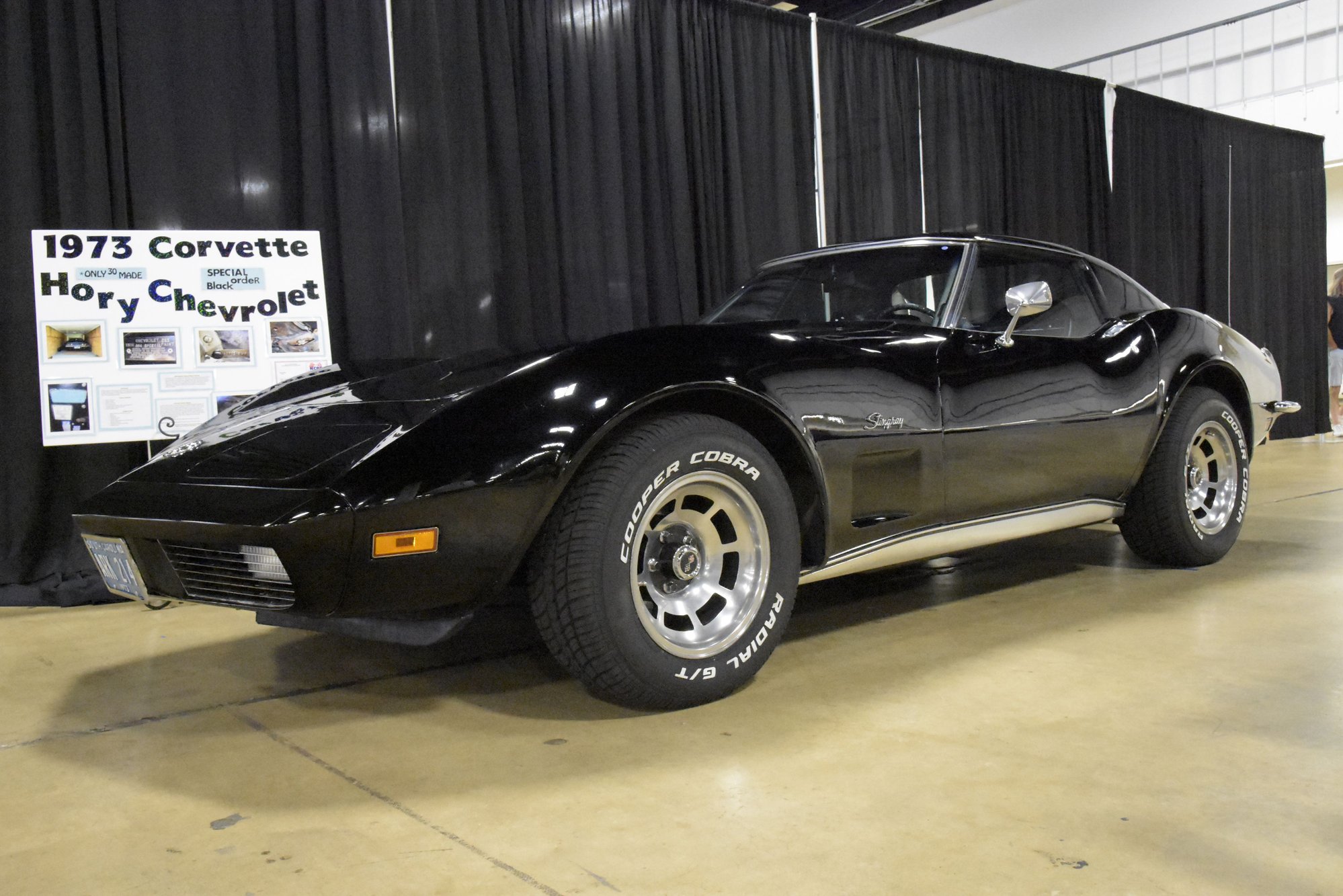

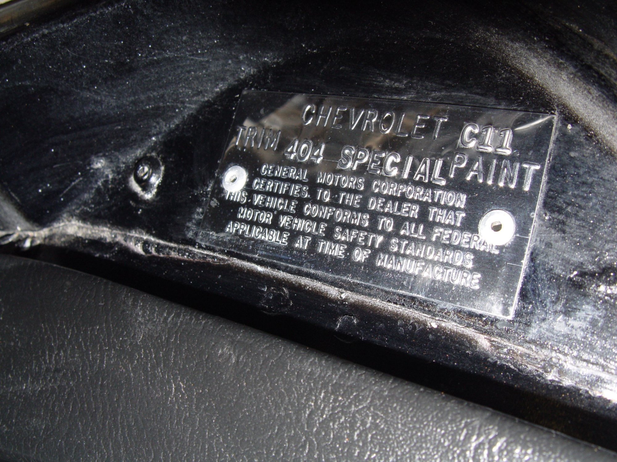

Most interesting, I'm surprised one of the forum's member owned/ownes a one of the SPECIAL 1973 blk/blk/blk Corvettes ordered by Horry Chevrolet. He has posted on the forum and I'm sure you can look those up. My point is that the SPECIAL black paints were associated with 1973 rather than 1974. The tags included the word SPECIAL as noted above. Documentation is a must to authenticate black paint in 73-74. Otherwise, purists consider these "individual inspirations." Include the VIN # as well. Here are a few photos of the 73 blk/blk Corvette. The owner displayed the extensive documentation that both, came with the vehicle, as well as what he researched and found.
The car was displayed at the NCRS national Convention in Greenville, SC a few years back.
The details
and the VIN tag
The details
and the VIN tag
Look at this trim tag vs. the one from SE Jinks -- they are not the same in the way that the characters are formed. This is a known real tag - the one posted by SE Jinks is distinctly different and I have been told by multiple experts that there was only a single trim tag producing machine at the Corvette plant so there should be NO deviation in the printing of the characters in the message starting Certifies to the dealer. I am not saying there were no factory painted black cars in the mid-70's I just believe that SE Jink's car isn't one of them.
