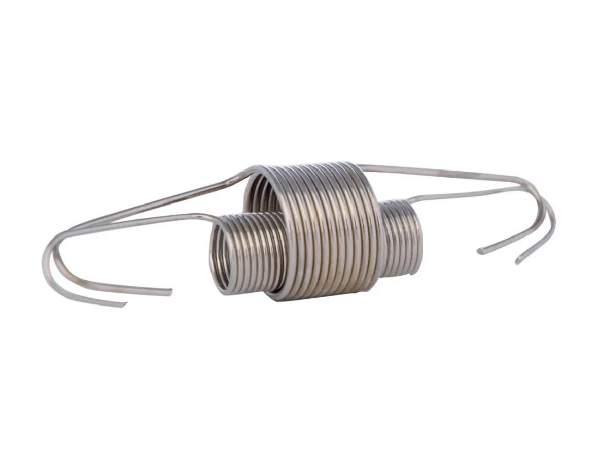

Since we have brought up Lars.....When he rebuilt my QuadraJet he suggested that I cut out the carpet in back of the gas pedal, it may sound odd, but for sure gave an extra kick to my 427..... A more common and subtle problem is the issue of inadequate throttle cable travel. This is very common on Corvettes and Camaros. With a helper in the car and with the engine “off,” have the helper fully depress the gas pedal (with the engine hot and the choke wide open to assure that the lockout lever is disengaged). Observe the carb on the driver’s side and see if the secondary throttle moves to the wide open position: You can grab the throttle lever once the assistant has the pedal to the floor and see if you can move it further. If the gas pedal does not fully open the secondary throttle, you have one of several methods to fix this:
a. Remove your floor mat. I call this the “25 horsepower floor mat tuning trick.”
b. Install the throttle cable in the correct position on the throttle lever. The Q-Jet has an “upper” and a “lower” cable attach hole: The upper hole was used for trucks and station wagons. The lower hole was used for Corvettes, Camaros and Novas. If you install a Corvette throttle cable in the upper hole, you will never achieve wide open throttle since there is not enough cable travel to open the throttle from the top lever location.
c. Straighten your throttle cable attach bracket. The bracket that supports the cable at the carb is often bent slightly forward. If the bracket is bent or moved forward, it will not allow enough cable travel to open the throttle fully. Simply bend the bracket back just a tad: I use a big hammer and a steel rod to give it a whack. I call this the “25 horsepower hammer tuning trick.”
d. Fix your gas pedal linkage. Very often, the actual steel linkage coming off your gas pedal will be bent a little “flat.” This will cause the pedal to hit the floor before the carb is wide open. You can give the pedal more travel by simply grabbing the gas pedal and bending it up off the floor. Care should be taken not to damage any plastic pedal rod bushings when doing this: Support the plastic pivot points when bending the pedal rod so the plastic bushings do not break.
e. Fix the slop in the gas pedal attach lever. Many C3 Corvettes have a bit of wear on the lever that attaches to the gas pedal rod: The rod is "D" shaped, and the attach lever has a "D" hole with a screw tightening feature. If this "D" hole is worn, you can remove the lever, grind some material off the locking feature surfaces so it snugs up tighter, and re-install it to gain some travel.

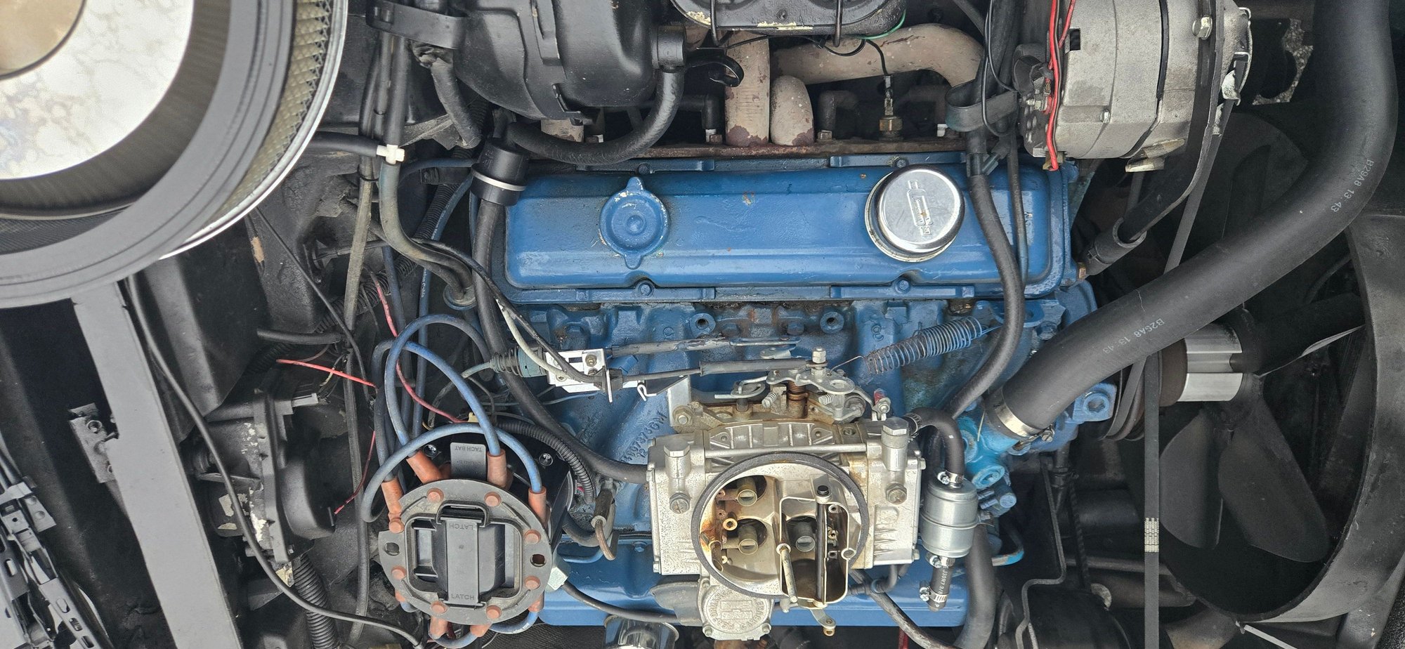

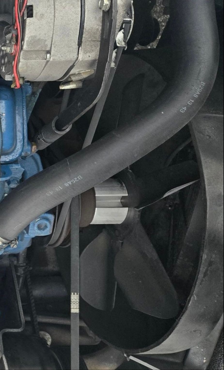

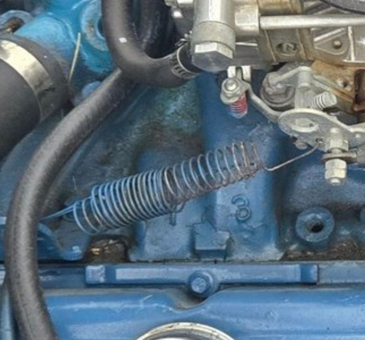

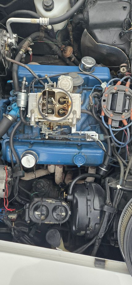

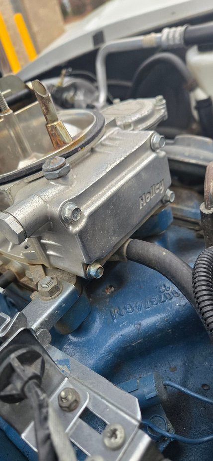

Here you go
Old Oct 15, 2024 | 09:19 PM
Piersonpie's Avatar
Piersonpie
Joined: Apr 2021
Posts: 2,711
Likes: 2,160
From: Minnesota
I like the blue. It looks like an original intake manifold, although repainted as evidenced by the overspray on a few things. It’s a spread bore design, and your square bore Holley carburetor has an adapter plate to fit on it. This is not ideal for peak engine performance. Here is a thread that outlines some of the issues with doing this.
You have two options, either replacing your intake manifold to a square bore/dual pattern one, or changing your carburetor to a spread bore one.
Not necessarily a performance increase, but another thing that would help your engine would be using a PCV valve. Replacing the breather on the drivers side valve cover with one then running a vacuum line to the carburetor would pull a vacuum on the crankcase when it needs to vent, preventing oily fumes from getting all over your valve covers.
It’s hard to tell from your pictures, is your vacuum advance line teed together with something else? It also looks like there’s an open port on the vacuum fitting on your intake. This is a massive vacuum leak, and should be capped immediately.
Another thing that would impact engine performance is your radiator fan. It appears to have been solidly mounted with a spacer to the water pump pulley. This is fine at idle and low speeds, but once you’re moving this places an unnecessary load on the engine. Changing this out for an original fan clutch or an electric setup would fix this.
One of your throttle return springs is hooked to the other one rather than the throttle lever on the carburetor itself. There’s nothing wrong with only running one spring, but I would either remove it entirely or make sure it’s connected to the right spot.
Only other thing I notice would be making sure your spark plug wires aren’t touching and inducing a current in each other. Specifically the #5 and #7 wires, since they’re so close together on the distributor and the block.
One your your throttle return springs is hooked to the other one rather than the throttle lever on the carburetor itself. There’s nothing wrong with only running one spring, but I would either remove it entirely or make sure it’s connected to the right spot.

1. Carburetor isn't necessarily a performance increase
I've talked to quite a few people and they have sworn up and down that the holley is helping the performance. I mean so many people say the l48 is a slow dog but I've driven it quite a bit now and it's either been hopped up, or maybe it's just the torque. I don't know. My thing is: why would someone change the carburetor to a racing one if it didn't really help the engine? The thing will scoot.
2. Ive looked at the advance line, i dont think ive noticed any leaks in the line. I haven't heard any hissing that would come from a vacuum leak, nor has any of the vacuum driven systems been affected so far. Engine runs great.
I don't think it has a vacuum leak. Yet...
3. The fan is actually plastic for some reason. What do you mean it puts "unnecessary load on the engine"?
is it okay to leave it how it is? Or is that something that needs to be fixed?
4. I have no clue what to do with that spring. I'm very new to these sorts of things...
5. I didn't see any of the plug wires touching. Just had a new distributor put in with a new rotor and spark plugs.

1. A Holley carburetor isn’t a bad thing, they were used on many late 60’s early 70’s performance cars. The original Quadrajet carburetor wasn’t bad by any means either, just set up on the lean and on the lazy side from the factory. Any carburetor can be set up to produce any air fuel ratio you want, leaving you with the other variables of top end air flow and fuel emulsification abilities. Your Holley carb should have plenty of flow for your L48, but the adapter mating it to an intake with a different mounting pattern throws the fuel emulsification abilities all out of wack.
2. I don’t believe there is a leak in your vacuum advance line, just concerned that it is spliced in with something else. The vacuum advance should have its own individual line to a full manifold vacuum source. I do believe there is a leak in your 3 pronged intake manifold fitting. Take a closer picture of the piece I circled in my previous post.
3. Your fan will function just fine the way it is as long as you don’t notice your car overheating. But changing it out to an original piece with a fan clutch makes the fan “cut out” at a certain temperature because there is adequate air moving through the radiator from the car itself moving. With a solid mounted fan it will constantly try to pull air through the radiator, regardless if it needs to or not.
4. Doing nothing to that spring will be fine, but if you want to get a shiny brand new one most parts stores sell them for fairly cheap. You can use one or both, depending on how stiff you want your gas pedal to be. Personally I only run one.
5. If your distributor was replaced I would definitely check your timing. If you don’t already have one get a dial back timing light, and check your timing at idle with the vacuum advance unplugged. There’s lots of resources online that can help you with this.
