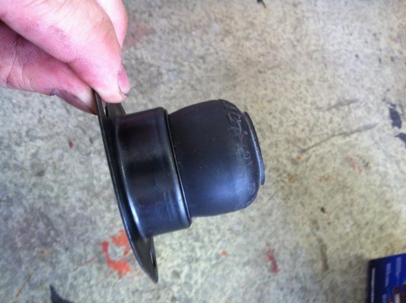

Hi. I've opened the boxes on the recently arrived Moog ball joints.
No surprises with the lower ones, but the tops come with an "extra" shroud-type piece, pictured here:
Based on the on line instructions, this part is fitted below the A-Arm. However, the instructions clearly have a "generic" element as they mention Ford and Chrysler applications.
As far as I'm aware, this piece isn't mentioned in the AIM and I don't see it on my car. Am I expected to fit it ,or is it only for certain other makes?
Thanks.

I just did mine and i put the joint down in the arm then put that piece on...i sandwhiched the control arm between the two..dont know if right but its working..

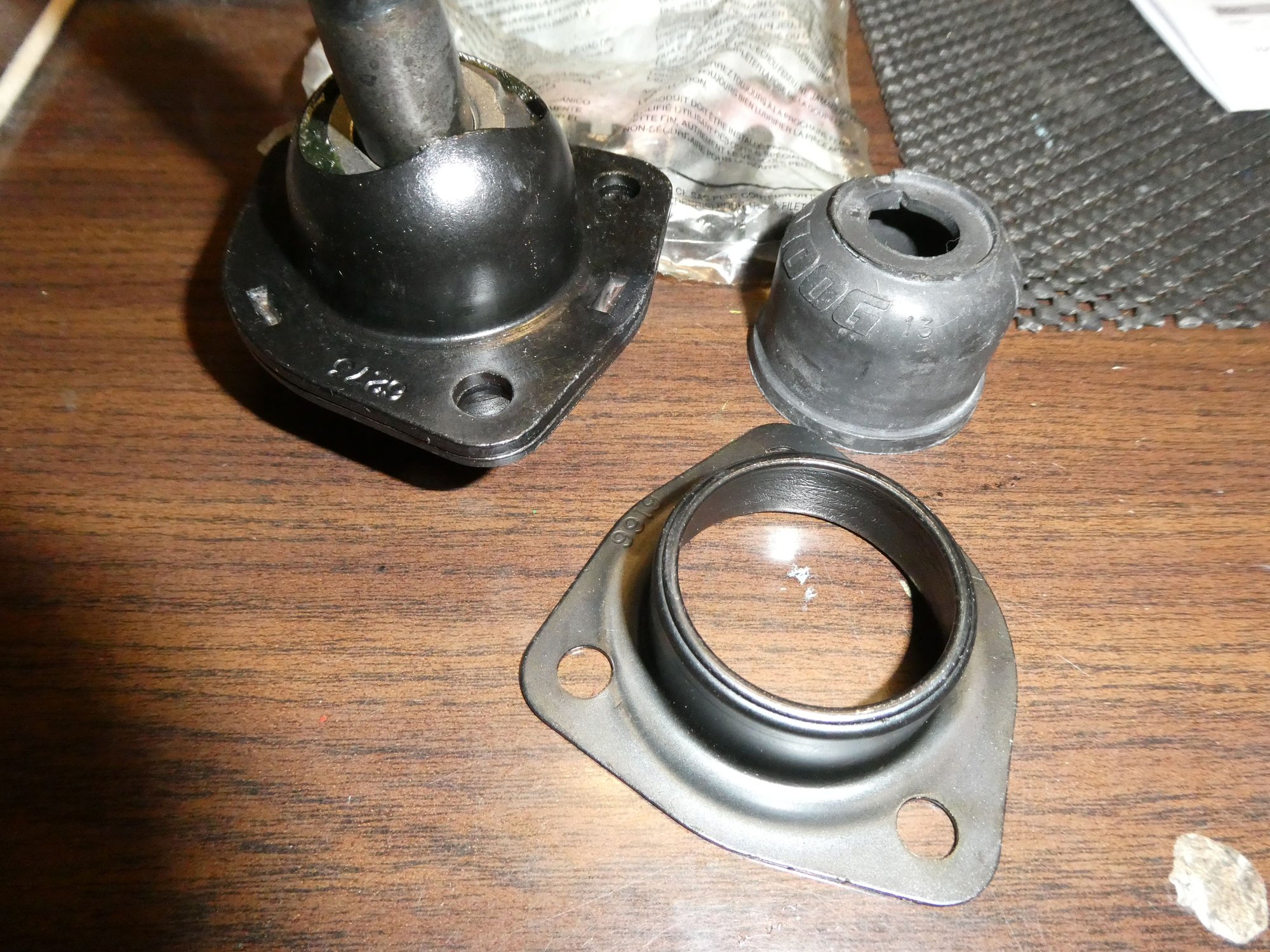

Mine was missng..
see post 14.. i had it wrong and learned the correct way..
https://www.corvetteforum.com/forums...rs-method.html
instal here
https://www.corvetteforum.com/forums...procedure.html

Have a look at the last post here
