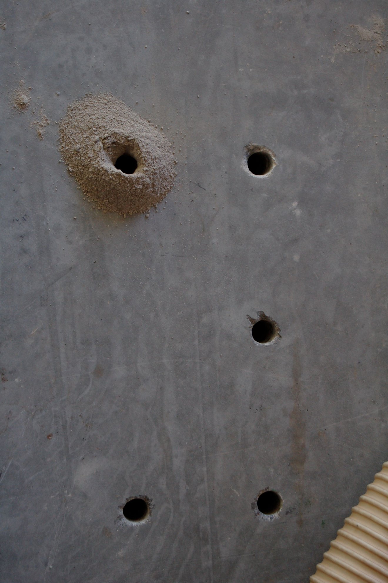

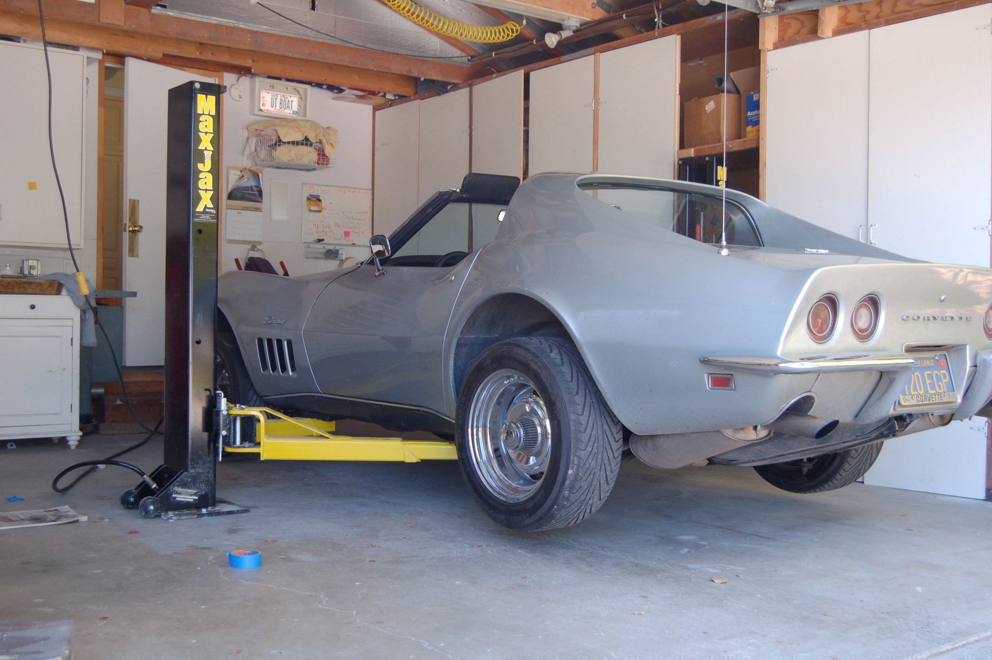

Excellent question Richard. I show 115" from the hole with the concrete dust on it to its counterpart on my install. I could just get my C6 up in the air with this spacing but I doubt my C8 will fit and I don't even want to try it. Additionally I can get my daughter's Infinity uip on the posts as well.

This may help

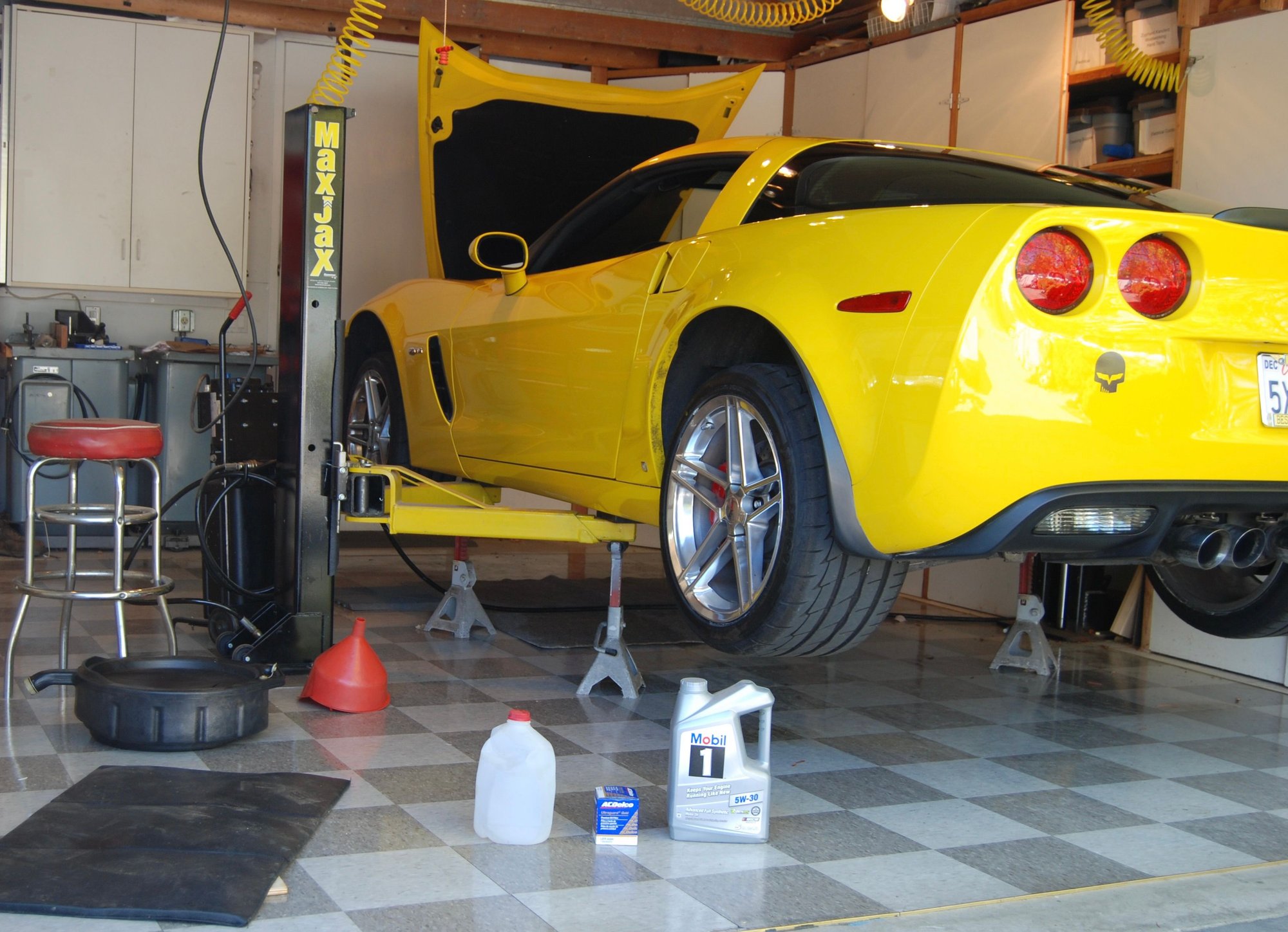

I sensed there could be some confusion in my post so I thought the picture should make things clear. Here's the other car:
Notice the jacks? Safety first always. I actually have never seen any creep in the anchors but what the heck.

I plan to use high lift jack stand front and rear as well.

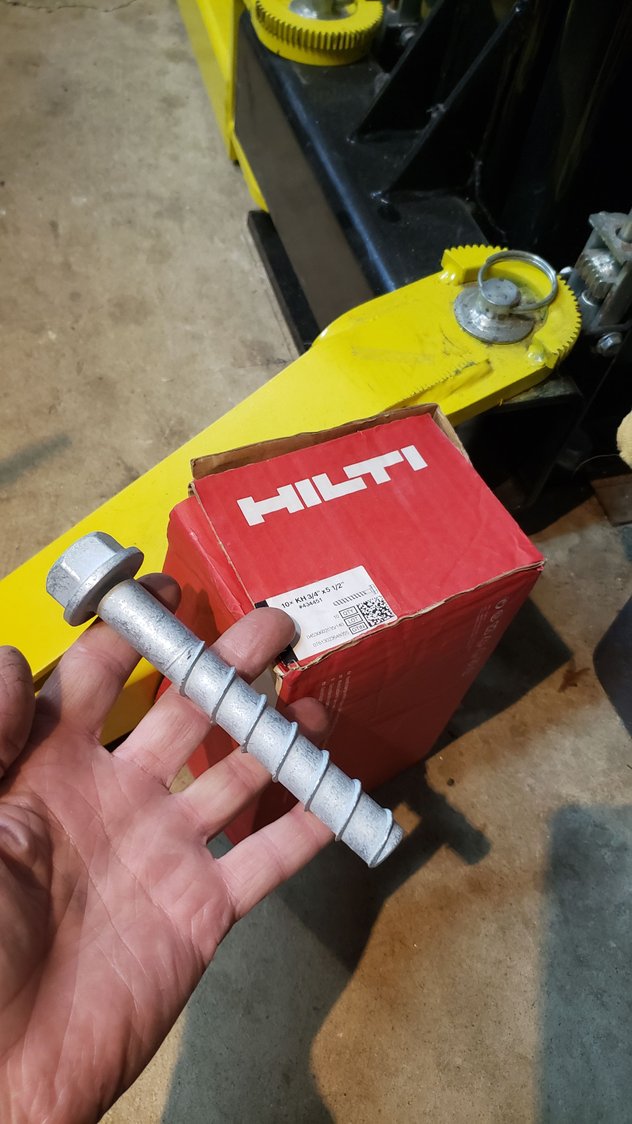

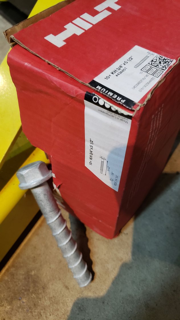

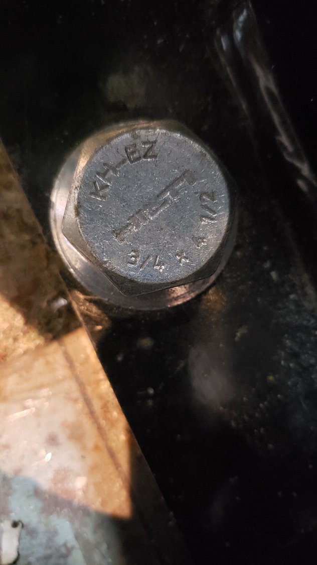

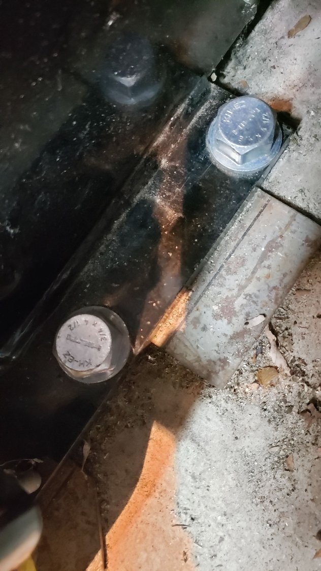

So mine is 8'5" appart at the base plate. It's fine for my C3 and C5. It's in a small one bay garage but it's a life saver. I have four lifts at work shop so if I need room I'll go there.
I used these bolts because they exceed the specs from MaxJax for anchors and are re-useable. I used 4.5" at home. I have these longer ones for thicker concrete. I've used this style for decades in construction without issues.
Just my ideas to make installing and removing easier....
