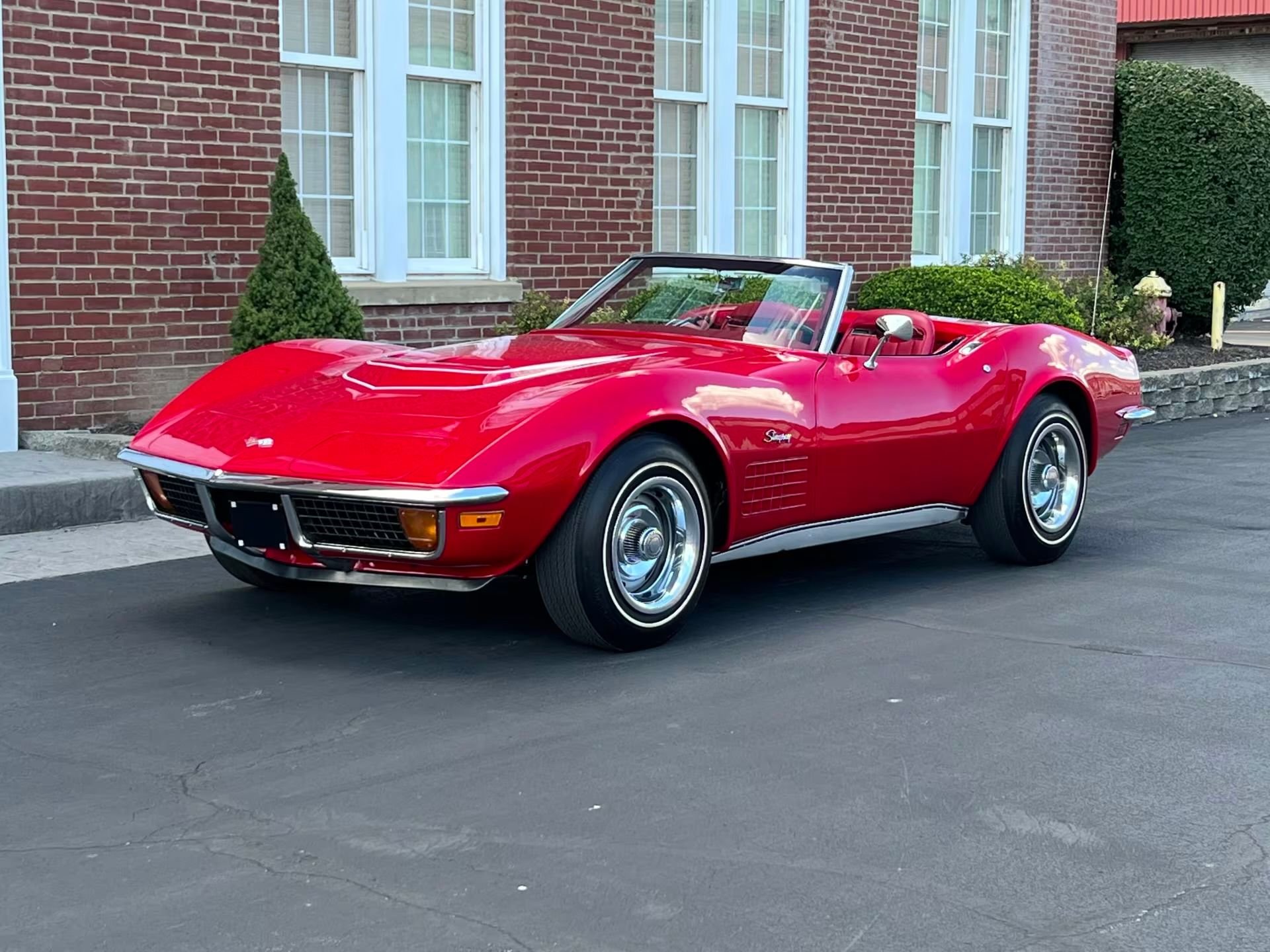

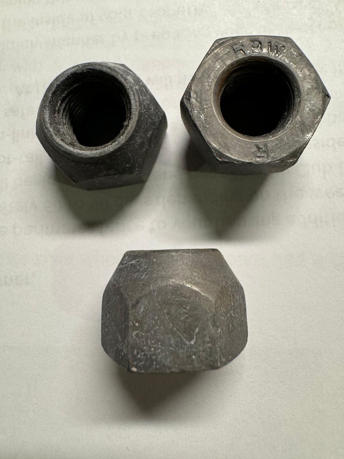

Please see the attached photo. Is this the correct finish for these Lugnuts on a 1972 LT one or are they supposed to be flash chrome. Thanks for the feedback guys appreciate it.

The lug nuts the picture are for the steel rally rims.

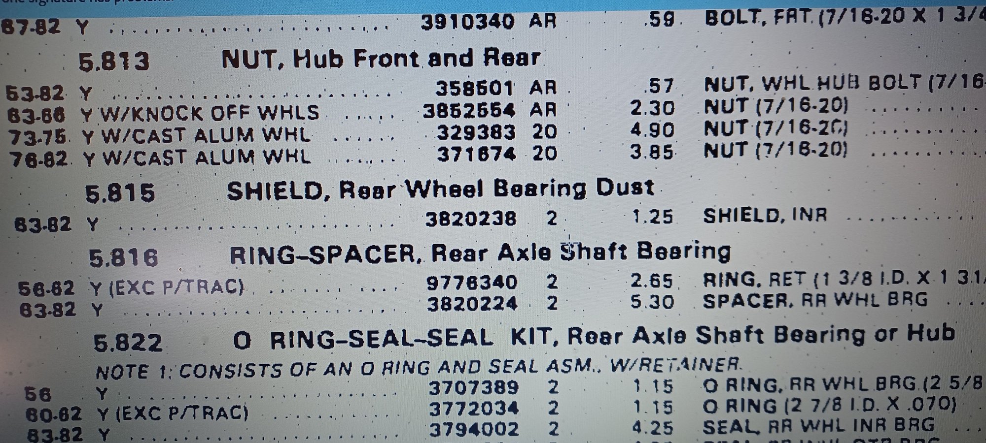

358501 is the GM part number for your lug nuts.
Genuine GM OEM 358501 Zinc Coated Lug Nut

That is beautiful. An iconic Corvette to say the least.

That's known as clear zinc...
