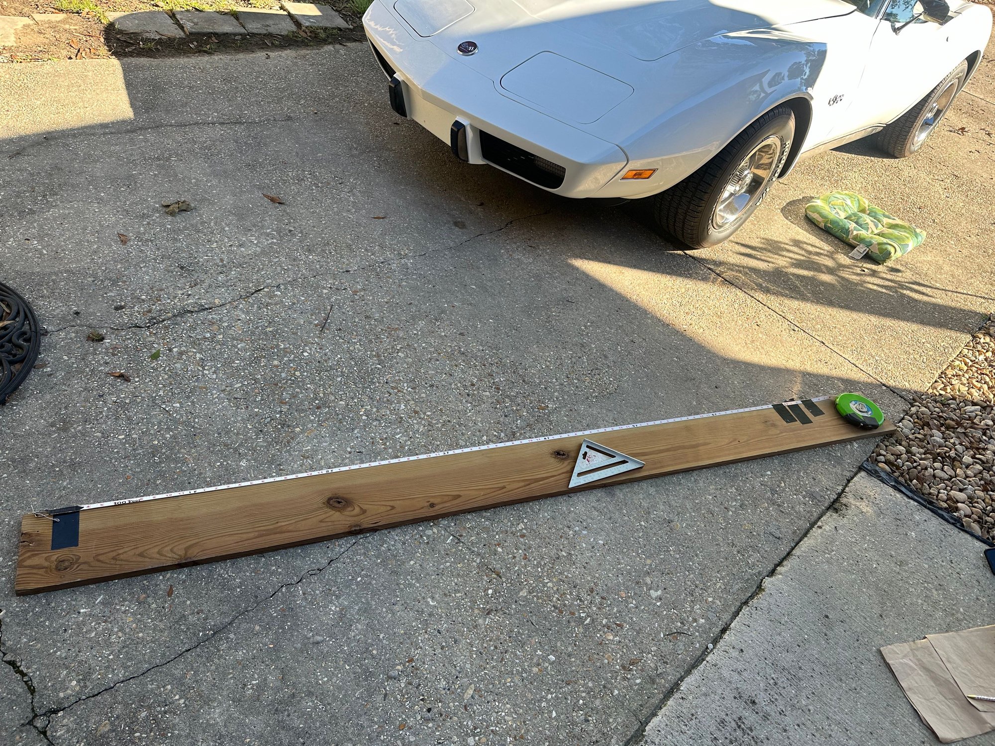

What a difference driving can be with a simple front wheel alignment.
My 75 has always handled very sensitive. After watching a video from “Problem Solver Garage” on the tube, I saw a simple technique of checking your toe-in.
I found where I was out 1/4” where the specs I found show 1/32-3/32 IN.
I decided to give it a try and made up a measuring board, made the adjustments and, wow! My car drives so much better when the toe-in is on spec.
Didn’t cost a dime.
I will eventually get a professional alignment, but until then, I am riding much better.

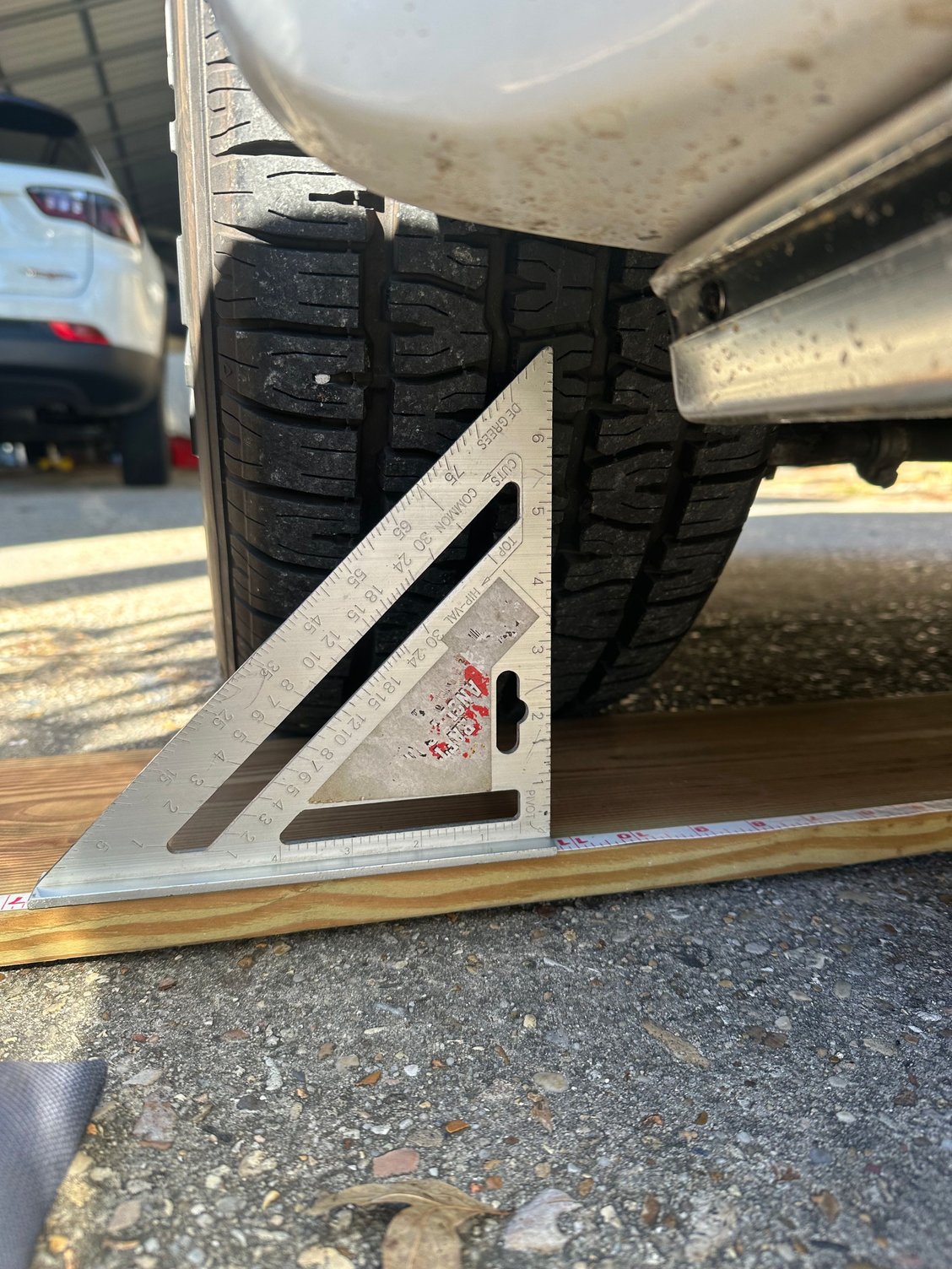

I made up a much simpler (and less precise) board similar to the Problem Solver video method using my 100’ tape, a 1x7 shelving board I had from another project, and a carpenter’s square.
I duct-taped the measuring tape to the farthest edge of the board, wedged the board under the tire, then took measurements up to the molding seam of my new tires on the front side, then the back side of the tire. I then calculated the distance between the seams and made adjustments accordingly.
Pretty low tech stuff. But I am a pretty low IQ guy.
I was able to reach under to each tie rod clamp without needing to jack. Took me four adjustments/test drives to get the targeted toe-in. Each adjustment, I could feel the difference in driving improvement as I got closer. I now sit at 1/16” Toe In. Feels great. No pulling.
