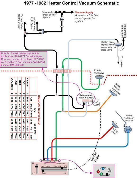

I'm a new buyer of a 79 corvette and with any older car, is has issues but I'm somewhat knowledgeable of older cars. The heater works and I can feel it but nothing comes out of the vents or the defogger vent. Is it just blocked off somewhere or is it the control panel

Pull the glove box out and see if you are getting a vacuum signal to the defrost actuator?

also see vacuum schematic

Most common issue. Vacuum switch breaks plastic rivet.

I got the heat to work!! Thanks for the advise and diagram, much appreciated!!
