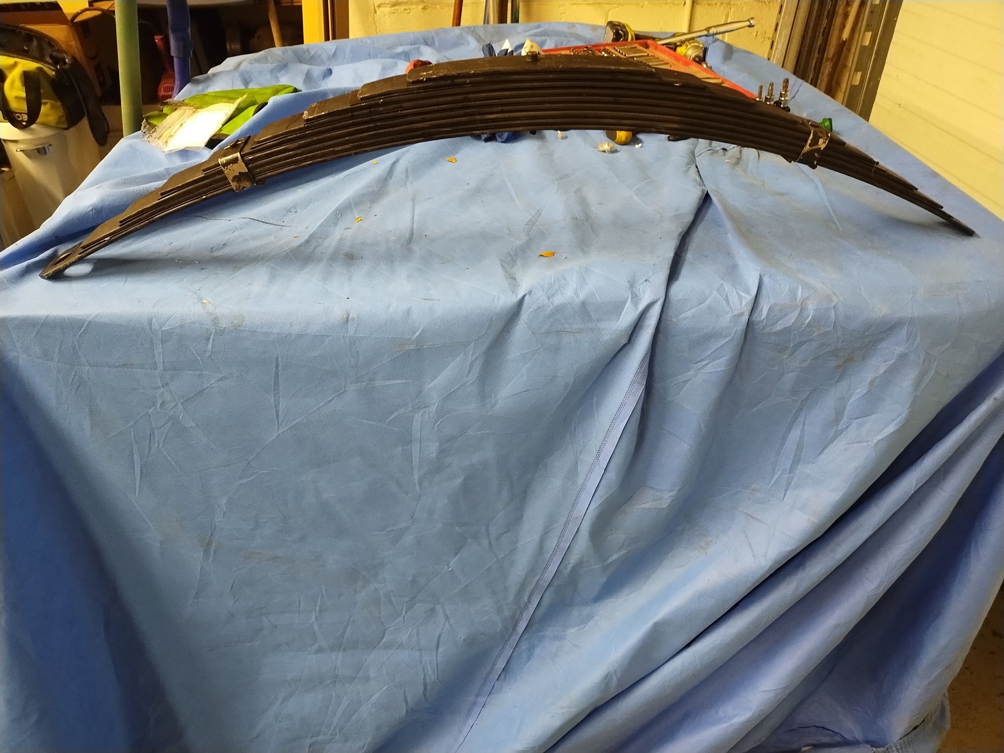

Anyone think it is time for a new leaf spring? The leafs are also shifted front to back. Yes I know other things need attention also.

If it is relatively flat end to end then it needs to be replaced, it has lost it's functionability. Monosprings are a good replacement for these; lighter; many different spring rates.

The tips of the bottom leaf look bent up. Replace with a composite spring, 8" bolts, and new shocks.

Yes,, time to replace it.
My vote is for mono spring.. I love mine, 330 rate with Bilstein HD. ( I think the current name is B8 )

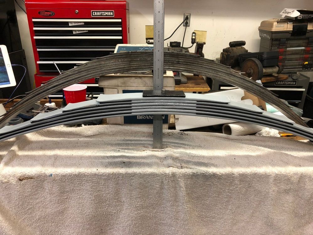

Yup, left side done.
I think anytime that the springs start to splay out a little bit. It’s probably time to get rid of it. I noticed it with two of my previous springs and then when I finally got a new steel spring, they don’t splay out anymore, but perfectly lined up.

Thanks for all the input. Going to go with a steel 9 leaf.

Got a delivery today. This proves you do not have to be good to get presents. Will take the shipping bands off before install.

The problem with ordering parts before disassembly is you always need more parts. Spring bolt cups for the trailing arms are shot so they have been ordered. The new spring is 7/16" thicker then the original so need new mounting bolts for the diff mount. At least the new shocks went in easily.
