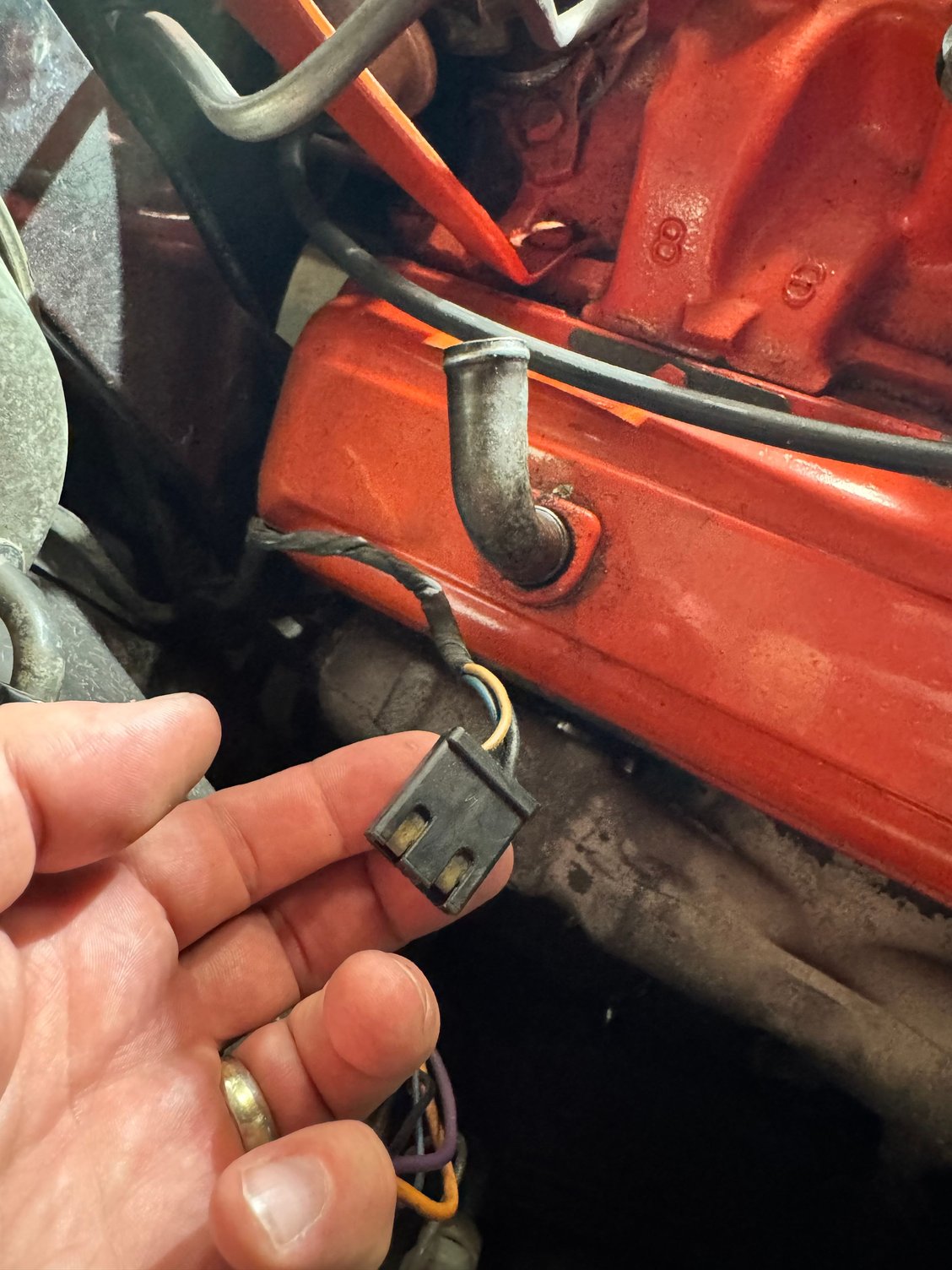

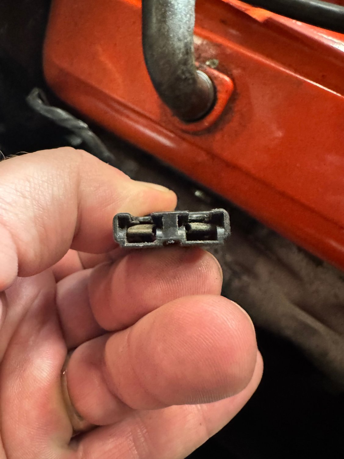

I was poking around in the engine bay of my ‘72 today and I found a connector without a home. It’s on the passenger side, coming up from the rear of the engine. Does anyone recognize it?

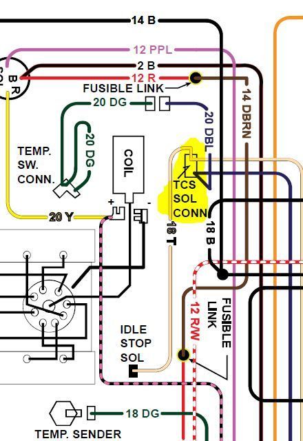

Transmission Controlled Spark solenoid, sits along the RH side of the carb, along side the choke.
Gary B

TCS control module connector as mentioned above
M

Had to look it up.
Transmission Controlled Spark Solenoid. An emissions-control system to prevent distributor vacuum advance at normal operating temperature until the transmission has shifted into high gear by using a transmission-mounted electric switch controlling a solenoid-actuated vacuum valve.
