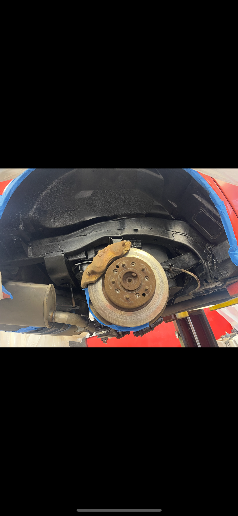

Here a picture of what it looks like after

I can only see 1 out 3 pictures
But the one pic results look amazing
