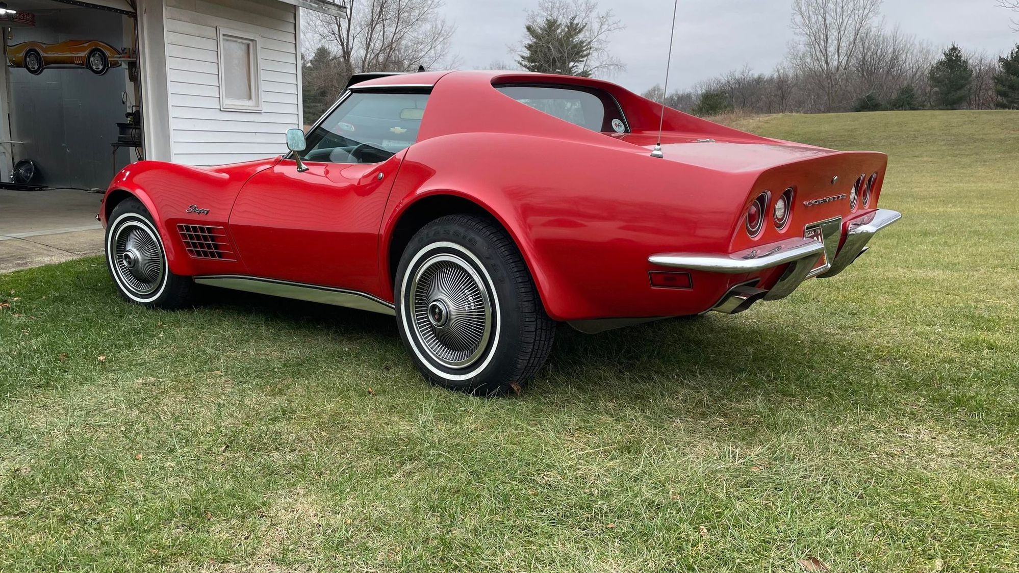

Just put these on a month ago.
255/60/15 on all four corners.
I've run that same size on 4 69-72 C3's

i went back with the original size a
nd white walls!!
