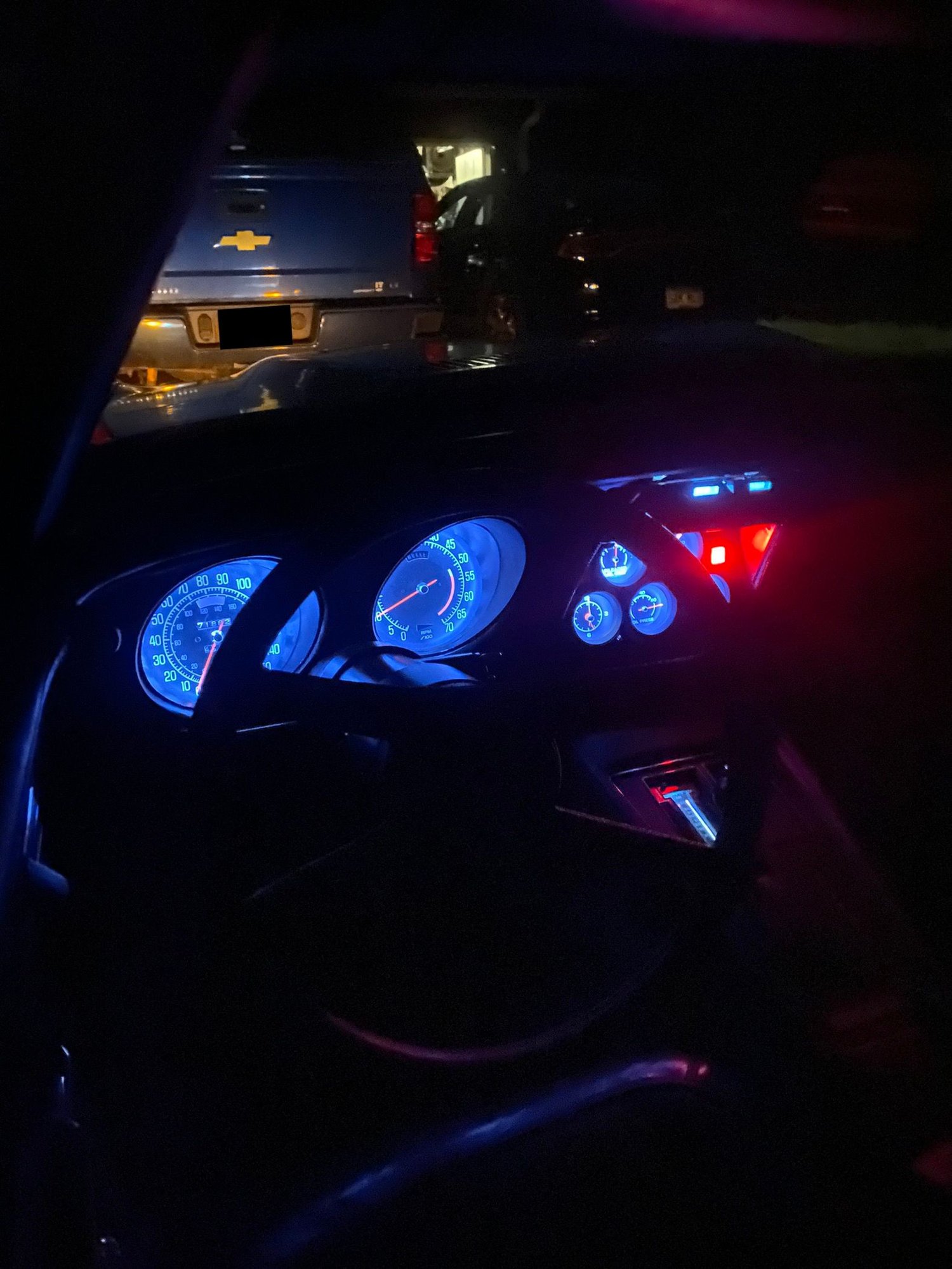

I see you already purchased bulbs, but if you do want to convert the dash bulbs to LEDs in the future I can send you an eBay link. $11.49 USD for a 20 pack. They fit in the stock connectors just fine, and almost two years later I have no issues.

@Piersonpie your dash looks great!
