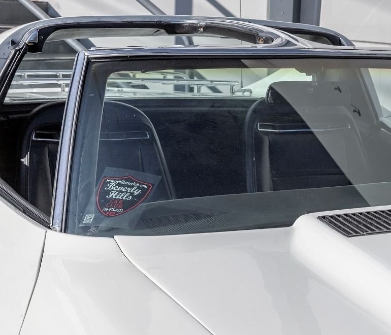

Pics of your hood and how it mates with the fender tops are probably in order.
The '72 fenders have trim to match the wiper door while the '73 with the long hood does not; i.e. the fenders are shaped differently.
1968-1972
1968-1972
1973-1982
1973-1982
