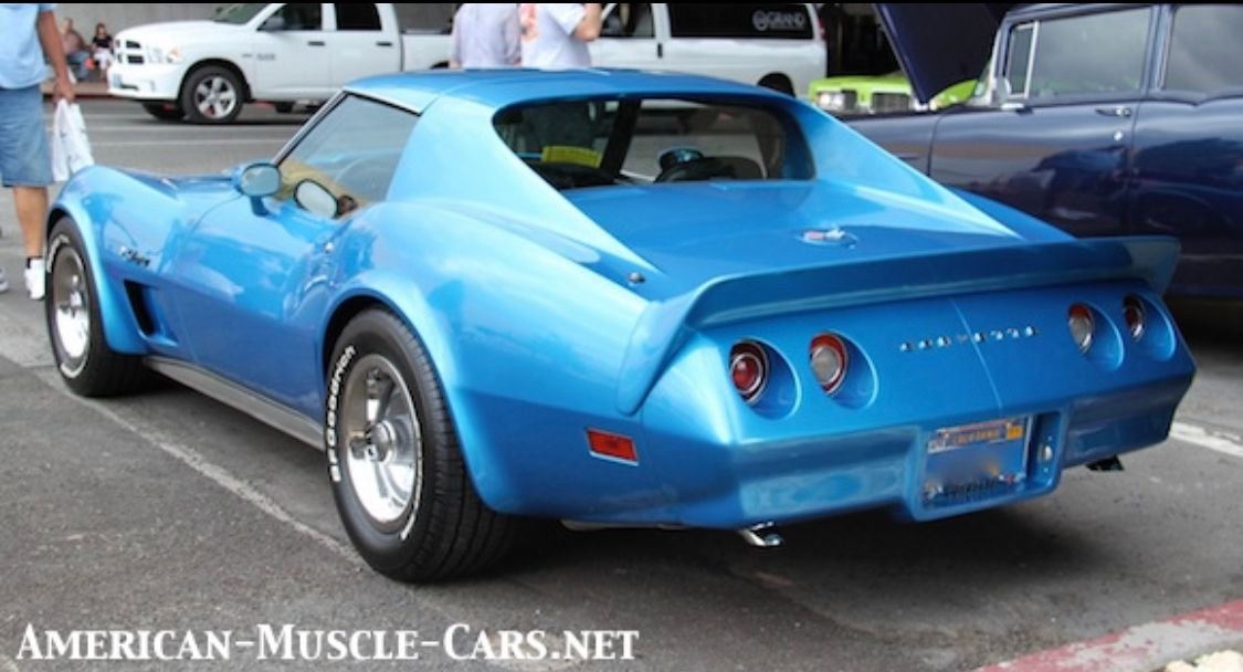

Both of the bumper covers on my 77 have been replaced. Up front a replacement urethane bumper cover , fit great but comes with the waves.
In the rear, which came a couple years later, a flex fit fibreglass cover. Unlike the gentleman above, I was advised that was the only way to go. No waves. Also fit nicely. I run a Indy pace car style rear spoiler. And have for many, many years. But I realise that particular spoiler isn't everyone's favorite.

Personally I like it! Looks very 70’s. It’s what I’ll be putting on my car in the future.

Looks very 70's. Yup that fairly well sums it up. I like it. This was one of the very first things I did to my car way back when. Long before the flex fibreglass bumper cover.
