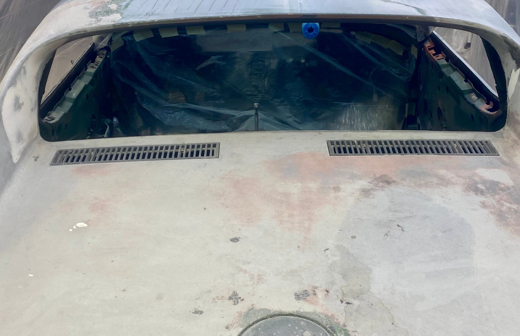

The obvious function to me would be to drain water from near the window. But was it such a problem that they required these massive drains to handle the water that wouldn’t pool unless you were parked downhill? On level ground water easily runs off since the panel has a few degrees of slope.

The Astro ventilation vents?
Old Dec 19, 2024 | 04:29 PM
Corey_68's Avatar
Corey_68
Joined: Feb 1999
Posts: 34,454
Likes: 665
From: Republic of Texas

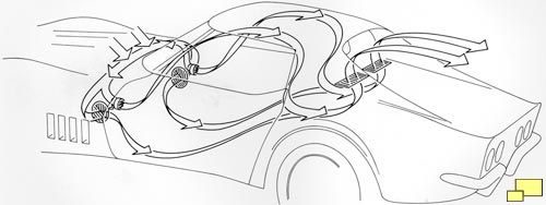

It's part of the Astro Ventilation System, they are functional on cars with Non-A/C option, A/C cars were blocked off.

Oh I see.
mine is an A/C car. So they don’t really do anything?

Anyone here ever glass over them?
make them disappear?

NO. But I did delete the rotted rubber baffles/filled the air holes with fiberglass patches/added 3/8" diameter aluminum drain tubes to keep the pockets from filling with water because I wanted the original look of the chrome bezels.

IF you don't have Air Conditioning then you would really appreciate the Astro-Ventilation! It is the only convertible car that doesn't have the buffeting inside when the windows are opened. The air moves through the car and is gone without any human intervention. That is a well designed cooling system as far as I am concerned.
I keep my Astro-Ventilation fully functional just to stay cooler in the summer. I have 427 cubic inches with absolutely no concern for my physical comfort. Just get up and GOOOOOO with a smile on my face.

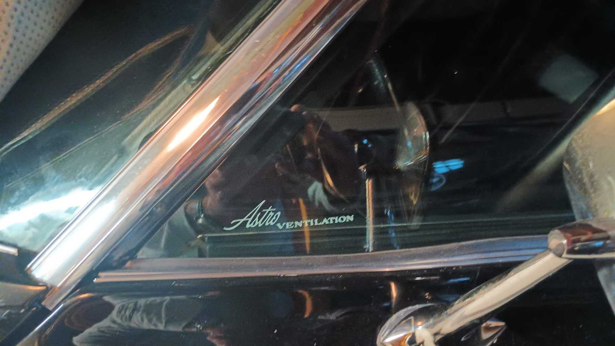

I have a 70 convertible with factory air conditioning. The side windows have what appears to be original “Astro Ventilation” on them.

All 1970's got the Astro Ventilation script on the windows regardless of AC or not.

My '69 AC convert has Astro Ventilation markings on the windows.

Yep, all '68-'75 C3s have Astro Ventilation on the windows, no matter if it was functioning or not.
