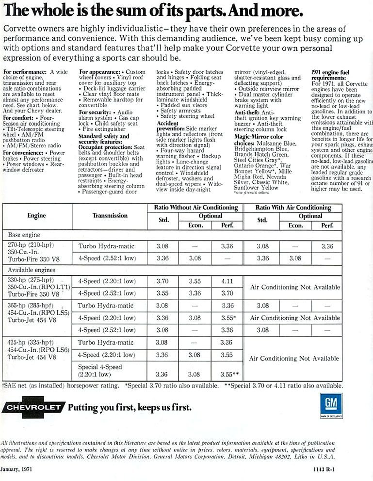

I’ve searched on this forum and I haven’t found an answer to this question. My ‘71 base small block, 4 speed, no ac car has a 3.36 posi. The code on the differential is LR. My question is:
Is this the standard ratio for this car, or was the 3.08 ratio standard and 3.36 was an option? There is a ZQ1 RPO code for ‘71, which is “optional axle ratio”.But I can’t find ant information on what ratio the option provided. Thx in advance for any info.

Thank you much. This answers my question

Base engine with m20 came with 336. LR is the code for 336 in '71
