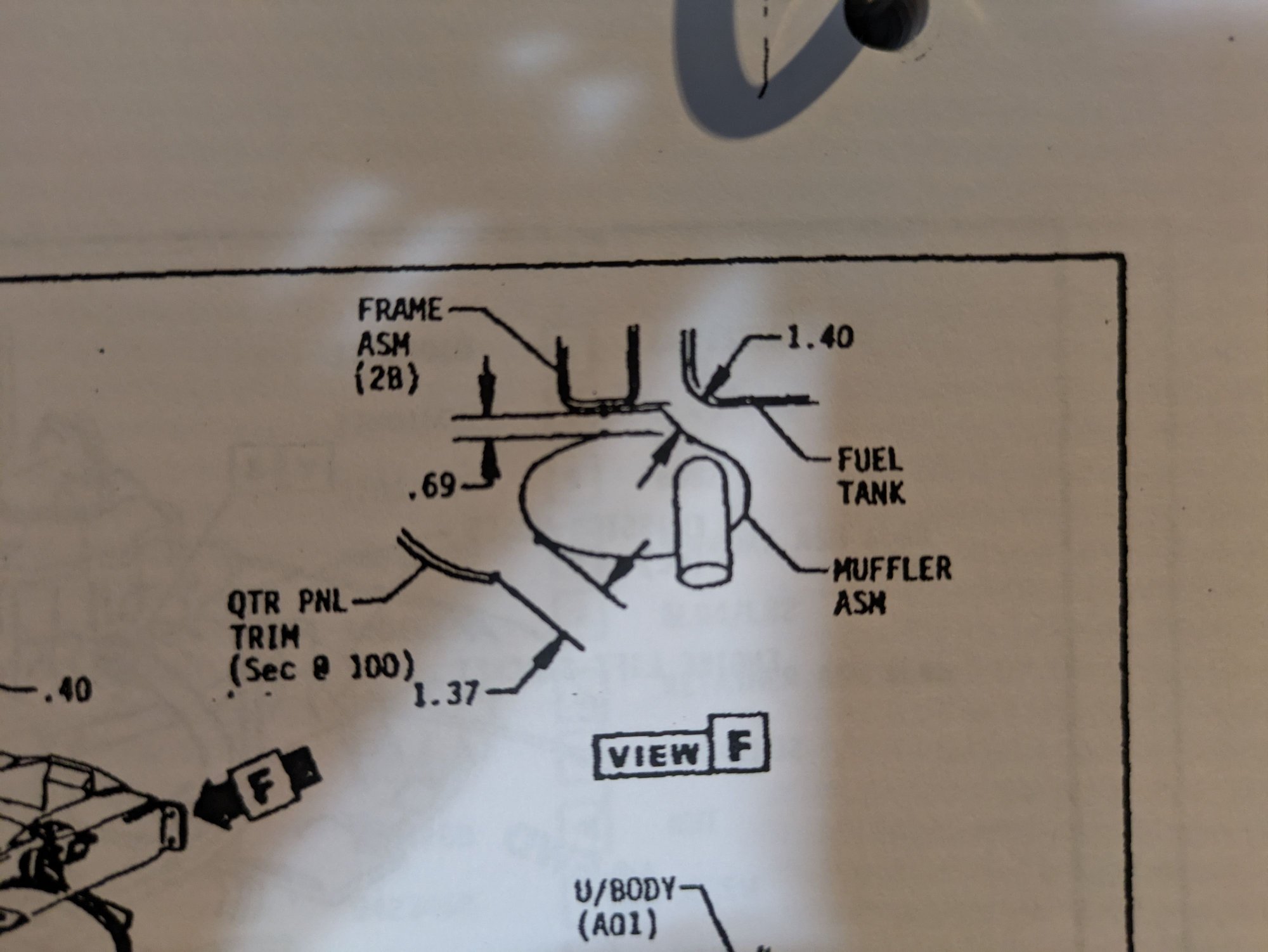

Thanks for all the confirmations. All of my newer vehicles have heat shielding above the mufflers at the rear so that's the reason I wanted to ask. Thanks for confirming there was no shielding from the factory. In addition to asking here, did some research and found the following drawing that also confirms no heat shield. Thought I'd post here as it also contains the minimum clearance for the muffler to other parts.
