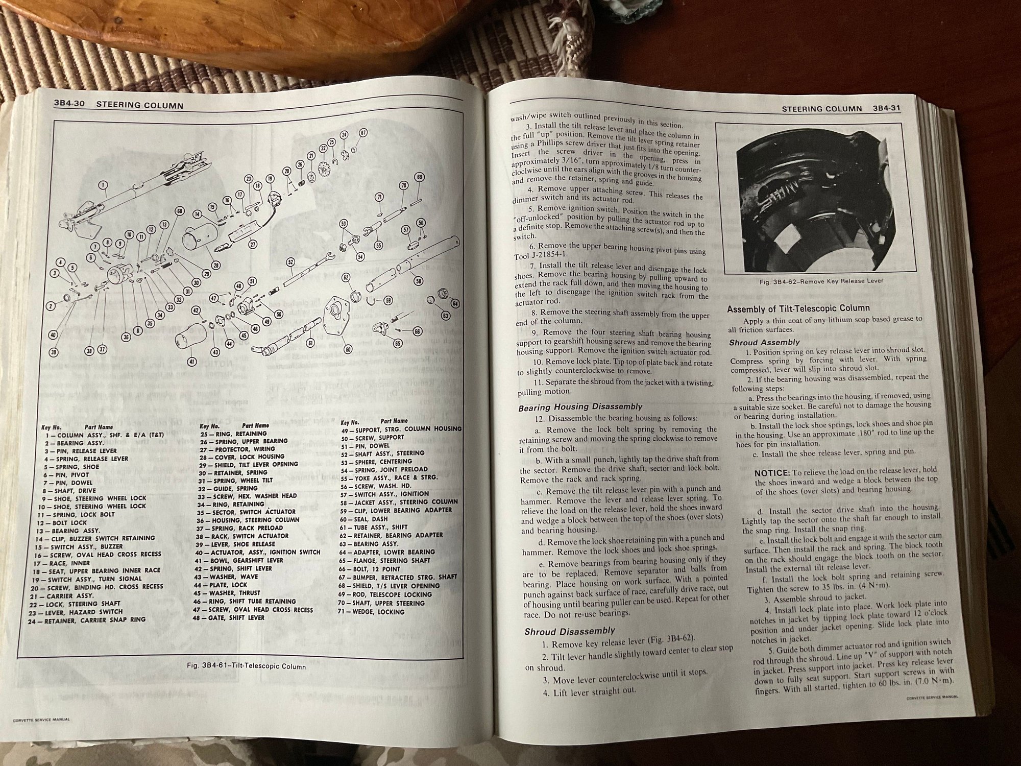

For a 78 I’d recommend a 79 manual; easier to read. Get an original on feebay. The steering column section is over 30 pages.
