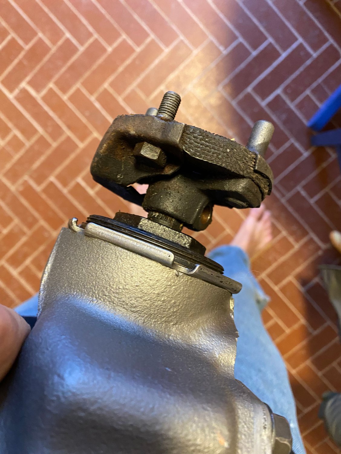

Anything you can see that I’m missing from these additional photos? It’s really stuck on there!
Old Jan 8, 2025 | 06:51 AM
CAMS69's Avatar
CAMS69
Joined: Apr 2012
Posts: 696
Likes: 193
From: USA
just smack the hell out of it.
Old Jan 8, 2025 | 07:45 AM
leadfoot4's Avatar
leadfoot4
Active Streak: 90 Days
Joined: May 2001
Posts: 87,357
Likes: 1,592
From: Western NY
Maybe slip a "pickle fork" between the box and the joint, and pry it off?
Old Jan 8, 2025 | 08:45 AM
GTR1999's Avatar
GTR1999
Joined: Aug 1999
Posts: 15,173
Likes: 3,982
From: Connecticut, USA
With the pinch bolt out just drive it off
Old Jan 8, 2025 | 10:41 AM
doorgunner's Avatar
doorgunner
2026 Loser of the Year
Posts: 36,595
Likes: 7,042
From: New Or-leens Loo-z-anna
"Anything you can see that I’m missing from these additional photos? It’s really stuck on there!"
My rag joint was much worse...the flexible material was swollen and separating PLUS the splines were rusted together like yours.
Put everyone's suggestions together...
ALSO add a little heat to the coupling where the pinchbolt fits using a handheld propane torch.
Old Jan 8, 2025 | 11:41 AM
Mark G's Avatar
Mark G
Joined: Jul 2005
Posts: 3,694
Likes: 833
From: WI
Grind a blunt piece of steel slightly thicker than the gap (file the tip of the steel at an angle) to drive in there and lightly spread it open. It doesn't need to open much..barely (because It's cast steel). And then try to back it off. You might try a 2-jaw puller with a small nut fit into the shaft area (if the puller-screw is tapered...like most of them are).
Old Jan 8, 2025 | 11:46 AM
Mark G's Avatar
Mark G
Joined: Jul 2005
Posts: 3,694
Likes: 833
From: WI
BTW ....Don't add any heat (you could take the temper out of the shaft) ...and I wouldn't recommend a pickle fork unless absolutely necessary. It'll just flat-spot the bearings. Try a puller first. That ought to do it. You can buy a cheap one at HF. Orr get one of THESE front end kits...they have nice pullers in them.
What's the status of the steering box? Are you going to have it rebuilt? If it's an old box I personally wouldn't put it back in unless it were recently inspected/redone.
Old Jan 8, 2025 | 01:09 PM
ctmccloskey's Avatar
ctmccloskey
Joined: May 2001
Posts: 4,757
Likes: 1,647
From: Fairfax Virginia
The amount of heat needed to help the oil be drawn into the joint should not come close to removing the temper of the steel. If you want oil to be drawn into the corroded joint the heat needs to be applied directly to the part itself and you don't even need a gas torch. A good hot air gun will do the same job without any flames. If you get the part so hot that the parts start to change color, then you have likely ruined the parts and removed the temper of the steel.
Steering boxes can be rebuilt but like other important parts be sure to find the best person to do it for you. I had mine rebuilt by Van Steel back in the 1990's. It was not much better so I went with a Steeroids Power Rack and Pinion system and it is great.
A good deadhead hammer might be useful.
Old Jan 8, 2025 | 02:19 PM
Mark G's Avatar
Mark G
Joined: Jul 2005
Posts: 3,694
Likes: 833
From: WI
I'm 95% sure Autozone and OReilly both rent out (for free) a 'front end service kit. You could rent that and use the pullers to remove the joint. Just put a 5/16" nut or whatever fits best on the shaft if the puller screw doesn't match up well. Those long pullers are pretty robust.
Try that.
Old Jan 8, 2025 | 04:32 PM
scuderia_kannan's Avatar
scuderia_kannan
Joined: Oct 2024
Posts: 80
Likes: 22
Winner! Pickle fork did it, and I didn’t need to hammer it so not worried about the bearings. Thank you all so much!
