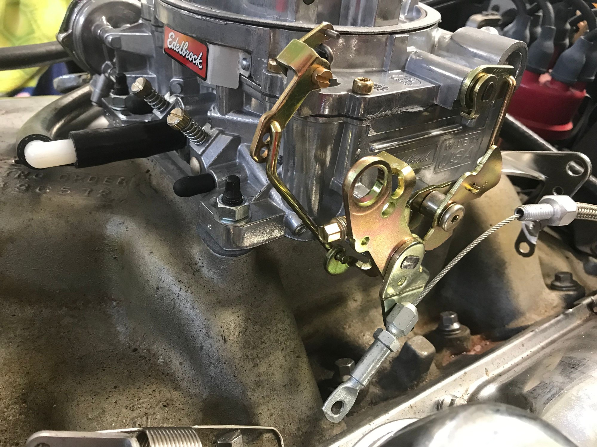

I am trying to convert from a double pumper Holley carb to a more street friendly Edelbrock. I did not install the cable, but it appears to be an aftermarket such as probably a Lokar? The mounting bracket
is a Lokar and is meant to go with this carb according to Summit. Will this cable work and how do I go about fitting it thru the hole in the bracket?

I had to cut a notch into the bracket hole just wide enough for the steel cable to fit into. Then I put the retainer clip onto the cable housing to hold it in place.
I also bent the bracket just enough to have a straight line to the carb pivot arm.

I found a set screw that releases the end parts. Now I need a jam nut to put on the threaded end to trap it on the bracket. Problem is I am having no luck figuring out what size jam nut. I have tried a 5/16-18, 5/16-24 and even an 8mm. Al will start but quickly hang up. I can chase it out with a die but I need to know what the thread is before I ruin it. Anyone have a Mr. Gasket 5657 Universal Throttle Cable to check that thread for me?

do you have a tape and die set. THere sould be a thread gauge in there to give you the correct pitch, then measure the diameter....

For the record it looks like it is an M8x1.25. Mystery solved,
