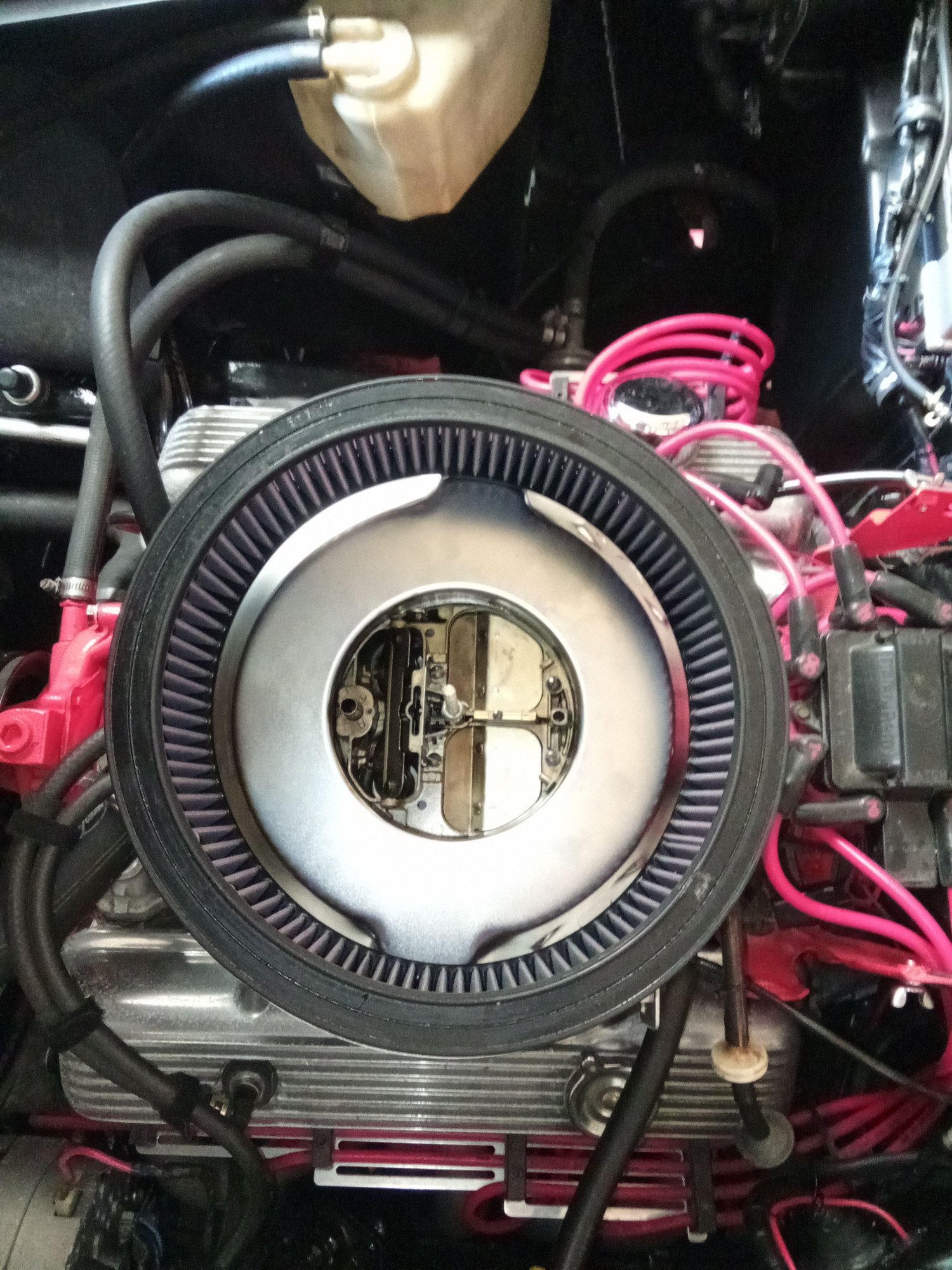

Hi everyone
About a week ago I bought a new K&N filter to replace the paper one that was on the carb.
I received the filter, but the moment I checked it didn't fit... far from...
It was the E-1500, but it's way too small. I think this was meant for the 1973-1976 with the cowl induction system.
https://www.summitracing.com/parts/k...eIlurxHx6KM4h-
I https://www.summitracing.com/parts/k...eIlurxHx6KM4h-
I searched the Summit website again and it seemùs the right one should be:
E-1650
https://www.summitracing.com/parts/k...make/chevrolet
Just to be sure. Can anyone confirm if this is the right filter for the 14" Proform chrome open element?

From: Shamong, NJ
The K&N E-1650 is the correct replacement element for the stock 65-72 Corvette 14" open element air cleaner, the original Delco number was A212C. The air cleaner on the engine pictured is an aftermarket part, not an OEM Chevrolet unit so I can't say for sure if the K&N E-1650 element will work on it, but if it helps I believe the dimensions of the E-1650 are 12" ID, 14" OD & 3" height.
