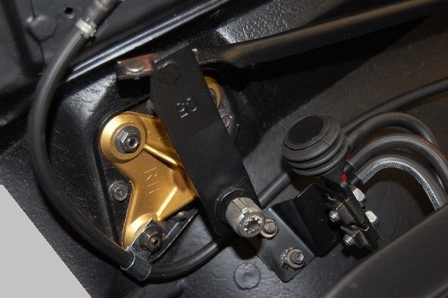

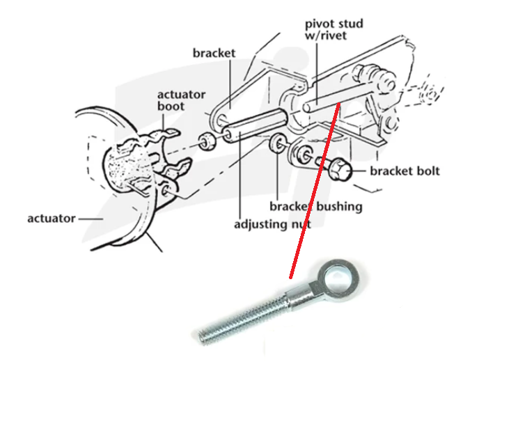

The threaded rod to the actuator- is 1/4-20 on the 68 and 5/16-18 on 69-72
And the 68 does not use a vacuum switch underneath the wiper arm.

The most important issue with any of these doors operating properly is that the original treads machined into the door for the attaching {linkage] bolts have not been damaged. If they have been, they cannot just be redrilled and tapped. The alignment of these installed screws MUST be precisely correct for the door to operate properly.
