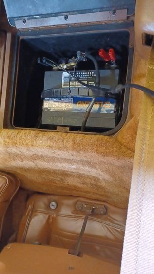

I used those clamps for years, ran the tender wire in the window and left it on the floor. This year I I installed one of those blade type disconnects on the negative terminal and hard wired a tender extension wire with loop connectors, it's long enough to come out the window when it's almost all the way up... I was a little concerned those clamps would fall off of those little terminal bolts..

I always figured a guy could leave a Tender extension cable hooked up to the batt terminals permanently. Then coil it up and leave it in the batt compartment with door closed all summer anyway.
But that would require finding a round tuit.
So, for now, compartment door open all winter, alligator clips, cable across to passenger window, down a smidge, over to wall outlet with timer.

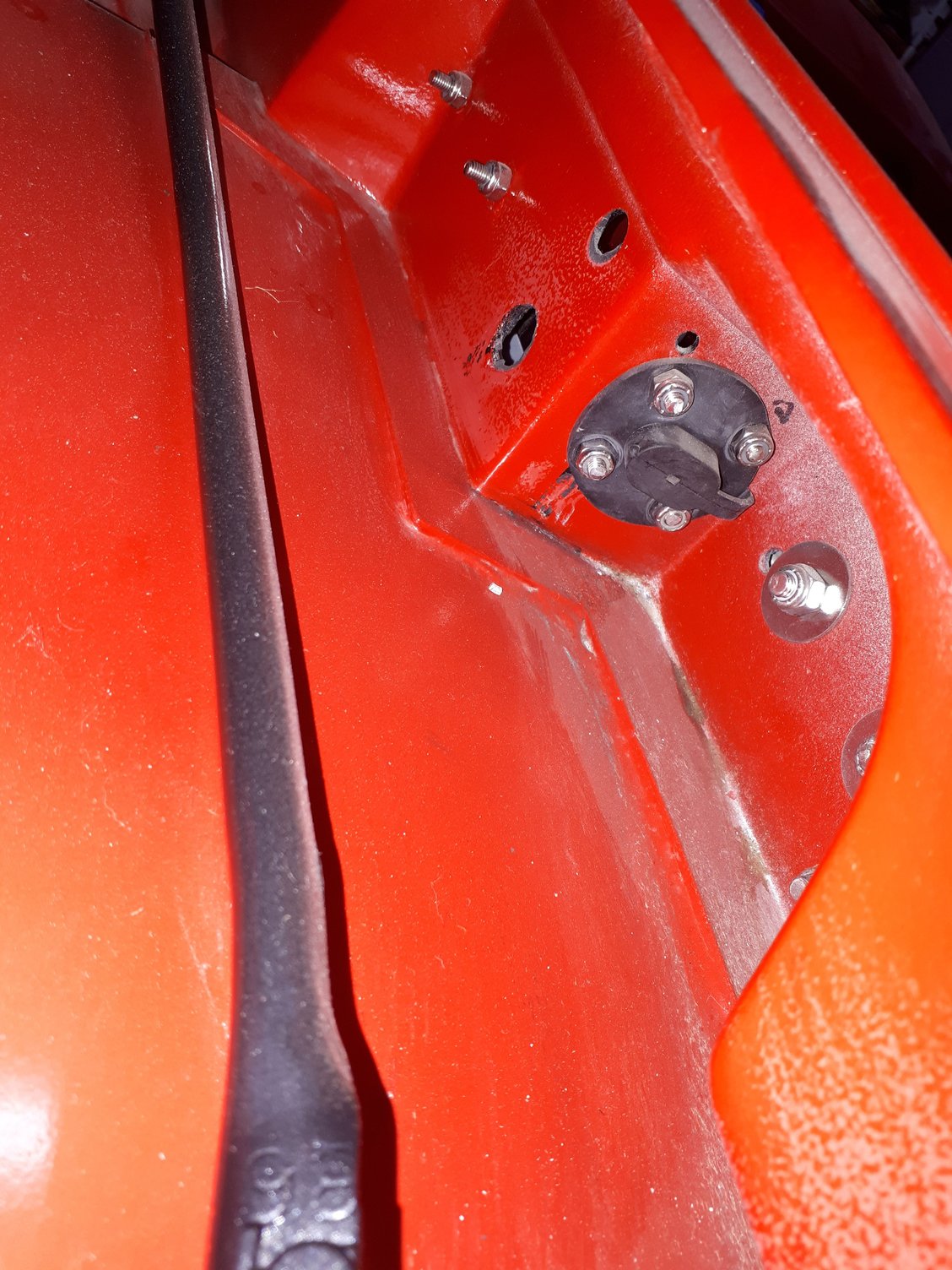

I installed a weather proof conector in the wiper tray. The connector is from a rv store and is the same as the battery tender connector. It is fused and hardwired into the car electrical system under the hood.

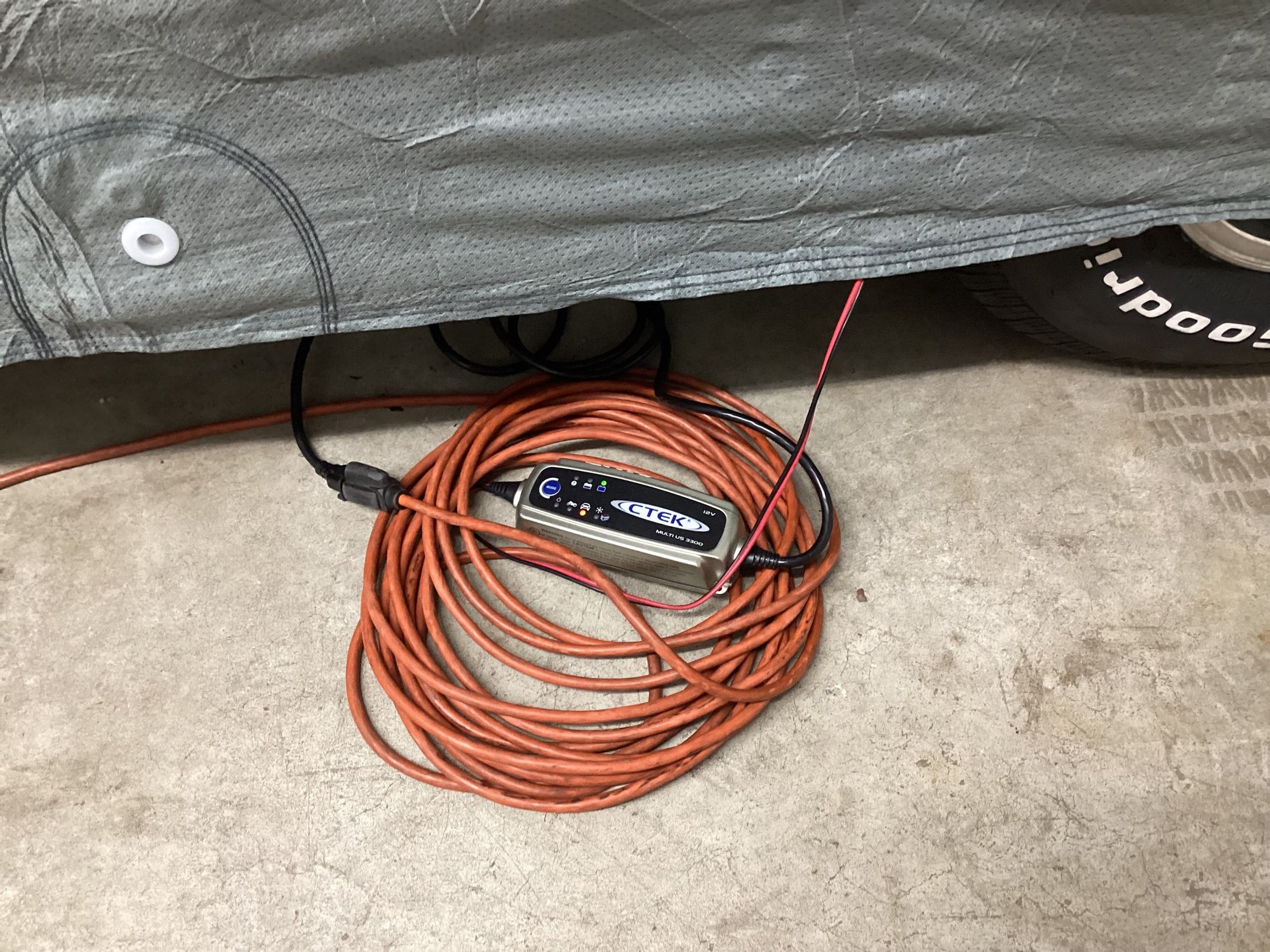

Going on 10 years with this hookup. It works just fine.

same thing I do with my 72 WBY coupe. Probably 20 years now. One tender died after a power spike in a storm, otherwise clamp, plug it in, and check it once in a while.

I put the clamps on the battery terminals, body of charger outside drivers door, cord bottom rear corner of door, close the door. Been doing it that way for 15 years.

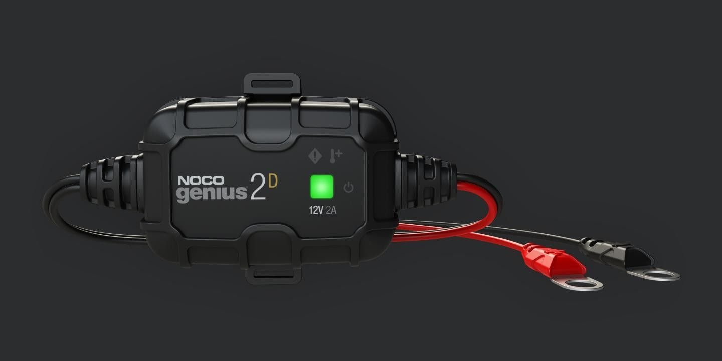

NOCO Genius 2D
