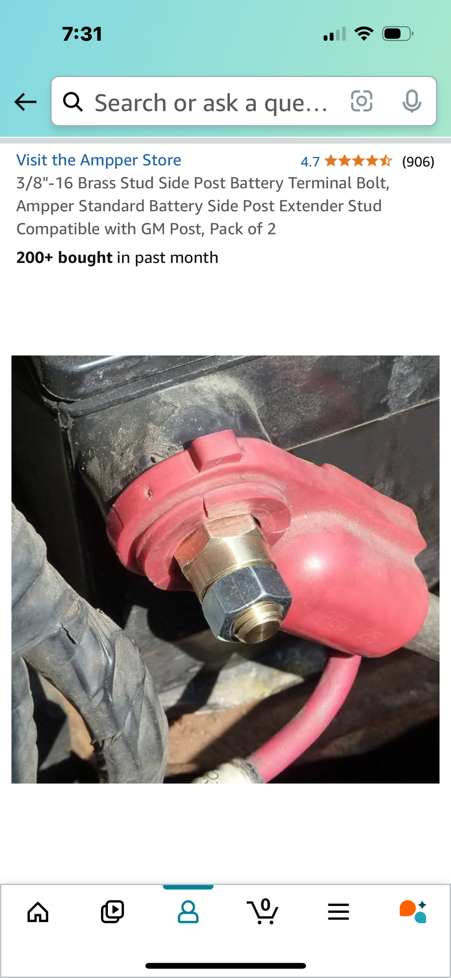

Extra nut on battery clamp bolts for ring lugs which are hooked to a mating connector cable for the charger. Charger plugged into wall on passenger side.
