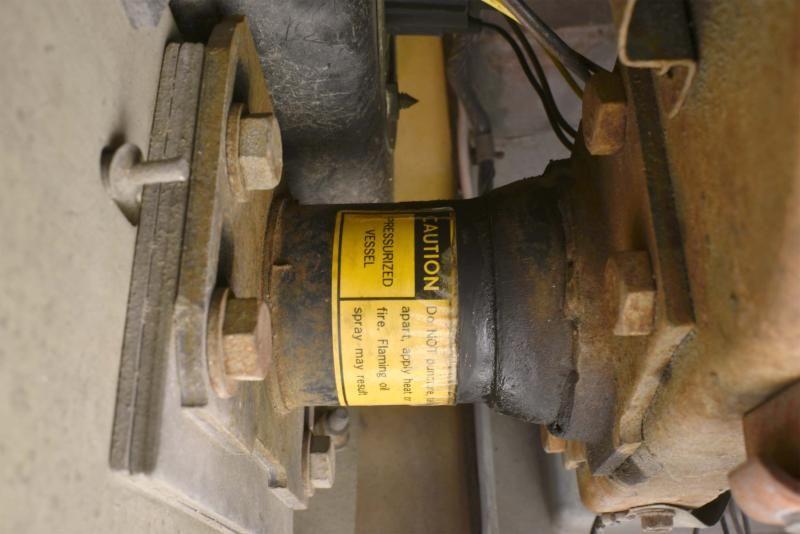

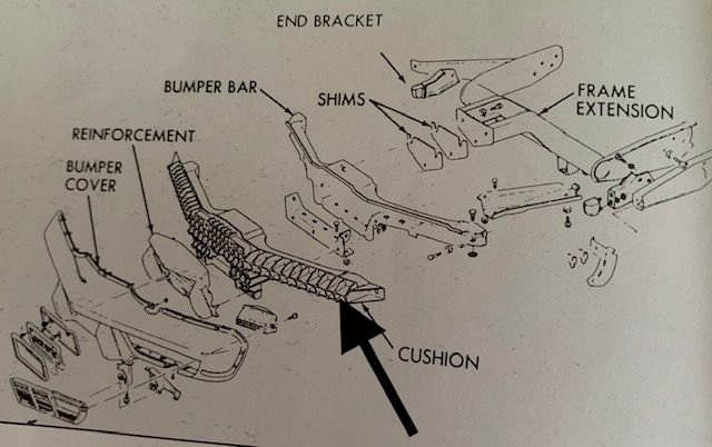

Just to clarify, in 1973 the body mounts were all the rubber cushion type. 1972 was the last year for the metal spacers. In my opinion using the 73 frame on a 74 would be much more manageable with a few modifications to the rear I guess as the one gentleman below remarked. However, like you I'm not sure it would be quite so easy to use on the '75 without a great deal of modifications. Even though we did discuss the differences in the front and rear bumper systems on the 73-74 vs. 75-77 in our TIM&JG revisions, I can't really say that it would help answer the OP's question. Going from the more rigid Omark Bolt systems of the 73-74 to the shock absorber/cushion type starting in 75 might be more challenging. JMO!
Again, like you said...anything is possible.
First photo below is the '73 - '82 Rubber body mount cushions.
Here are some more different images I thought I'd share for Green LT1. good luck with your project if you decide to proceed, please share your progress. Thanks! 73 Rubber Body Mount Cushions
72 and earlier C3 Body Mounts. Metal spacer used.
75 and later C3 shock absorber system
75 and later C3 rear shock absorber system
73-74 front bumper syster
75 front bumper system! The cushion replaced the omark bolts to absorb the 5mph impact.
