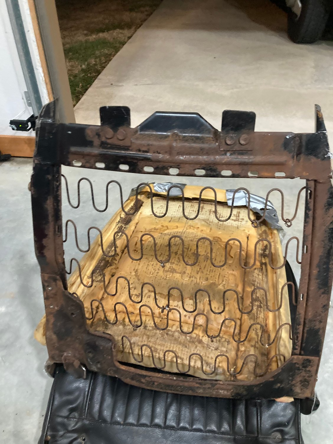

Hi All!
can someone please help identify my seat frames?
I have an early 68 coupe. I am in the process of going through the interior and restoring most of it. I’m at the point in the process of taking out the seats to have them re-covered . I am pretty familiar with the differences in the C3 years as far as as the interior and the seats.
But I am completely stumped on my seats for the most part. They seem to be early 68 with the low latch release.(latches are missing) a previous owner had really done a horrible job of putting covers on the seats.
After removing the covers from the backs, I’m completely confused now because it seems like the entire top of the frame is missing.
Can someone help me identify the frames because now I’m wondering if they had put some type of seat in the car, other than a Corvette seat or did someone for some reason, chopped the tops off?
As they are right now, no aftermarket seat cover would fit because it seems like the top of the seat frame is missing. Thanks!
Seat frames from my 68

I do have an assembly manual, but just like with searching for new replacement frames or even refurbished replacement frames period, mine don’t seem to look like the ones in the diagrams or like the replacement frames, which is why I am so confused. They look like somebody either chopped off the top of them or they are seats from some other GM car that pretty much fit so somebody just stuck them in there. They are missing at least 6 to 8 inches off of the top, so no existing replacement foams or seat covers would work. If I want to try to keep the seats because they are original, I’m looking at a complete custom job, which is more than I’ve spent on the entire interior. And I’m still not convinced that I wouldn’t be wasting my money and time custom covering some seat frames that somebody had butchered through the years.

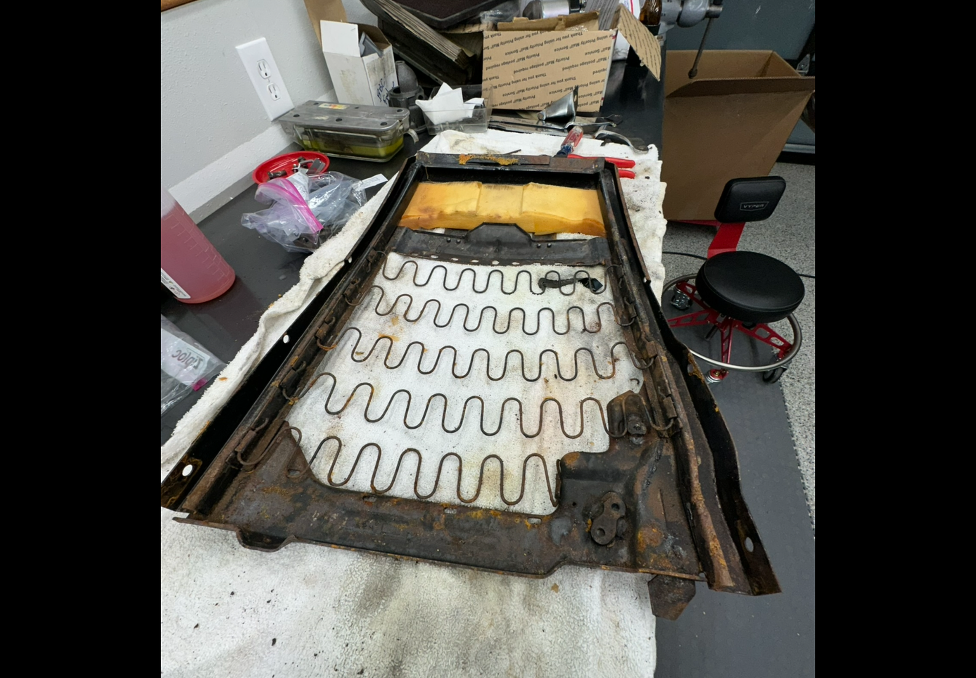

Here is a picture with measurements of my 1968 lower release version seat on the back. Tape is held at the bottom edge of the shell. No idea if they are original to the car but appear to be.
1968 Seat back measurement.

Redvette2 thanks! yes exactly! But if you look at mine, exactly where the plastic back should end at the top, mine have no more frame above it, where the remaining few inches of vinyl/leather should be.. it’s very strange. And they don’t seem to be cut and grinded off unless it was so long ago it’s all rusted evenly.
it’s a real annoying mystery. I’ve looked into every replacement cover imaginable that shows the measurements and mine are definitely missing a few inches on the top. I was hoping I’d discover they we’re actually c2 seats or some other GM car, but I can’t find any pictures with exact matches

Hard to tell with the tape and foam on it. Take all thet off and take more pics. There is no reason to cut the top off....none at all

Yep...does look to be a lot shorter. If not cut off perhaps an earlier year seat model.

If you can take off the foam carefully and send a pic of the top portion
What is the serial number of your car??
Black interior??
Thanks, Grant

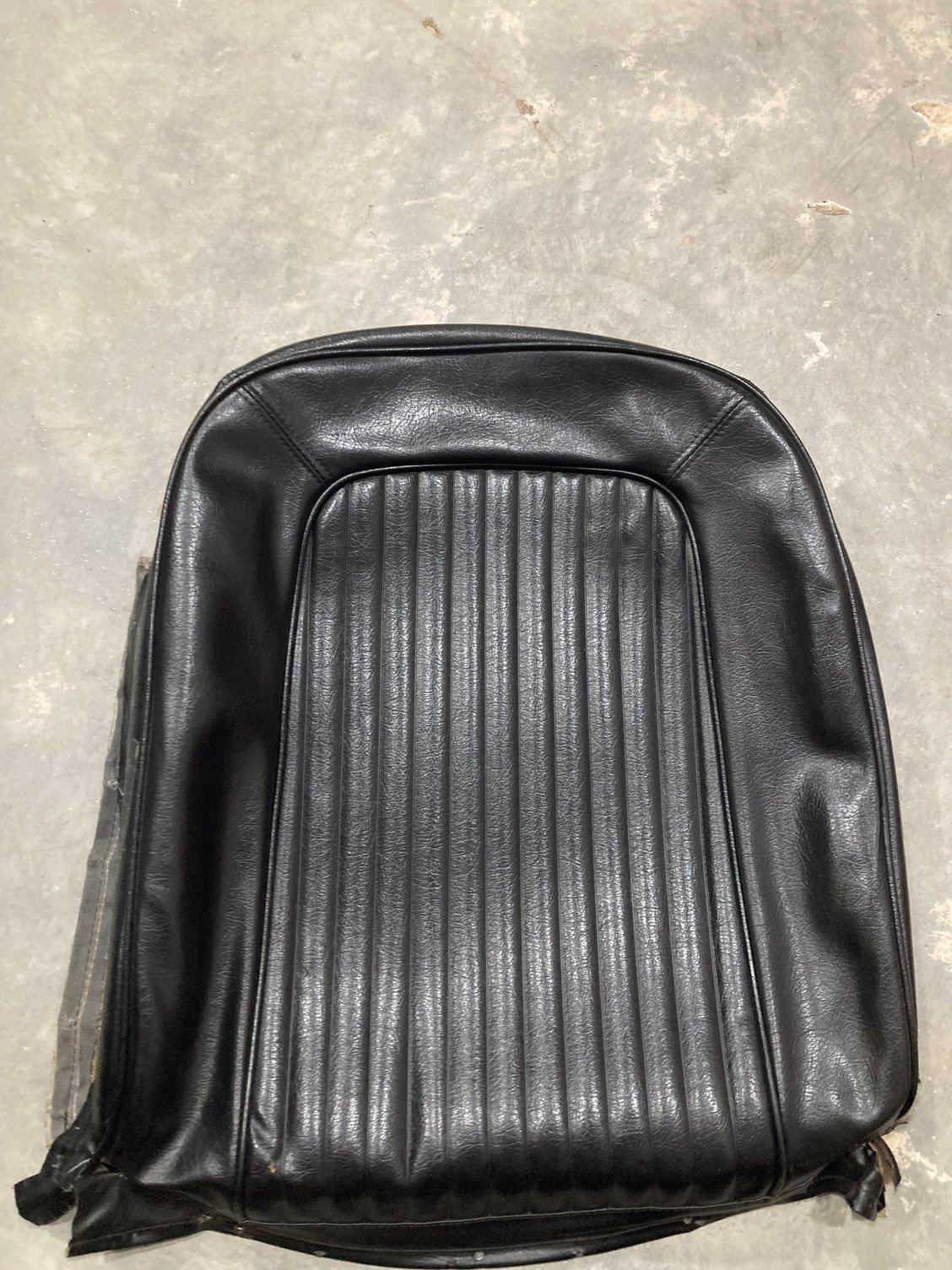

Here is my 68 back that I just recovered….

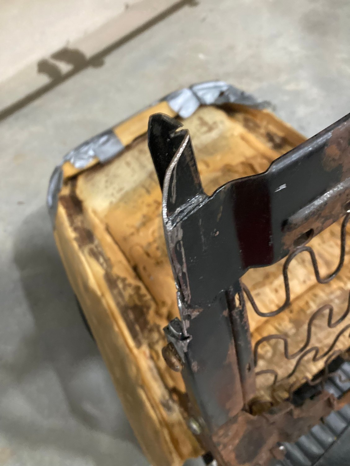

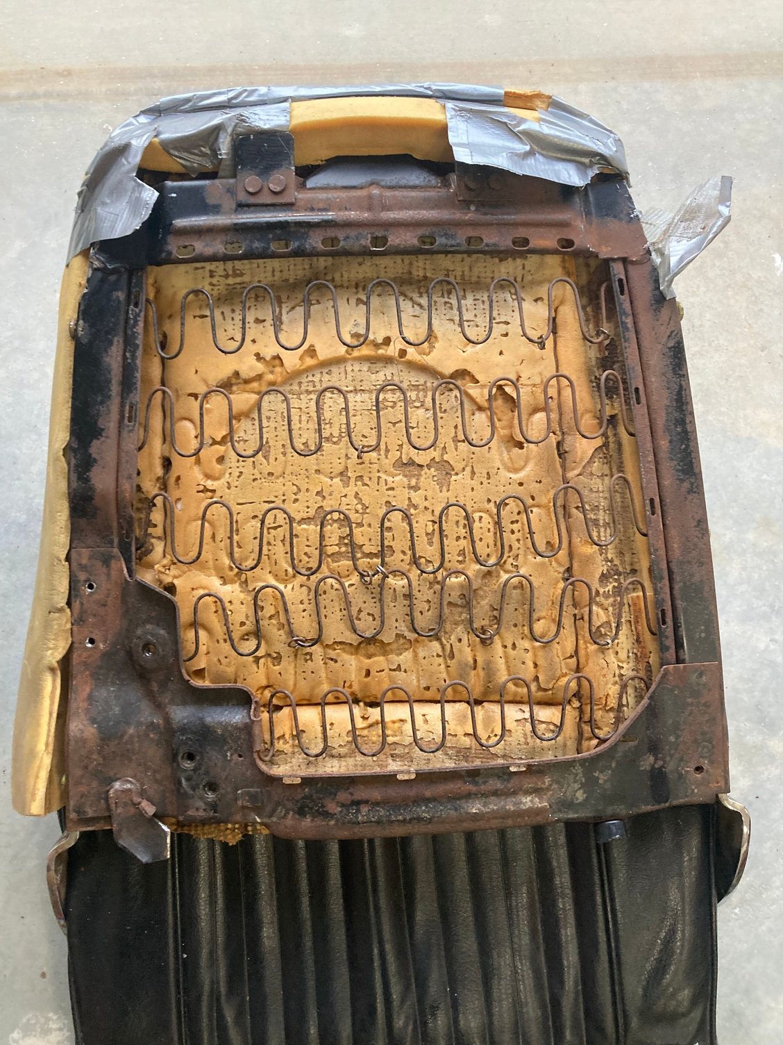

Well, the mystery is over as far as what the seats are. They are definitely original early 1968 seats that some previous owner decided to grind off the tops of the backs and put covers on them from a 1964. (See pics) I can’t for the life of me understand why anybody would have done that but, it shows me the direction I need to go, which is basically get replacement back frames with new foam and covers. I would love to get a hold of whatever owner that was through the years and ask them why in the world they would do that?
Thanks for the help

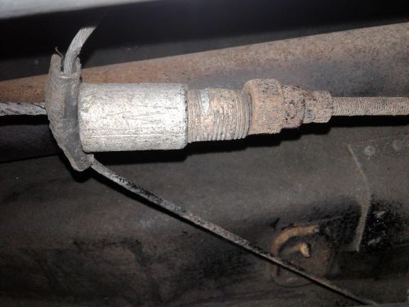

Welcome to the world of Corvette Bubba! Now you won't be ever surprised at what other weird things Bubba has done to our cars. Here is how Bubba tried to fix the parking brake on my car.
Bubba Cable Tension Fix
