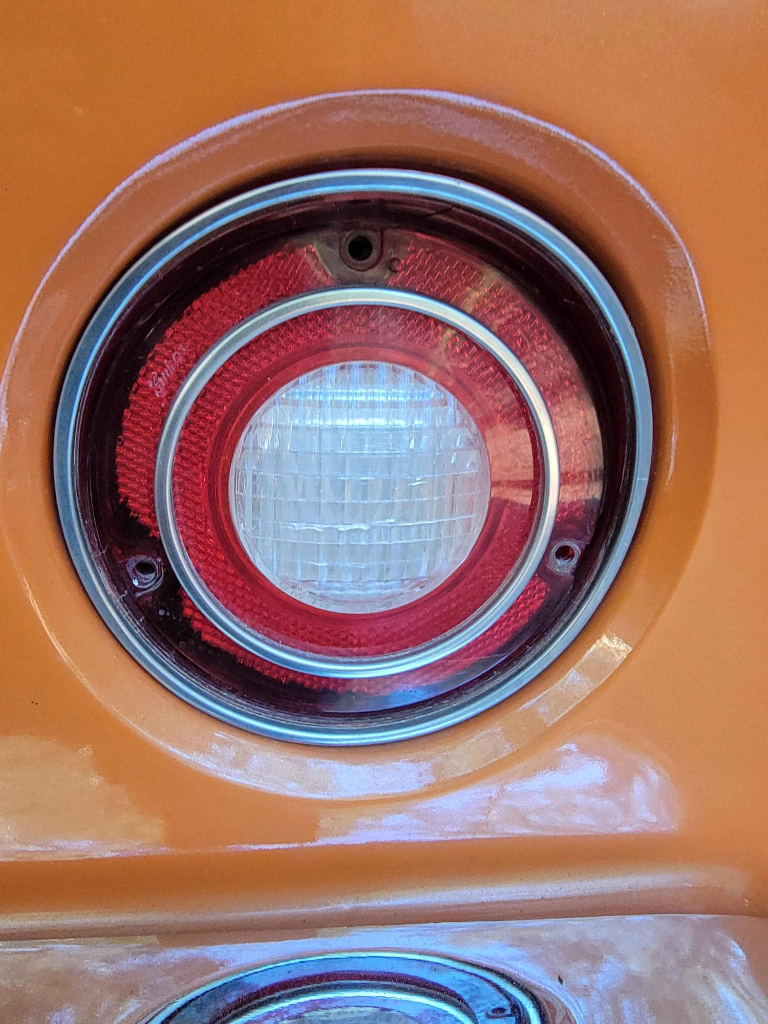

I need to replace a back-up light bulb on my 73. I removed all three of the screws from the lens, pulled and pulled on the lens, and the light did not budge. What am I doing wrong?

Nothing that I see. Did you try to gently pry it out?. There is a gasket that may be holding it tight.

The lens is stuck to the gasket. As mentioned, pry carefully.
Before installing the lens again, use some clear silicon grease on the gasket.

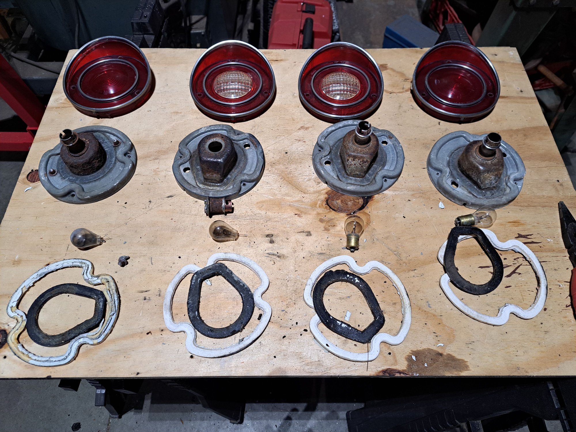

I used one of the narrow plastic trim removal tools to pry my lenses off... started at the top and slowly worked my way around to clear the white gasket in the pic below.

You did a SUPER job of removing them and saving the original seals. If you can find quality replacement seals, that would be best. If not, and the original seals are still pliable, reuse them. If there are any cracks or minor tears in them that might allow water to enter the lamp, use a dab of silicone sealant to patch or re-join as needed and allow to cure before installation.
