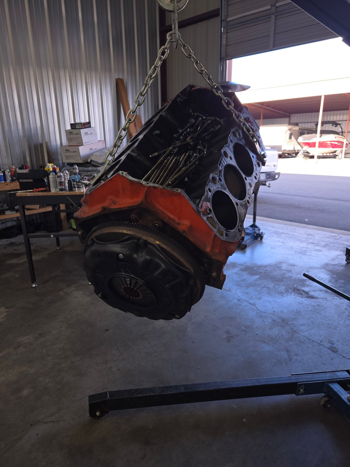

Old Feb 14, 2025 | 07:15 AM
Jeff's 1971's Avatar
Jeff's 1971
Joined: Jan 2024
Posts: 93
Likes: 7
From: Granbury, TX

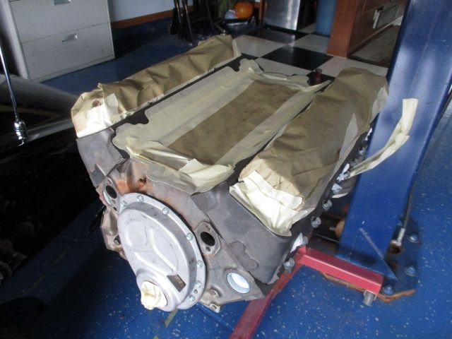

Engine pulled and off the the machine shop.

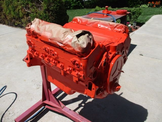

Originally Posted by Piersonpie
I would email Lars and ask for a copy of his paint papers.
v8fastcars@msn.com

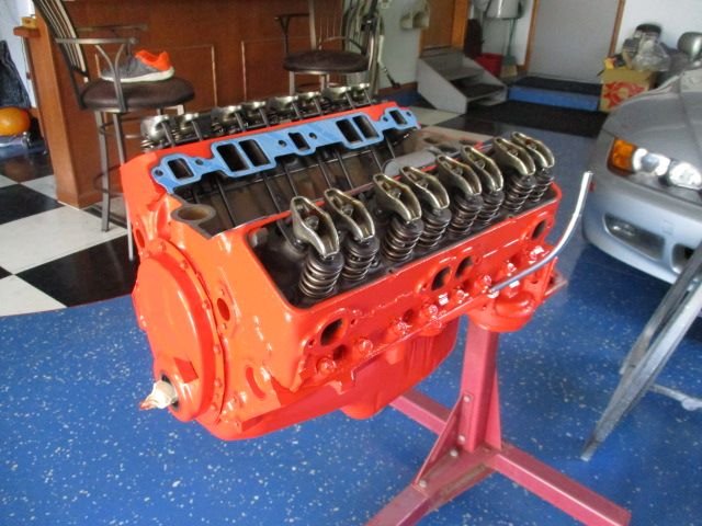

Here is what an engine looks like painted the way I suggest in my paint paper:
Not quite up to NCRS standards, but I do a lot of things that they don't like...
Lars
Old Feb 21, 2025 | 06:59 AM
Jeff's 1971
Joined: Jan 2024
Posts: 93
Likes: 7
From: Granbury, TX
Lars
Looks great!!!
