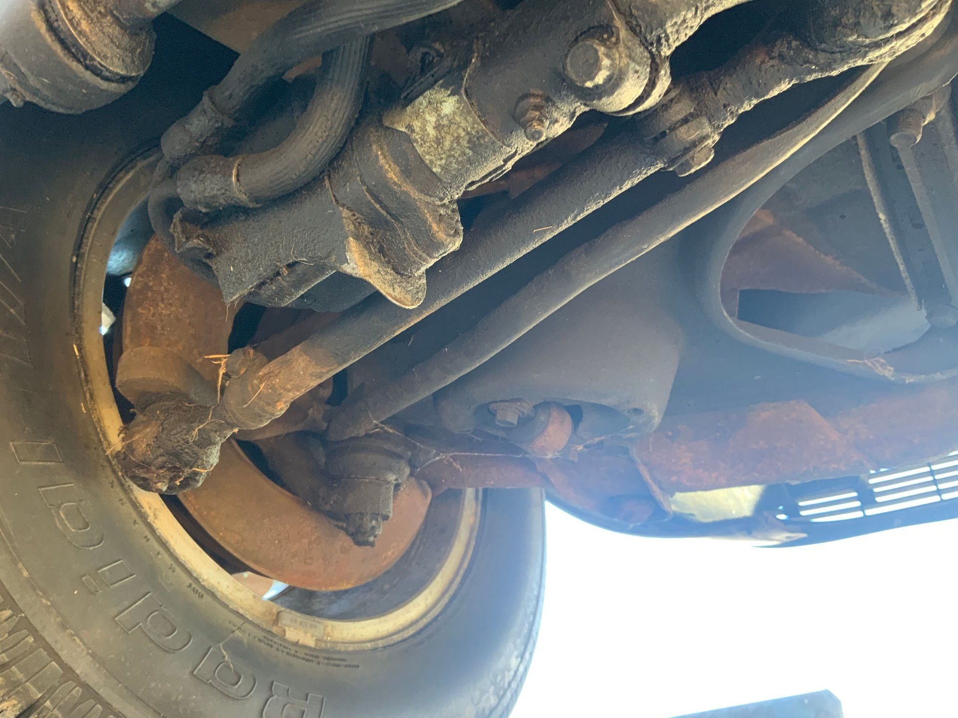

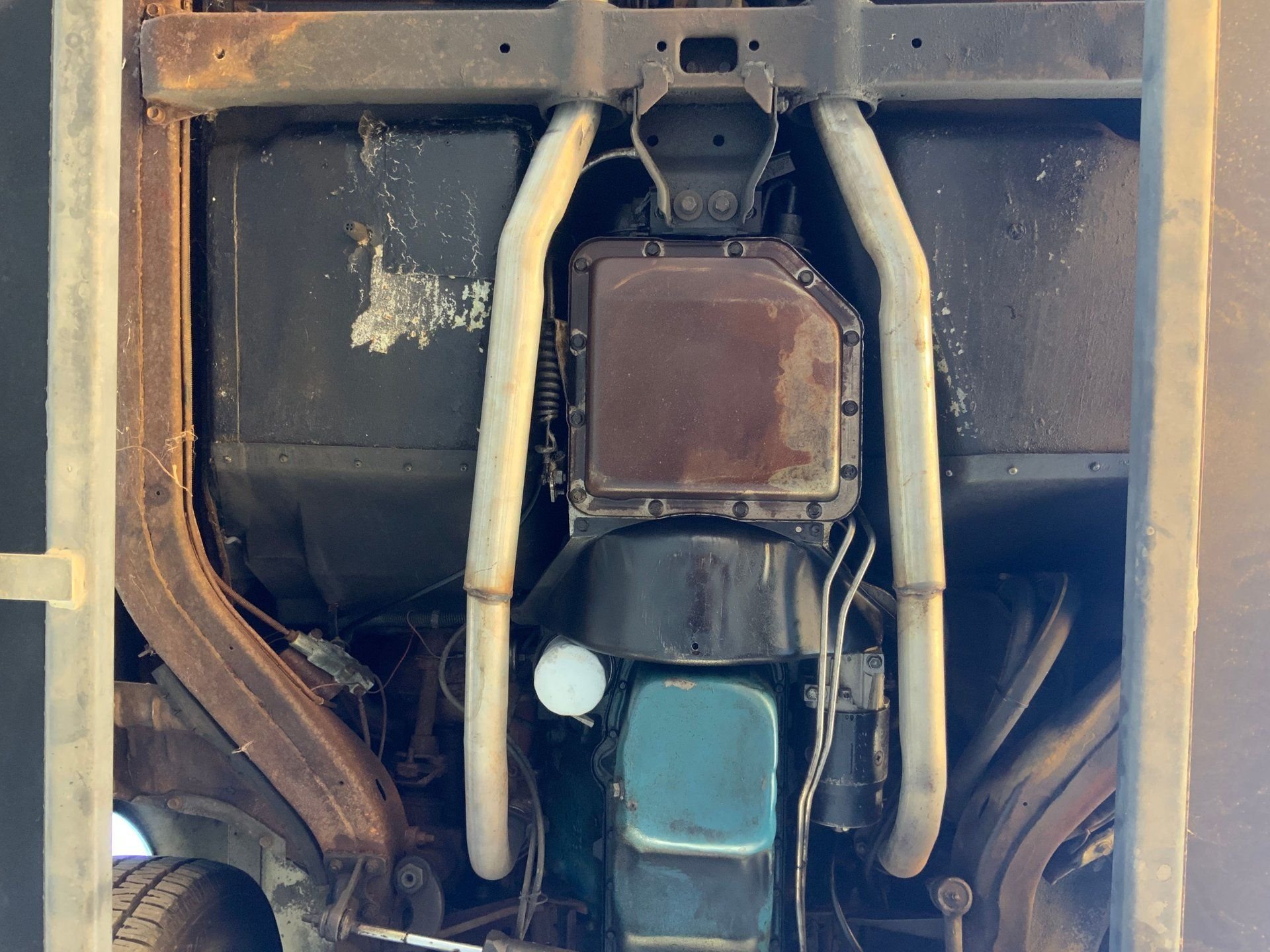

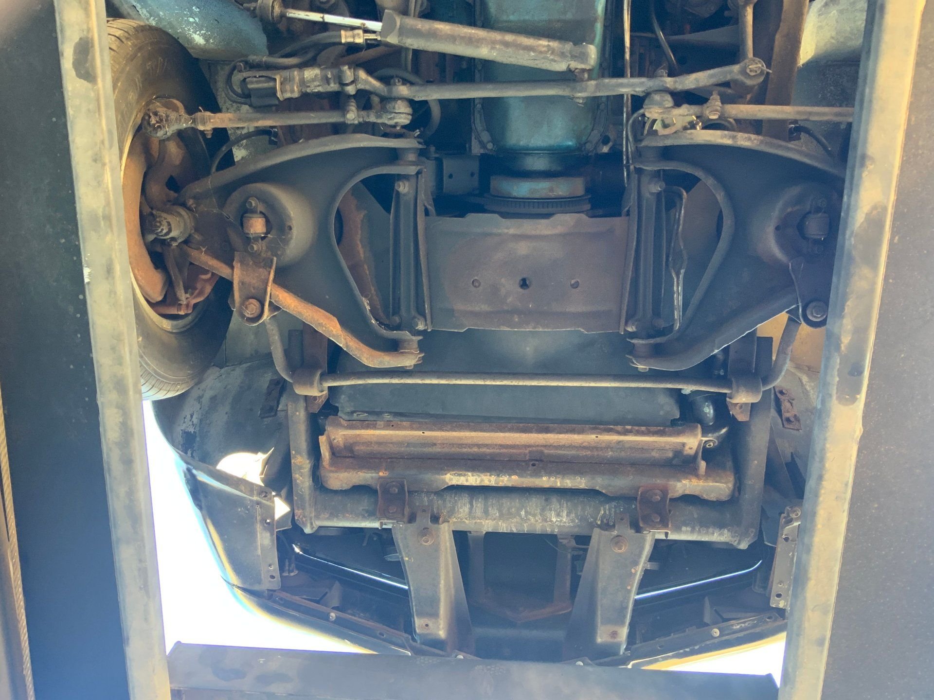

  • Is the frame rust (photos below) at a dangerous point in your opinion?

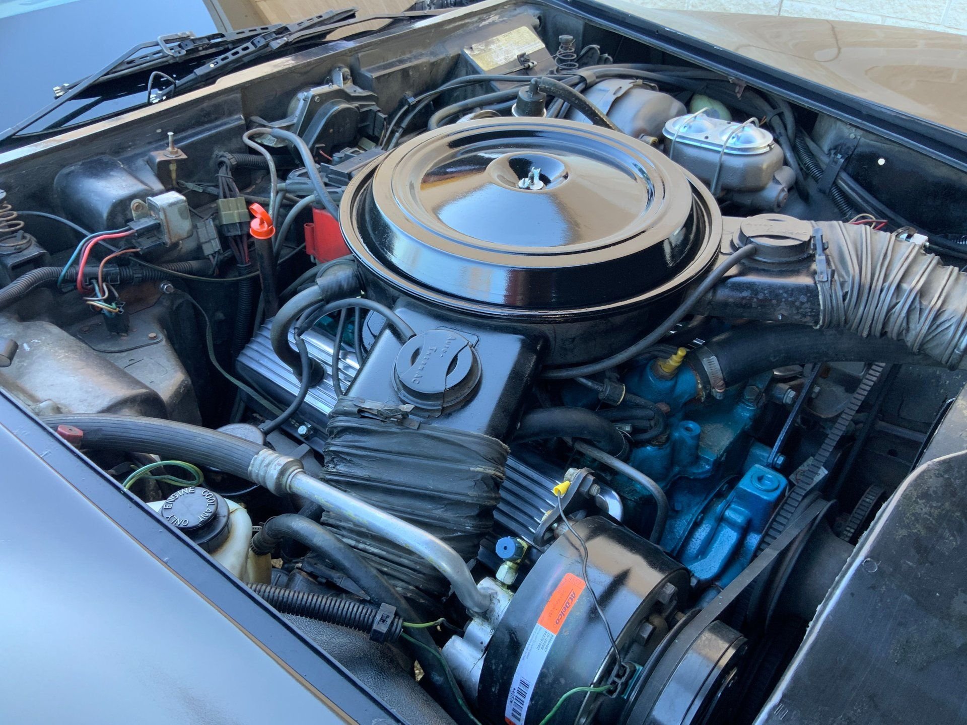

  • Engine bay looks surprisingly clean and well taken care of. Looks like some replacements have been made.

The rust you are seeing is nothing to be concerned with. It is mostly surface rust from being an old car that just sat in what most likely was a humid environment. The rust you need to look out for is in what is called the birdcage. It is framework that goes around the windshield, down the front of each door, then along the frame rails under the doors and then it comes up behind the driver into the roof, or halo. The major areas that rust first are down by your feet. You can usually see these areas with a flashlight and not removing a lot of trim. Take the kick panels off and look inside, you wiill see the hinges and hopefully not a lot of rust. The other really bad place to have it is around the windshield, especially along the top. Seeing that is not to easy without removing more trim, which they may or may not let you do. THe issue is that water gets between the stainless trim and the header bar and just lays there, or drains down along the 2 sides of the windshield. That all can be repaired but can easily run a lot of money. And look at the support under the radiator, the core support. They rot out pretty easily but are a critical part of the front of the car.

This circled section of the frame looks eaten away -- definitely something I'd examine a lot more closely. The other side too and up where the trailing arms are bolted to the "kick up" part of the frame. The trailing arm looks like it's a bit rust-flaked too.

In addition to the frame rust concerns above:
  • It looks like new rear brake calipers and hoses — but they didn't fix the snapped parking brake cable.
  • The power steering hoses are twisted up
  • Rubber suspension bushings need to be changed
  • Looks like tach needle is not at zero
  • Complete new exhaust or just pipes?

Thanks for the note here. When I am looking at this frame am I primarily checking to make sure the structural integrity of the frame I still intact?

I noticed that leak and it looks pretty ugly. All of these are really good points that I should ask them before pulling the trigger. Thank you!

This one has L82 valve covers but they're incorrect for a '79....should be black..

Check the frame by the front of the doors for rust and the inside just ahead of the doors. Typical rust areas

The trailing arms look totally shot from rust.
If the trailing arms look that bad I can only imagine what the inside of the frame and lower birdcage look like.
As stated above there is a lot of rust shown in the photos.

I am always suspicious of a car that has a squeaky clean engine bay but filthy everywhere else.

On a laptop computer, I can zoom in on the frame. You Do Not Want To See That Photo Close Up !
The rear crossmember no longer is welded to the main frame. Complete separation from rust. And it looks like that, just to the left of the snubber bushing and bracket that someone "played" with two tubes of JB Weld on the crossmember. It has that gray look of a patch? Maybe?
Let this car go to someone with lots of money & time.

The under side of this car looks like it was used as a daily driver in an area where the roads were normally salted and was owned where there is a lot of dampness.
It could also have been subjected to flood or left outside and stored in tall grass for a period of time.
The engine, body and upper birdcage could be in nice shape, but the lower portion of the car could be a total loss.
