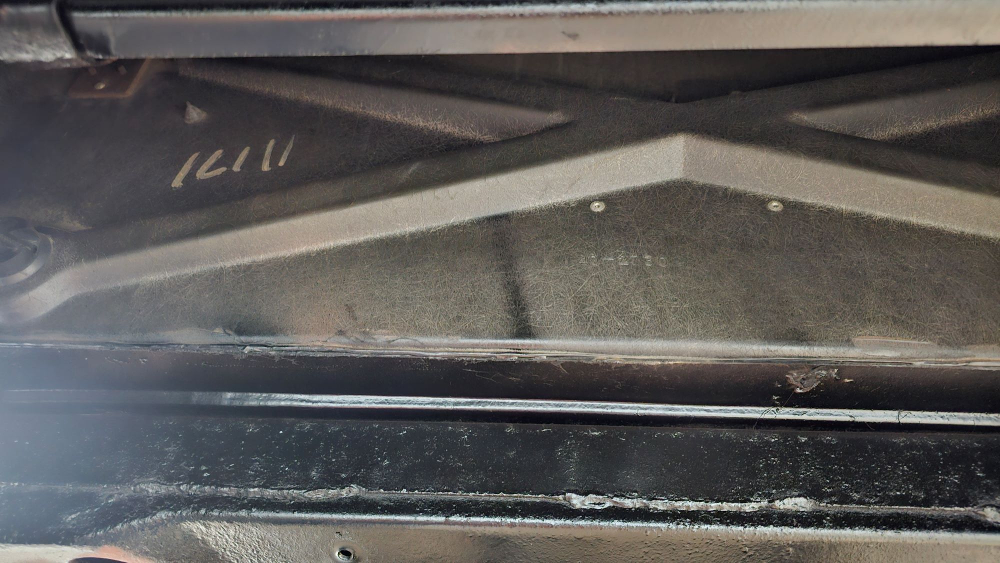

I was curious about these marks. They are under the car ahead of the left rear tire above the diff.
I assumed they are a date. 11/71 as my car is a 12/71 build.
