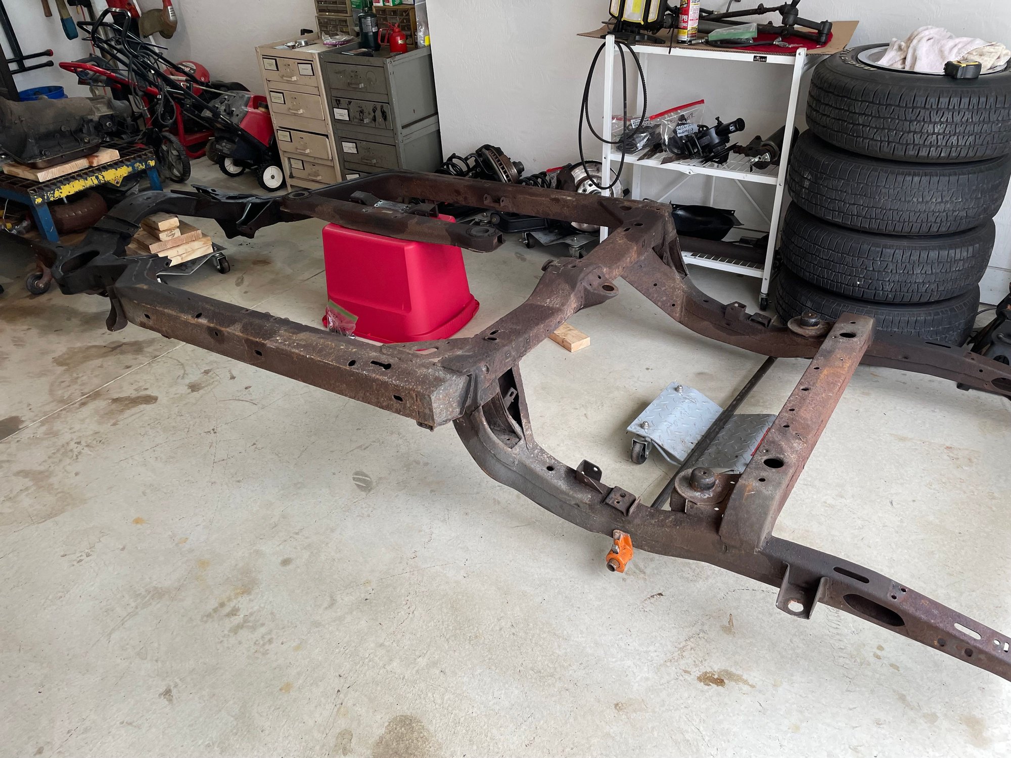

I posted and received feedback about "how high" I'd have to be , to lift the body to clear the frame and now that I have the frame bare; I wanted to give a follow-up. (1972 base convertible) They don't come apart easily but the tips here sure help. Some pics:
Bottom side
Bottom side

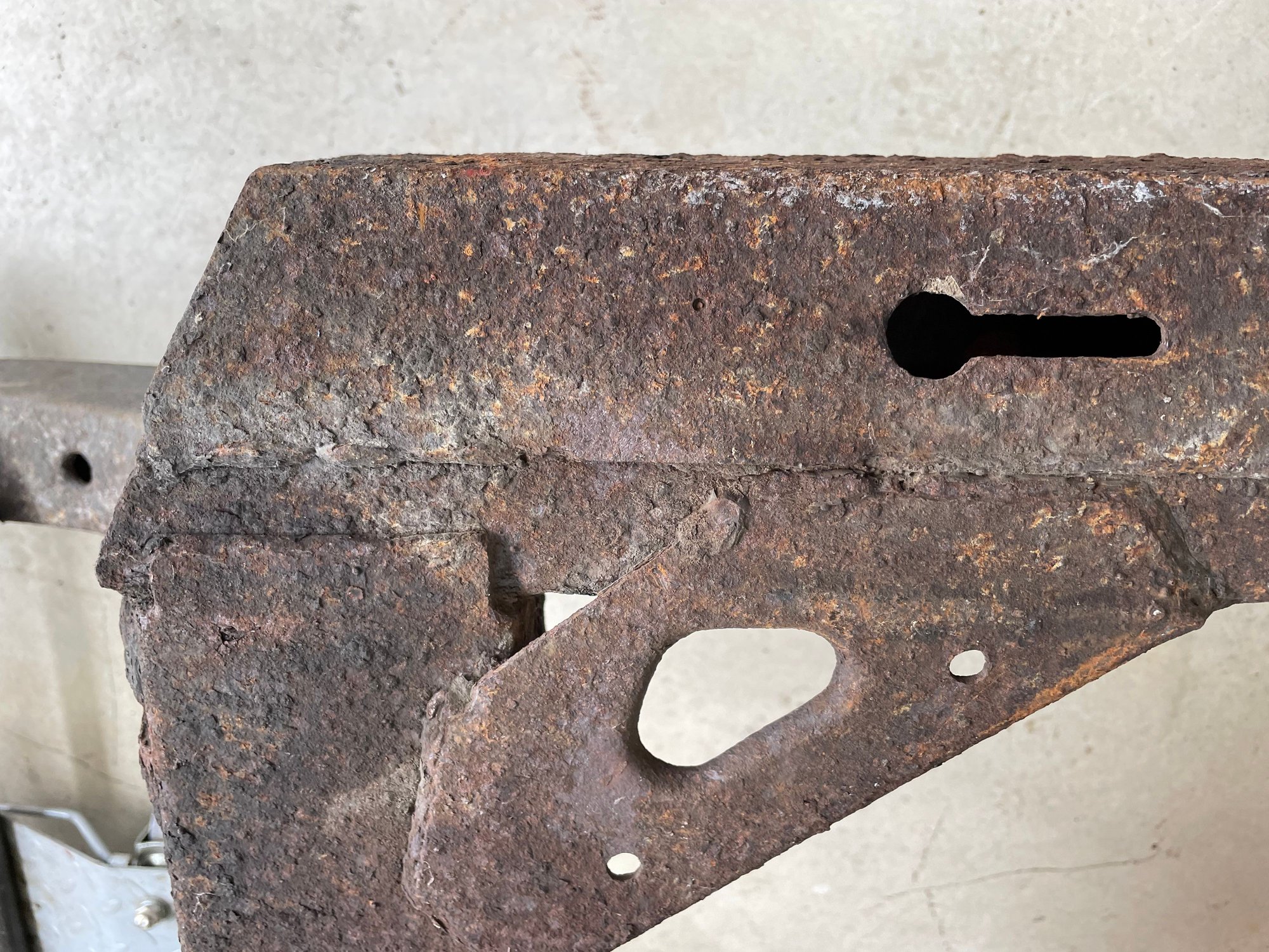

only rust thru area
only rust thru area
top side view
top side view
opposite side
opposite side
I've been struggling with my decision on the frame and overall plan is finish chassis, then engine and then body. Time is somewhat important so I decided to order a new frame from vendor in Michigan. I have the welding skills (but sold all my equipment 2 yrs ago prior to move) but there is a lot of structure in that area and a lot of flaking rust and pitting in a lot of places. I was not comfortable just patching the rotted area and not up to replacing the structure in that area. Costs I received for having the work done were almost same as new frame. I hope to get something for the used frame at some point. The new frame is on order (4 weeks) and within the week dropping off the differential and trailing arms for rebuild. The front suspension and steering has been previously rebuilt. In 5 weeks I could be back to putting it together (yah). I'm having a taller gear installed (3.08 to 3.36 I think) and still want to change to clutch car although will see how the chassis goes. I am anxious to get to the engine which I'll do myself (less machining of course). I want it as original looking as possible without worrying about NCRS. It will never be a collector. Any way that is my update. TTFN

Good call on replacing the frame. The problem with trying to patch the frame is that rust will always reappear somewhere else weather it be months or a couple of years. The old frame is only good for scrap IMO.

If you were to electrochemically strip that frame, you’d have Swiss cheese effect all over.

Feel better about my decision, I was debating about having it dipped before I decided

You made the right choice to replace, like others say once it starts rusting there no stopping it.

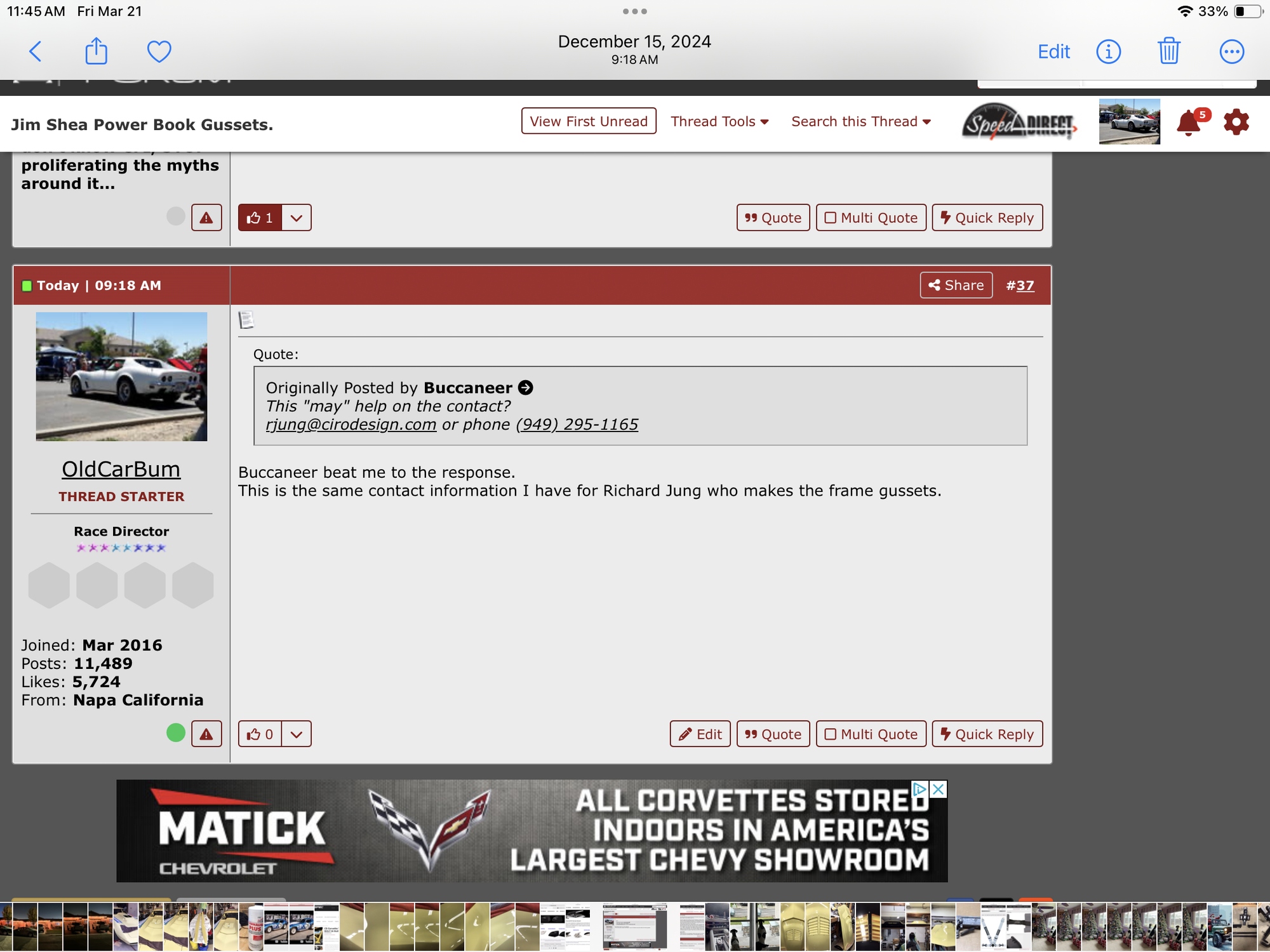

This guy produces a good quality set of the gussets.
He made the ones I purchased and they were perfect.

If you can stab those questionable areas with a medium sized Phillips screwdriver (HARD) and not penetrate the metal, you have surface rust. Wire brush any loose stuff off and have at it.
