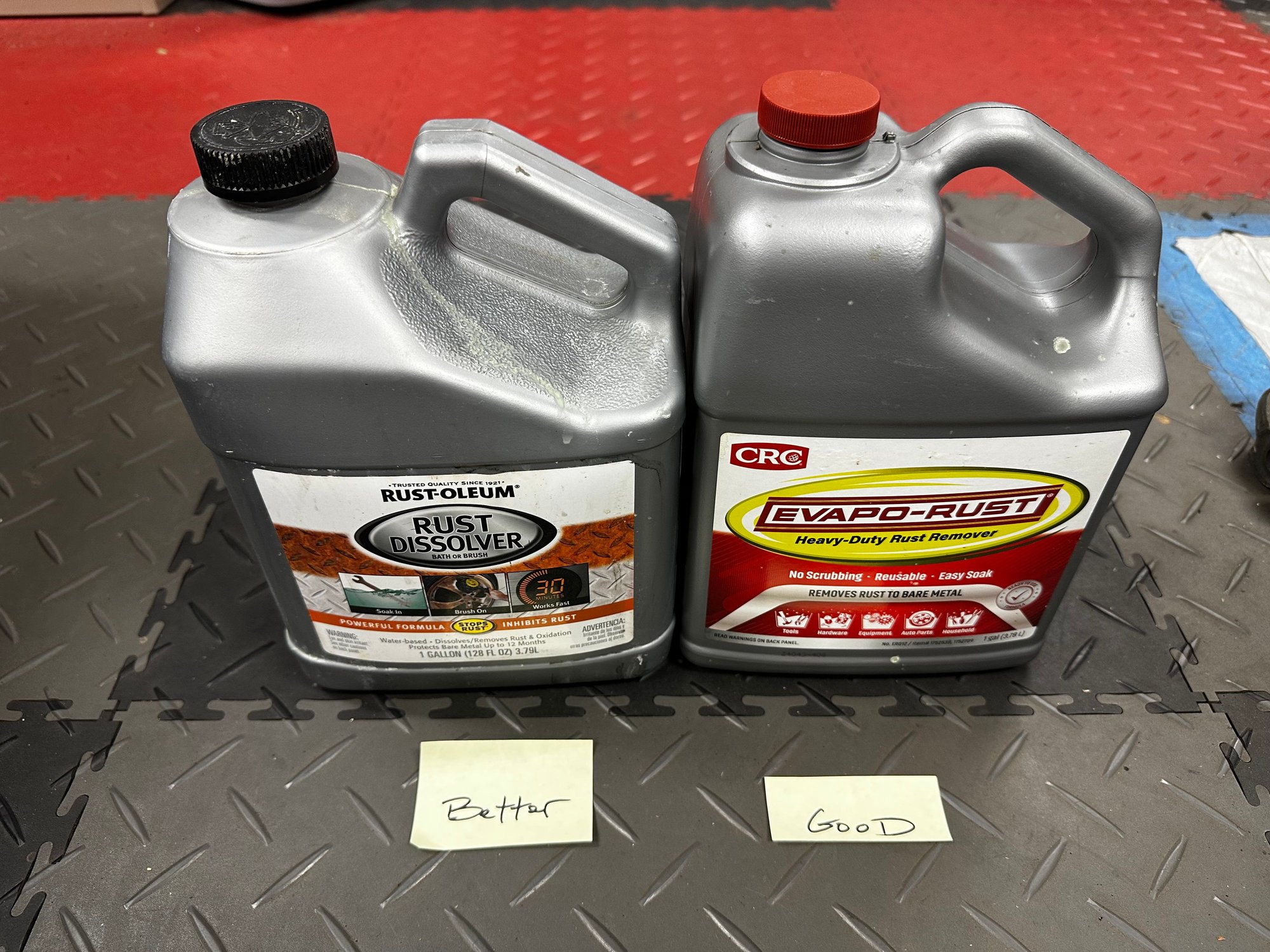

Adding to your OP. I use both Rust-Oleum Rust Dissolver and Evapo-Rust in gallon jugs to do 24-hour soaks on bigger parts like upper and lower A-arms, control arms, spindles, dust backing shields, etc.. I also use this same product for bolts, nuts, washers, and smal rusted, greasy, crud covered small parts too. These both work better if you can get the heavy grease, oil, and grim off the parts before you start the 24-hour soak. The price per gallon is similar.
In my limited experience, the Rust-Oleum Rust Remover works better than the Evapo-Rust product. Rust-Oleum Rust Remover also does a better job of cleaning the dissolved salts and residual parkerizing solutions off the interior and exterior of my stainless steel pots. Just pour a couple of tablespoons full of the Rust-Oleum Rust Remover into blue shop towels and wipe clean. Rust-Oleum Rust Dissolver works very well to clean up parkerizing pots too.
I have both of these locally from hardware stores in gallon jugs, price is similar.
I have both of these products locally from Ace Hardware stores in gallon jugs. I believe Home Depot and Lowes carry it too.
