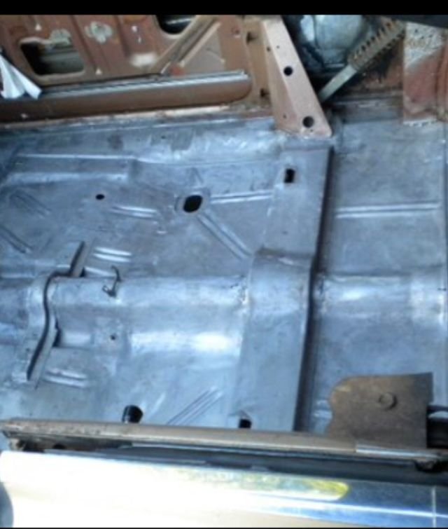

I mostly use Evapo-Rust but I also mix up my own concoction of 50% Navel Jelly and battery acid. I've done entire floors with this and it works,for me anyway. I did the floor in this 63 Nova convertible,that's virgin metal in the picture,that floor was scrubbed mostly with small SS brushes,a lot of them.
