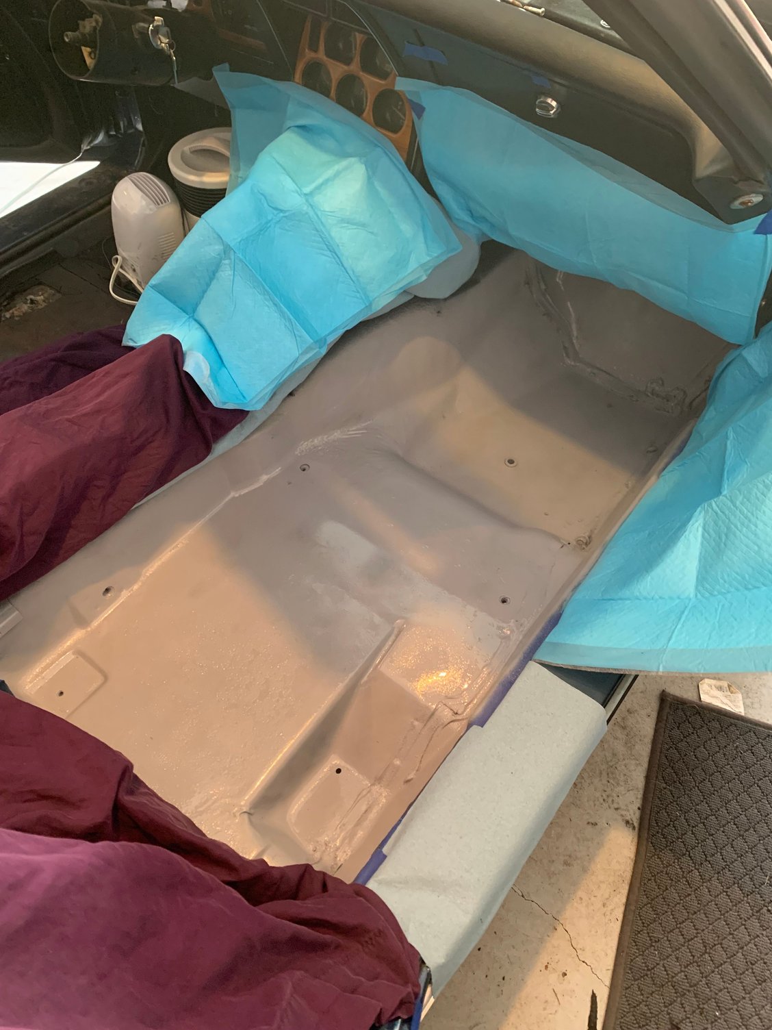

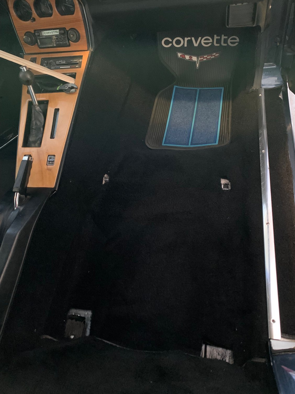

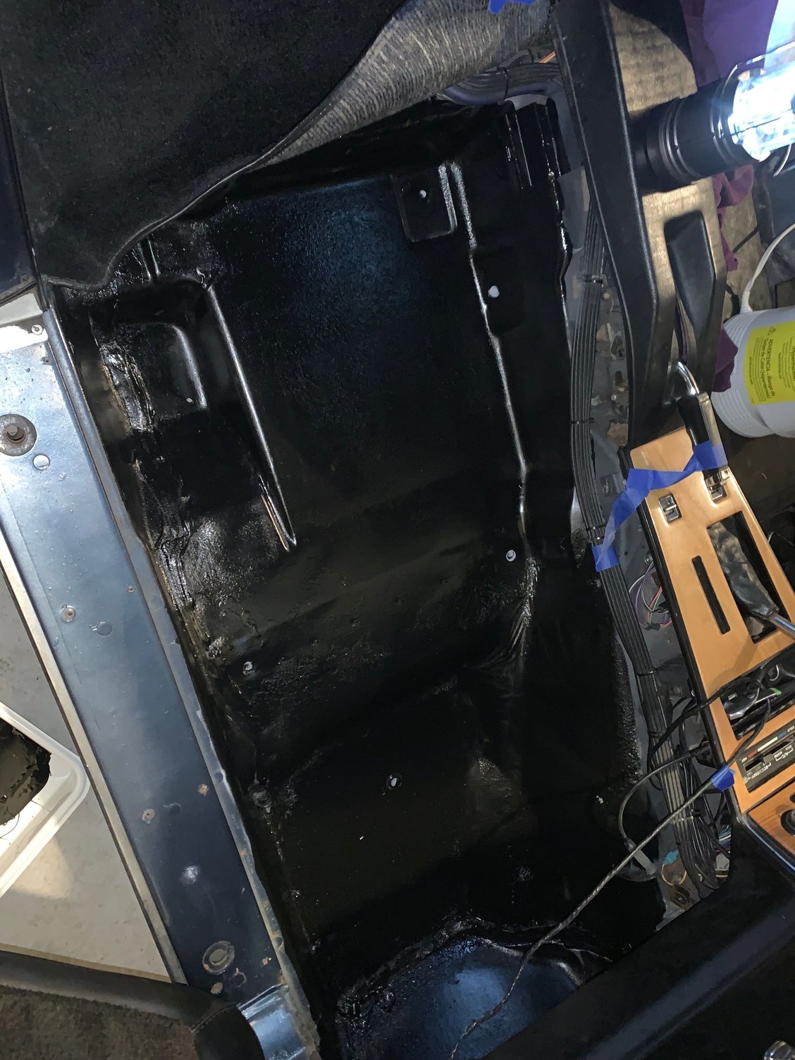

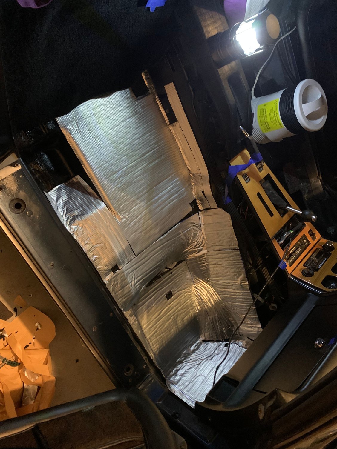

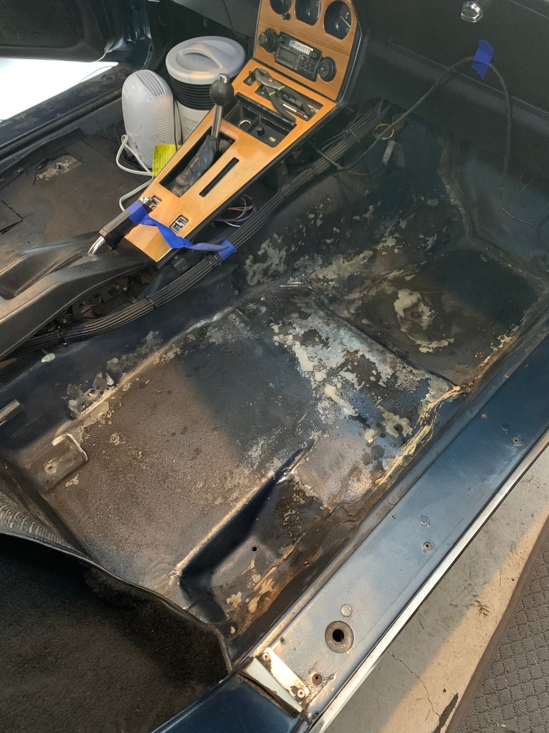

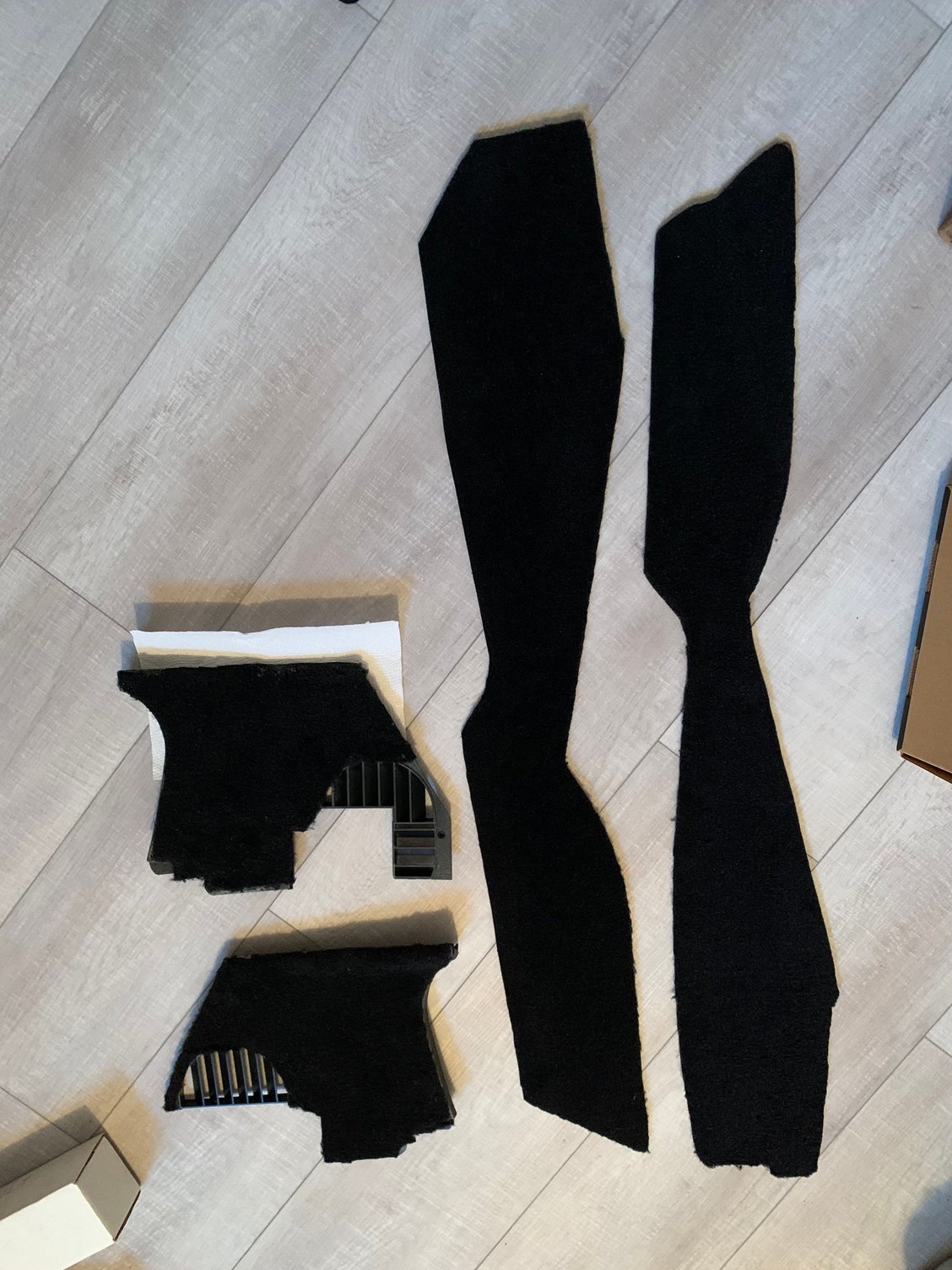

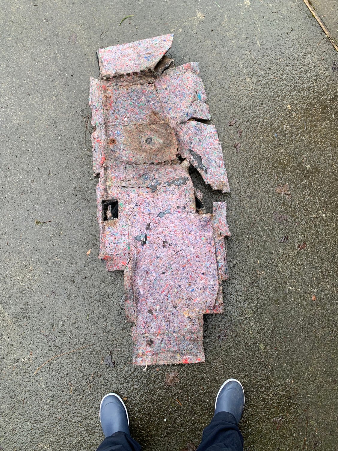

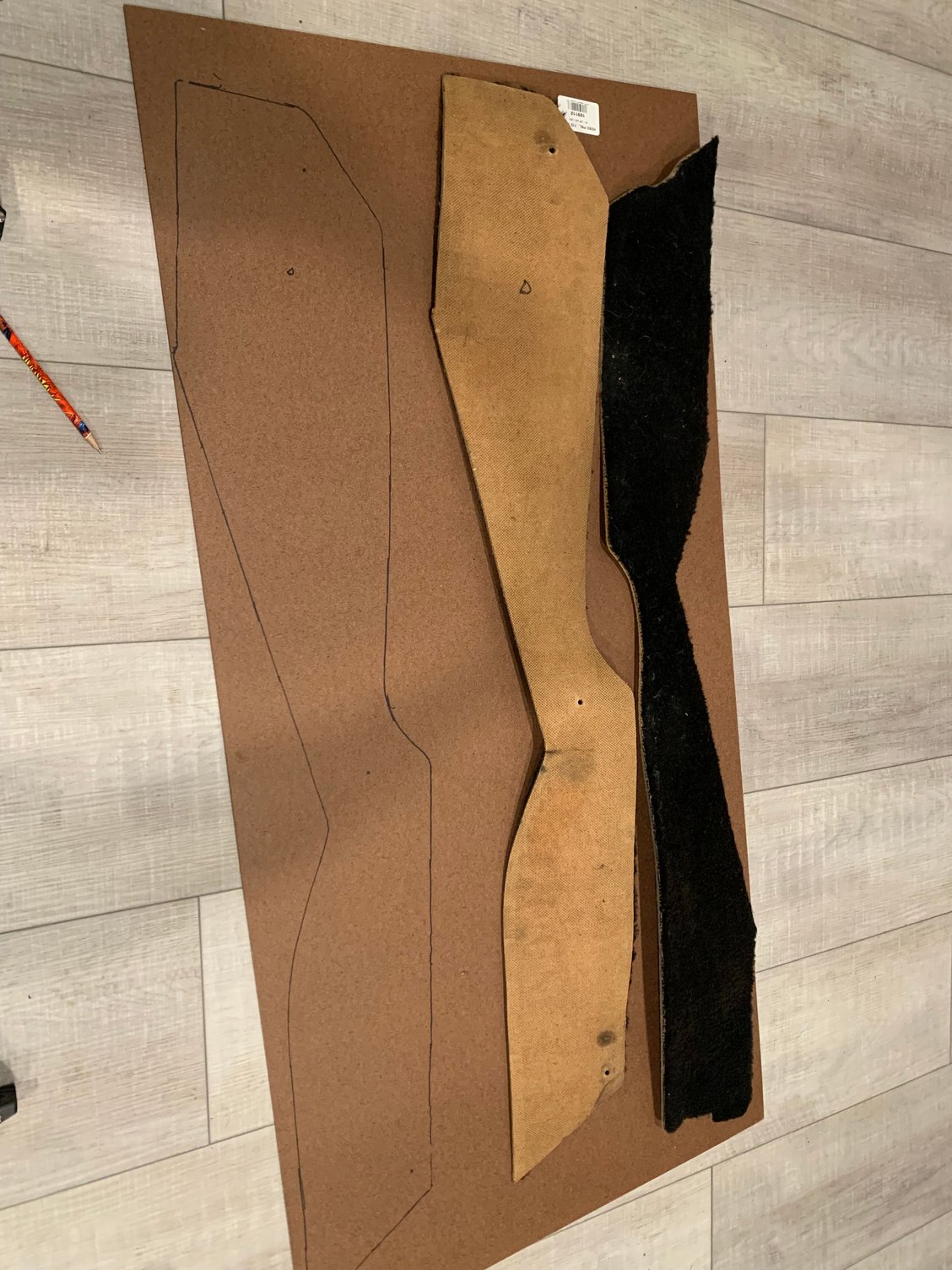

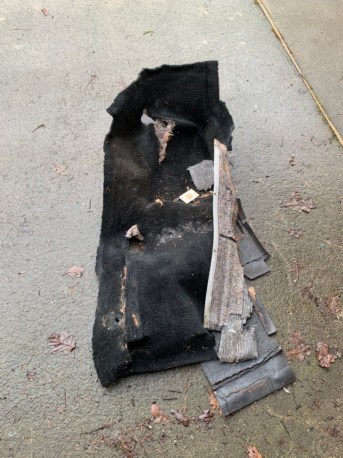

Got the passenger side carpet kit installed on my C3. Ordered the kit from JEGS, but it was supplied via a different vendor. Worked fairly well, center console pieces had to be trimmed to fit and the vent panels were slightly off, however, I am happy with the final product and would absolutely order this kit again. The most difficult part of this process was putting the center console pieces back in place, but replacing the wood fiberboard was the way to go in my situation due to the water damage my C3 had. (Home Depot had the fiberboard, cheap and easy to find. Also bought my sound/heat insulation mat from Home Depot, and cut my own pieces for a budget friendly build.)
Old passenger side carpet
Old passenger side carpet, underside
Making new panels
Making new panels
New panels with carpet kit attached
