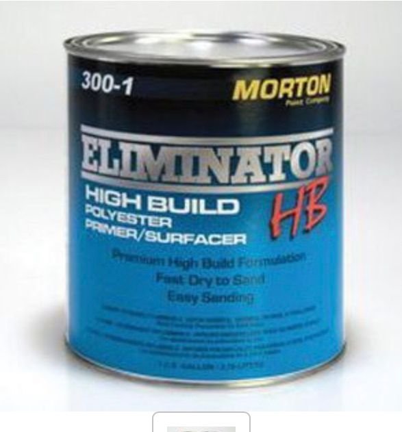

I’ve stripped dozens of Corvettes with methylene chloride strippers without issue. You will need to sand down to bare fiberglass and apply either a two part epoxy or catalyzed polyester based primer surfacer to seal prior to topcoating.

Polyester primer is basically sprayable bondo. As such, it is porous. Epoxy is non-porous and will give you far better and longer lasting results because it remains flexible over time. Southern Polyurethanes makes a high solids epoxy that is relatively easy to sand, unlike many epoxies (PPG for example) that are made for use as a first coat for sealing a surface and sands like sanding a rock. Another advantage to epoxy is that you can use one product from bare glass thru blocking and on to sealing for base. Cost per sprayable gallon is about the same for SPI epoxy or G2 featherfill. I've used both products on glass in the past, and IMO the long term durability of a paint job over epoxy leaves poly primer a distant second.
