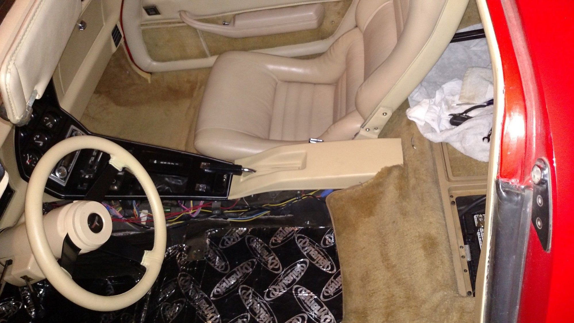

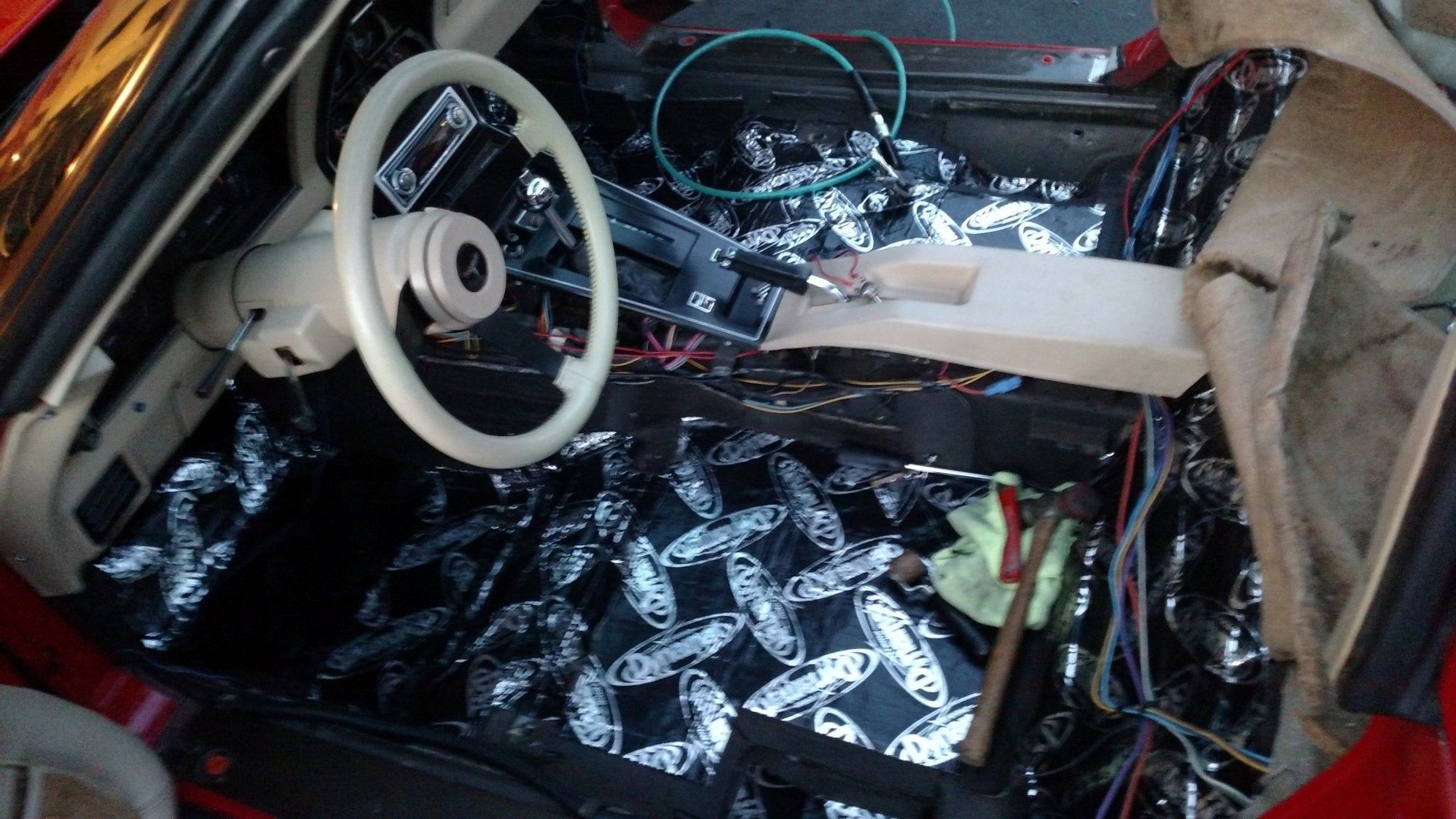

I put the Dynamat in my 78. On the floors, along the back walls and inside the doors. Not precut but it wasn't that difficult. And as stated above, you do not need to cover every inch. When I got my C6 it had noise problem also so I got a cheaper version of Dynamat, Fatmat and it worked great also. You could actually hear the difference ( my WIFE actually noticed it).

Hi Joe, I used Dynamat in Nova and that car had 3 inch chambered exhaust and was loud and the Dynamat worked great even though it appears thin on handling. My recommendation is that if you buy this or some other version what I did was take some semi heavy paper from Home Depot or Lowes and trace out each area and then cut the pattern out yourself. It is easy to cut with a blade, scissors are a bit harder because of the adhesive but the stuff works and it sticks. I used the recommended rollers to smooth and it went fast and easy.

I used Dynamat in my 81 , floors from firewall right up to the rear compartments , a few pieces in the rear compartments , I did not cover the rear wheel wells or under the center console or full doors just a few squares, the improvement keeping heat out and lowering noise are pretty decent but I am planning a do over to cover everything, on my 67 Chevelle I covered just about every square inch , full doors , full firewall, full floors ,fully behind the rear seat , roof , quarter skins , now the difference between covering everything is huge I know people say you don't need to cover everything you don't but if you want the best result cover everything, I probably spent 750ish on dynamite it was well worth it , driving down the road you roll up the windows you can barely hear the exaust never mind how great the music sounds now. No hot floors either.

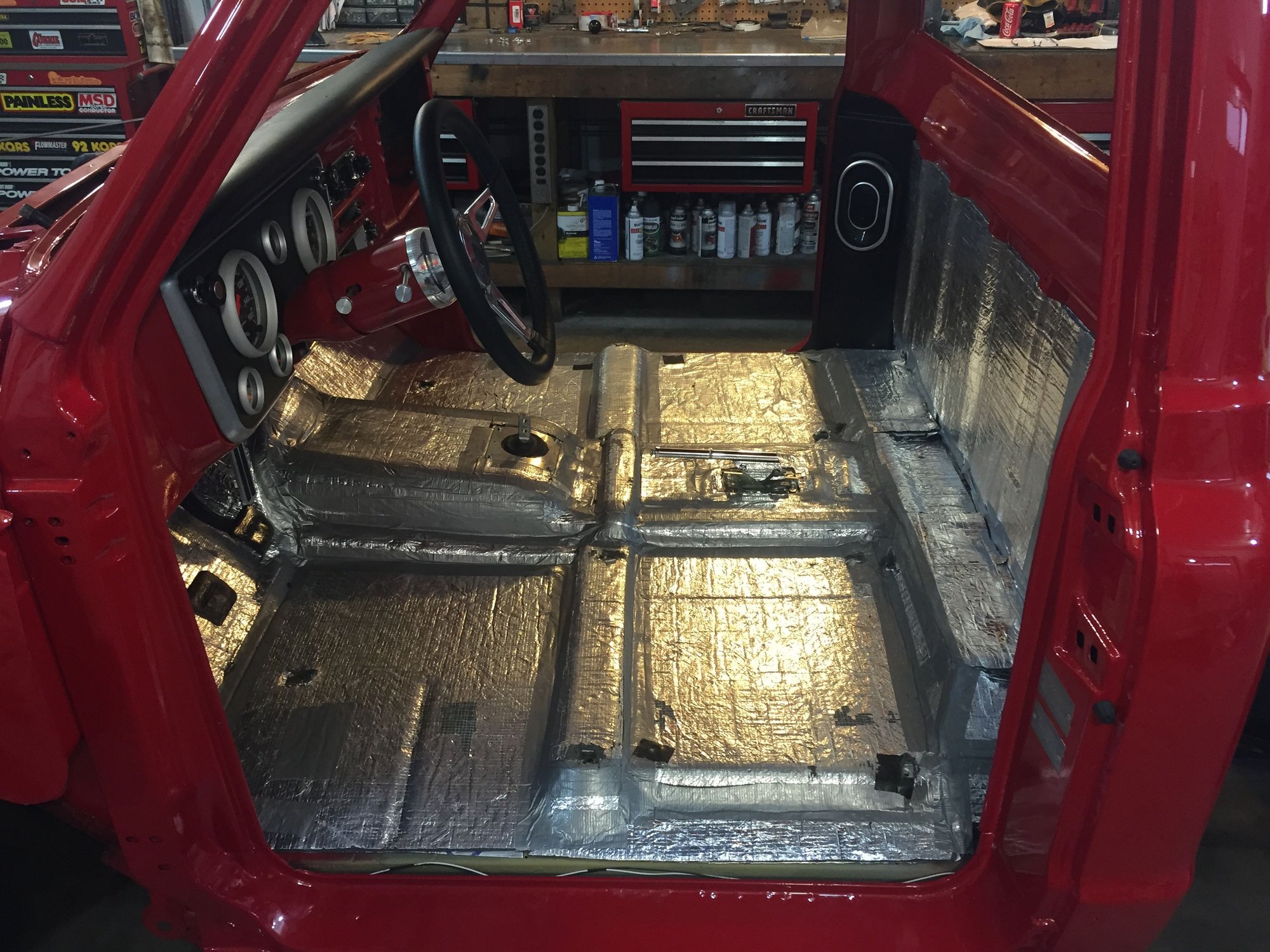

In my 71 I used Dyna Mat like stuff from DEI. Yes you have to cut to fit but its not difficult to cut. I used a box knife. I use the Dyna Mat like stuff as the first layer. Then again from DEI foil on both sides with about 3/8" of jute between the foil. Glue that to the first layer. Then on the 71 from the under side of the car I used from DEI it's a waffle foil with sticky fiberglass insulation.
Pic of my 68 C10 project before carpet.

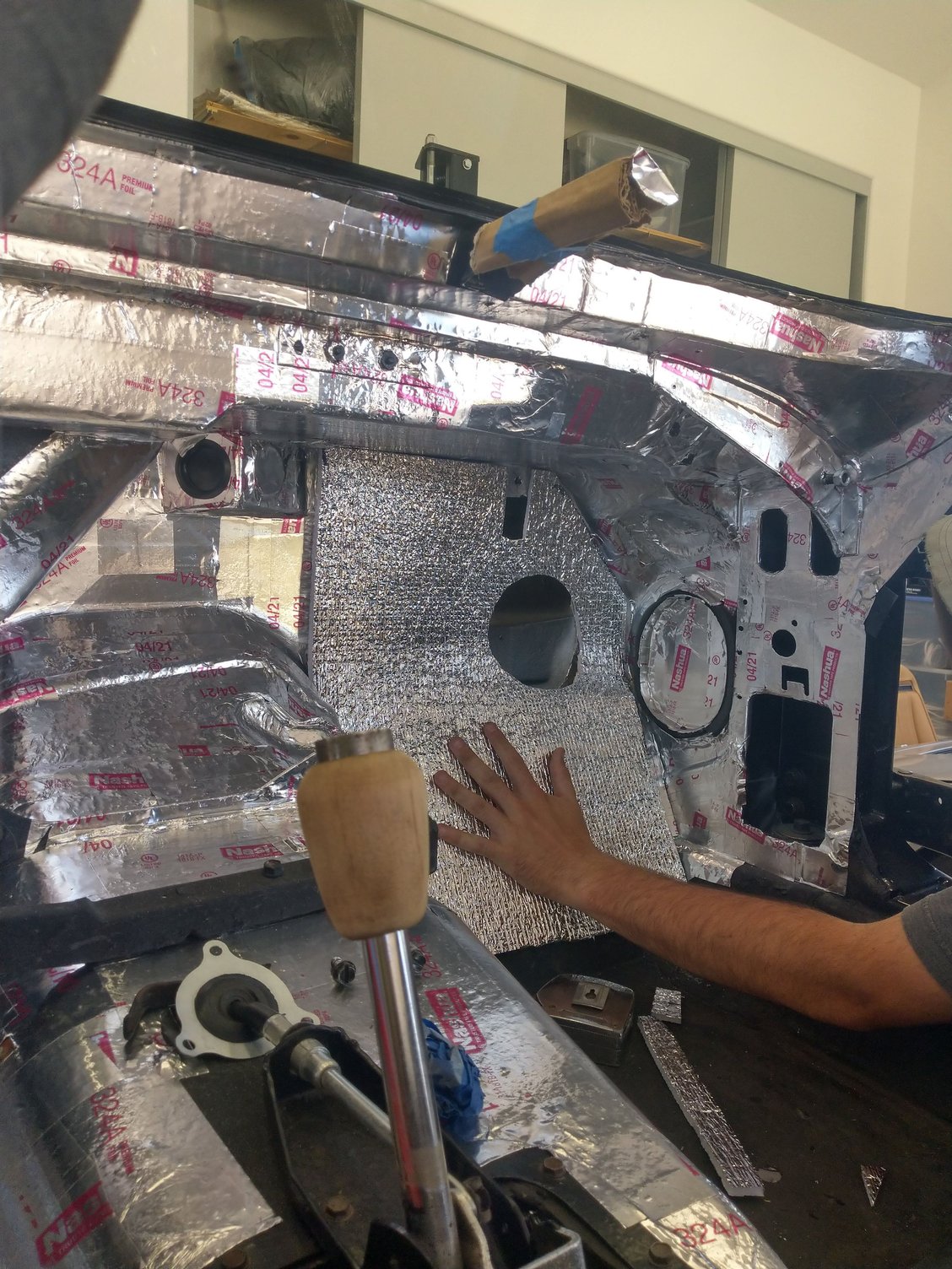

Just was concerned about heat- used adhesive heat shielding ( heat shield products ) outside the passenger cabin. As the space shuttle doesn't put the heat shields on the inside!

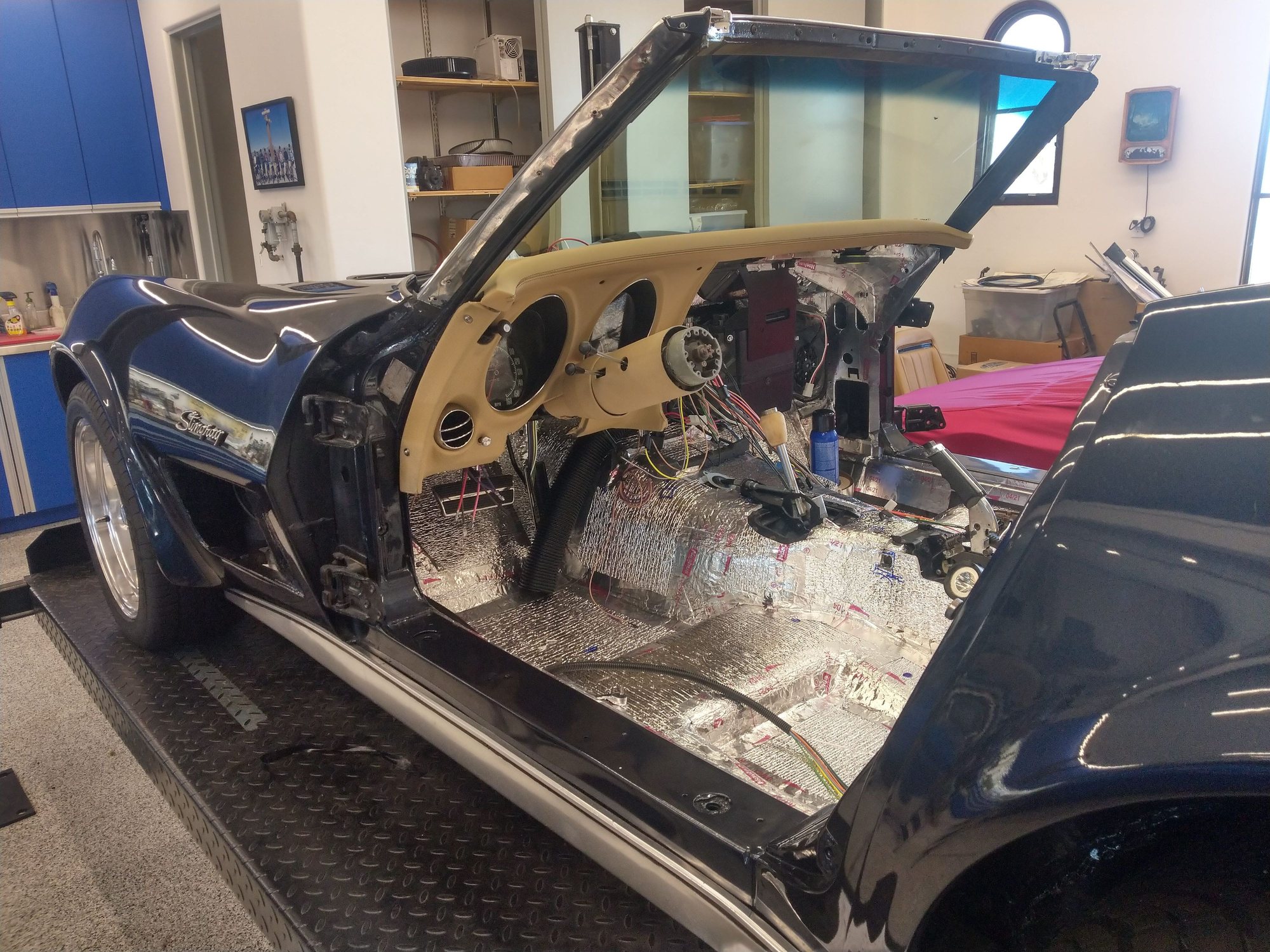

I can't give results on sound (it's a convertible) but I had excellent results on heat control using Doorgunner's method of using home depot foil covered insulation. It is all about controlling IR and this product puts you in the shade from that great big heat lamp under your hood. Like suggested above, I hired a kid to cut it and put it down with spray adhesive and foil tape. It worked so well I put it in two other cars after the Vette.
