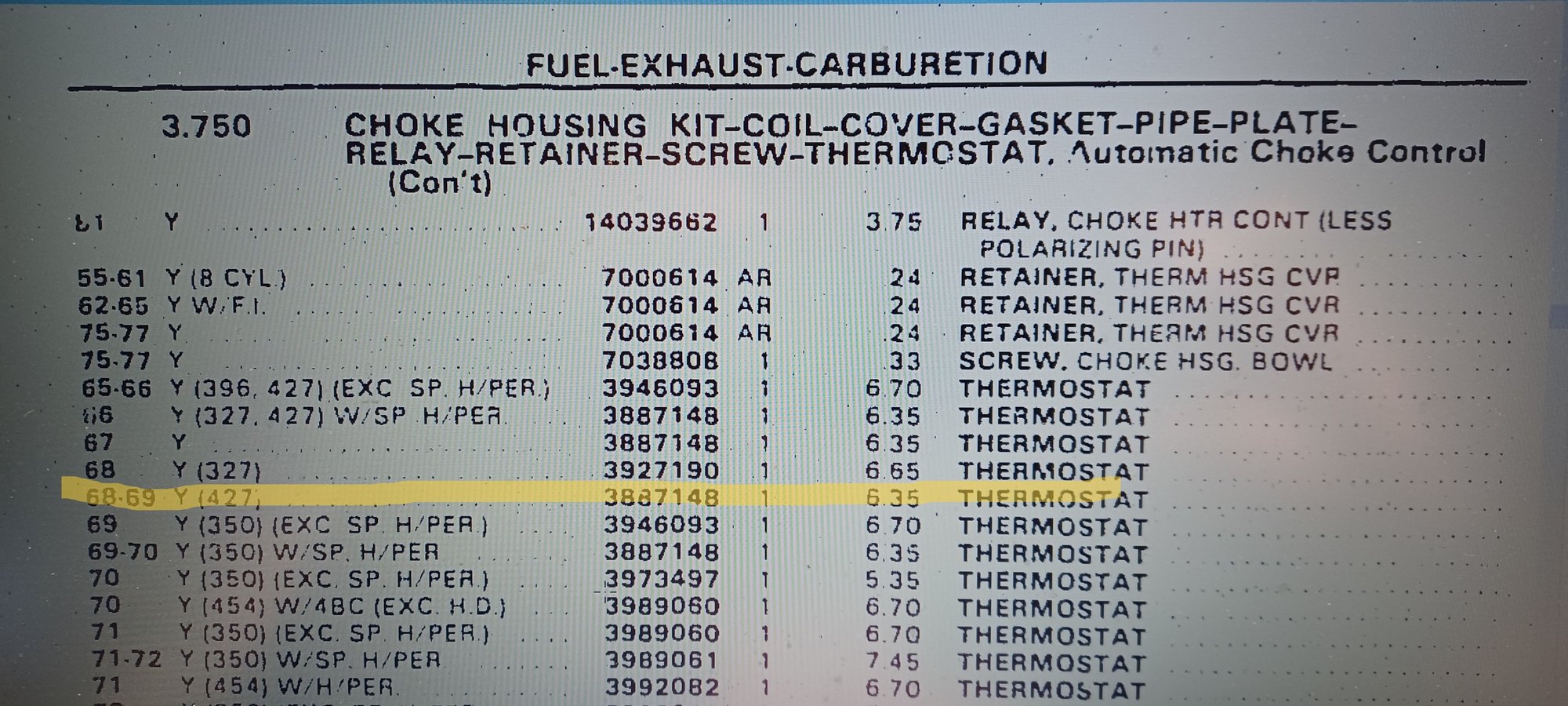

The choke coil is the same for 1968-1969 BB. GM part #3887148.
Actually, it's not. That's a big problem with vendors that think it is, and for owners who don't know the difference. The 1968 BB Q-Jet is a 1-year-only unique design that has the counter-weighted "duckbill" choke, and it is a "reverse rotation" choke that has the choke coil operating the opposite direction than the 1969+ choke coils.

Sorry, but I can only go by the information the General has supplied to me via the parts catalog. If this was "back in the day" and I gave this choke stat to a mechanic and he came back and explained as you have that it was wrong, I would be giving **** (Service Parts Assistance Center) a call. Parts catalog mistakes weren't very common, but they did happen.
