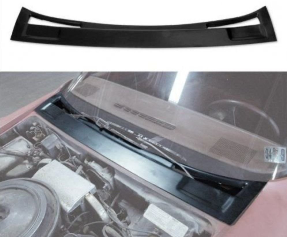

Hi,
Could someone with experience in mounting these Wiper Bay Covers please let me know how you fasten them to the car? Your help is greatly appreciated.

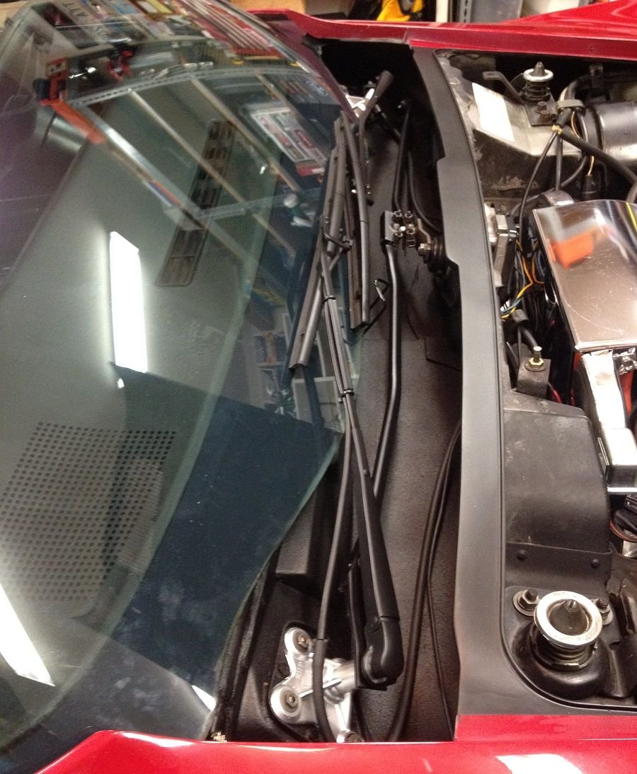

I’m a big fan of cleaning all the seam sealer up in the area and making it look nice. No need for a cover.

I took mine off a few months ago,never could figure how to get it off,finally realized it was stuck on with some type sealant underneath it,but it was just on the corners,but I think some people even drill a small holes with small screws. Good luck

I think most people use double sided tape or hook & loop (Velcro) tape. I've also seen them where someone just ran a few screws through them. I think the hook & loop tape is probably the best solution since it's is the cleanest looking while the cover can still be easily removed if needed.

They're pretty easy.
1. Remove the wiper blades
2. CLEAN the surface the cover will be sticking to
3. Decide if you want to use 3M doubleback tape or Velcro to hold it in place
4. Also, now is the time to decide if you want to paint it to match your body color
5. Slide the wiper arms thru the cover slots at 45 degree angles and drop the cover down into place.
6. Position the cover where you want it and remove backing. Press down to secure.
7. Enjoy years of a debris-free cowl

I used 2 tiny self-tapping screws...

You could get a couple magdaddy magnets. Epoxy them in the back or the cover. Nice and clean- easily removed

I would not trust any double sided tape with rain, heat, cold, so like others, just find some small black phillip screws. Four or five should do the trick. Predrill.
There is a bracket or a brace called a wiper stop or wiper park. I had to remove that for the cover to fit correctly.
The cover may need a little trimming here & there, easily done with tinsnips.
Seems like a lot of money for a cheap piece of plastic.
However, 100% improvement over an ugly area in my opinion.

I moved a ton of wiring into the wiper tray area, thus getting it out of engine bay heat and out of sight!
I put 4 well-nuts in the forward edge. The rear side against the windshield just has some foam on the underside to prevent rattles and scratches.

Piersonpie: Nice looking wiper bay! I’m part way through stripping mine. Following some of the tips in this guys vid (he has a few good vids):
https://youtu.be/V4QVIN1PxhU?feature=shared
You might find that guys other car looks a lot like the picture I posted.
I’ve done a similar job on my car, except using flex seal instead of bedliner. I like the textured look it gives though.

Thanks for all the tips, actually I’ve been cleaning out the wiper bay and I’m in the process of making really clean, the reason I’m interested in the cover is more for a functionality issue with the elements, especially the Sun. I was hoping for a way to try and keep out and protect the area more than just cover it up. On my 68, that’s what the wiper bay door was designed for. My thinking was maybe I can get some protection, who knows it all may be for nothing, but I’ll give it a shot.

I have been running that cover for many, many years. No matter how much you clean and polish that wiper tray, it's just not a very finished place on the car. And yes keeping those wiper linkages covered and protected certainly can't hurt!
