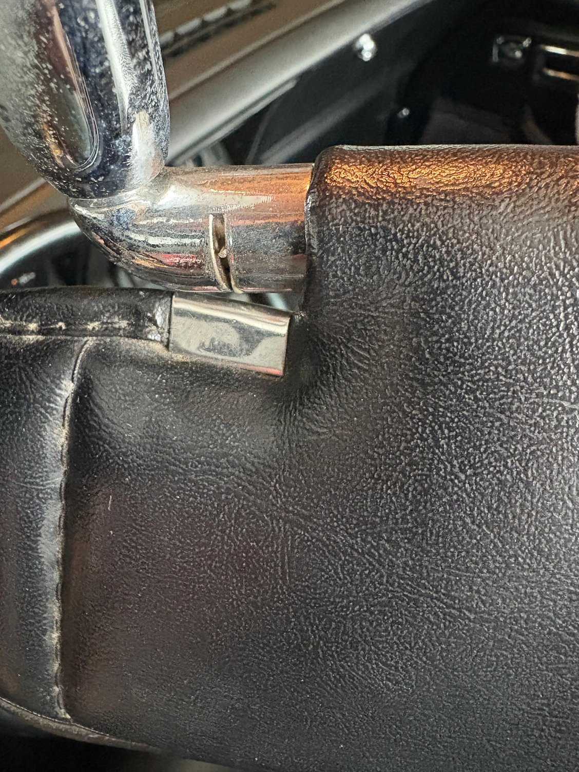

i’m posting pics. Not sure how to tighten these up…..maybe someone else has dealt with this….?…
[img alt="What is that wire in that slot there?
"]https://cimg3.ibsrv.net/gimg/www.corvetteforum.com-vbulletin/2000x1504/img_0301_ecb50f1e65033f43bbd4714b59237c9 b0e2ceb54.jpeg[/img]

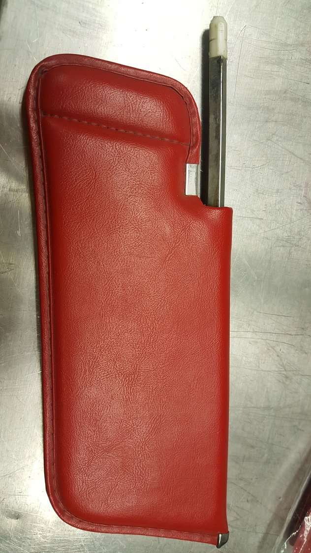

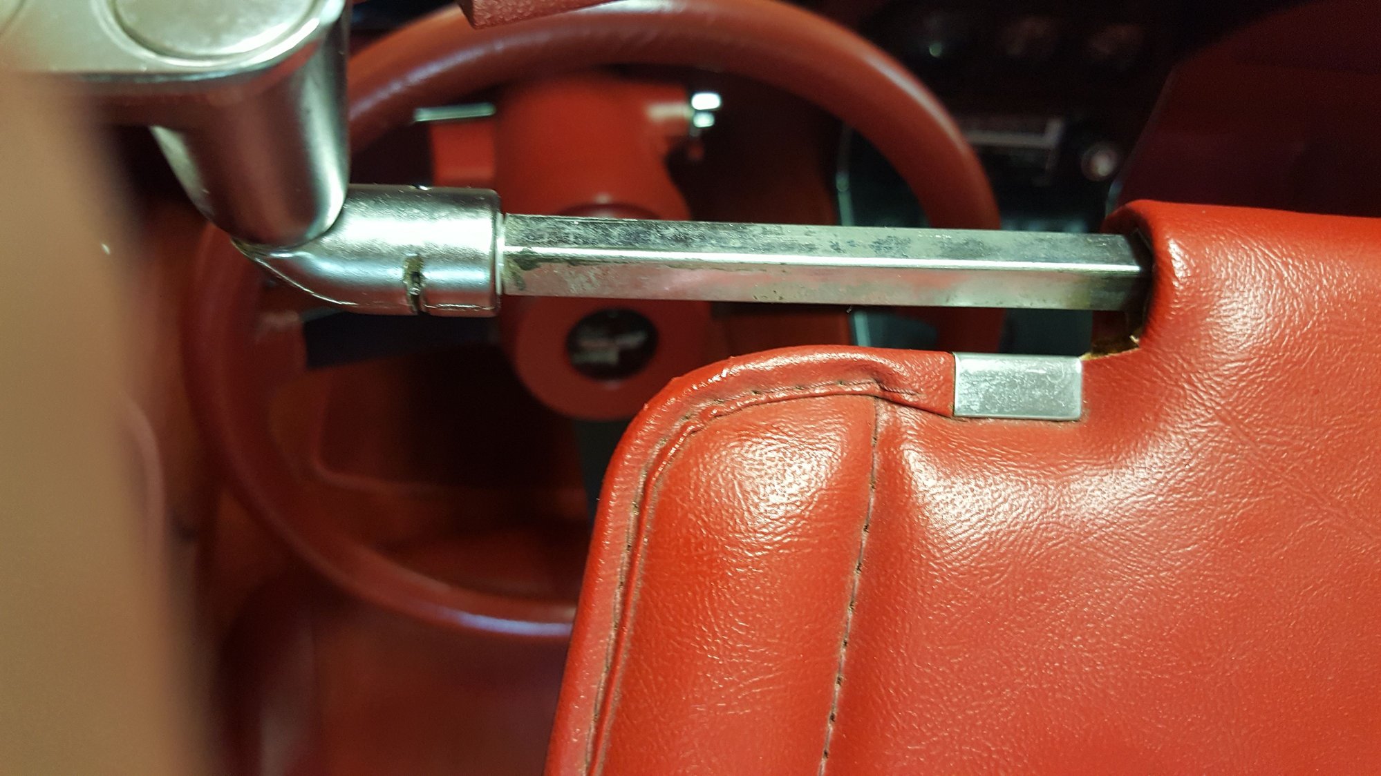

You can buy a kit to replace the plastic bushing that has lost its hold. EASY 1/2 hour project. The Corvette parts vendors have the kits. Zip sold me one. Cheap and easy. The slot holds a snap ring retainer.
Telescoping visor.
Telescoping visor.
Need to replace the white plastic bushing.
Use a pick to remove spring clip retainer here.
