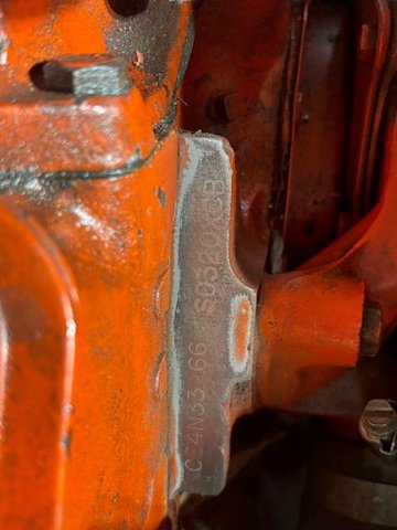

Hi All:
Can one of the gurus on here give me the info on the attached photo of engine castings?
Thanks in advance.

The Lime Book shows suffix code XCB is a 62-63 327 replacement engine.
http://www.camaros.org/pdf/LimeBook.pdf
But I wouldn't trust any of those stamps.

its a CE replacement block
Engine Stamping Numbers
what is the casting number and date
