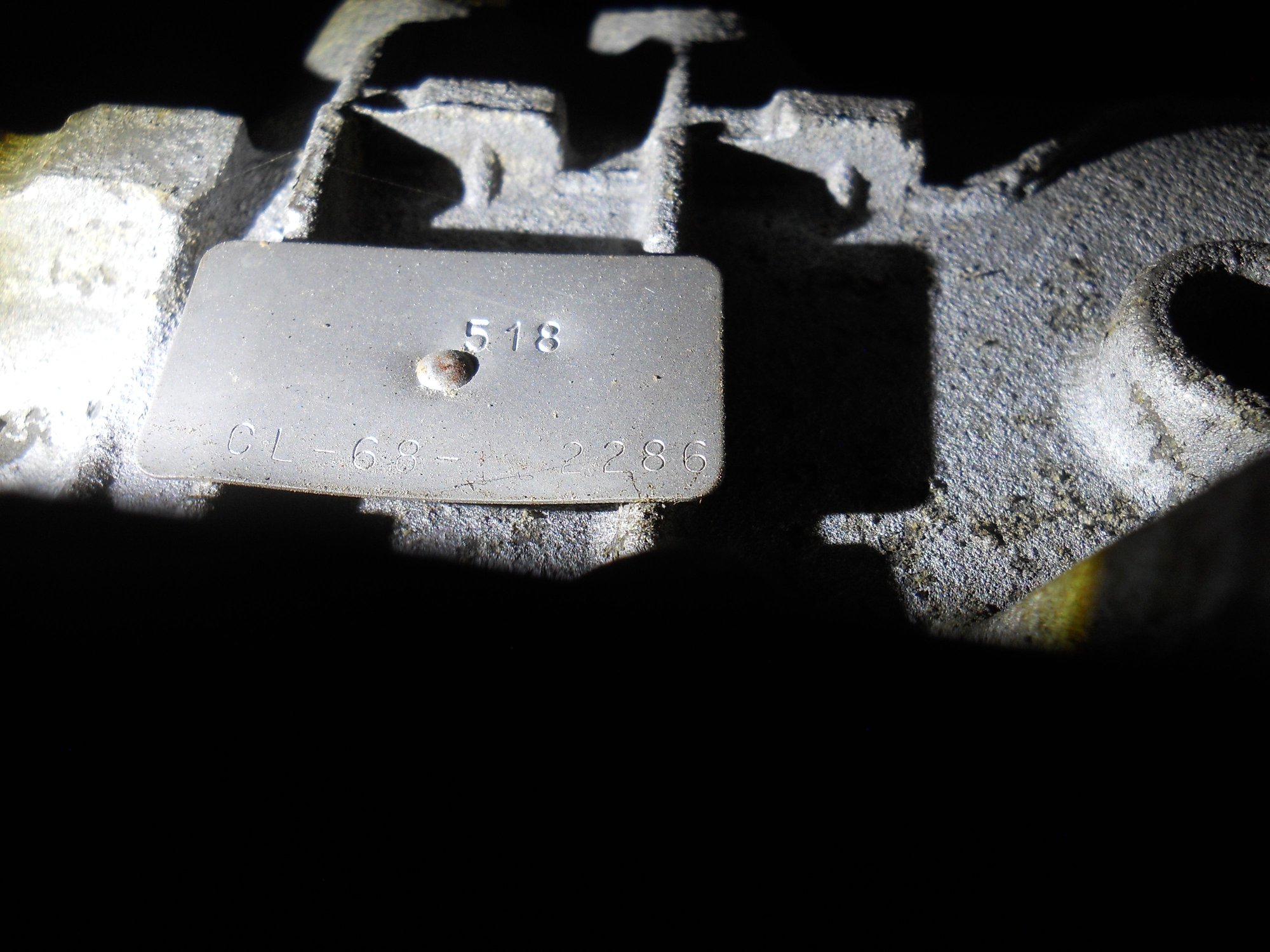

OK. Here's the latest.
Tag on passengers side
Stamp on the drivers side transmission.
Casting info on passengers side just forward of the starter.
Casting info drivers side
Lastly, casting info just behind drivers side cylinder head.

Looks like both the engine and trans were stamped with the sequential 423241 before they were attempted to be corrected to 423242.
I agree with Stan (as usual) in that although I suspect it to be legit, it will ALWAYS have to come with an explanation. That will reflect in the selling price no doubt.

...interesting that it has the same heavy, thick or deep last "2" on the transmission just like the motor, but without the extra "4".

Present owner bought the car with numbers in that condition. Let's see if he can sell them with numbers in that condition (for the money he wants, anyway). If the car is legit, it will be a hard sell for MOST buyers. For his sake, I hope he is able to get the money he wants for it.
Just curious: What would be the scenario where BOTH the engine block AND the transmission get stamped the same, but then get Re-stamped with a different number at the factory???? Also, what does the frame VIN stamp look like???

As for both the block and pad stamped wrong it makes total sense to me, if it is in fact legit, that it’s possible they just forgot to make the vin change and stamped both parts then saw the mistake. It’s only off by 1. But add to it the engine stamp got a poorly done first stamp on top of being wrong. The mistake sequential is 423241 which was supposed to be 423242. However they just massacred the engine stamp trying to fix it but just did a better looking single hit for a 2 over the 1 on the trans.
Like I stated, I have seen a 69 stamp that Al G has stated he believes is real that had two numbers transposed on the pad and was fixed by 2 single strikes over the numbers. Very rarely seen and always a problem to have to explain.
