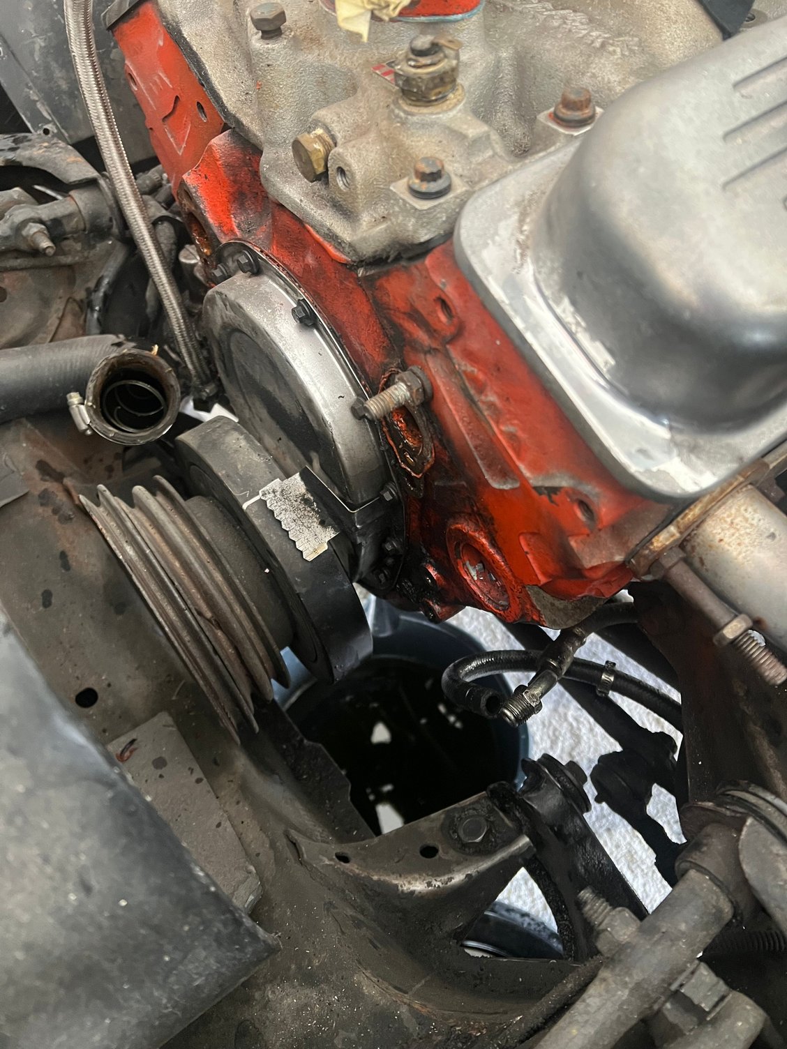

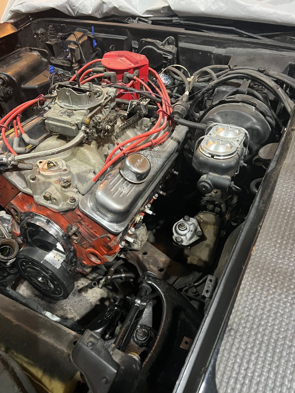

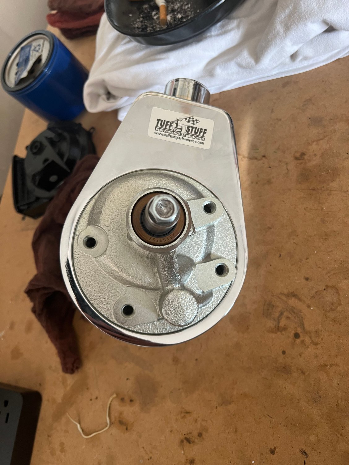

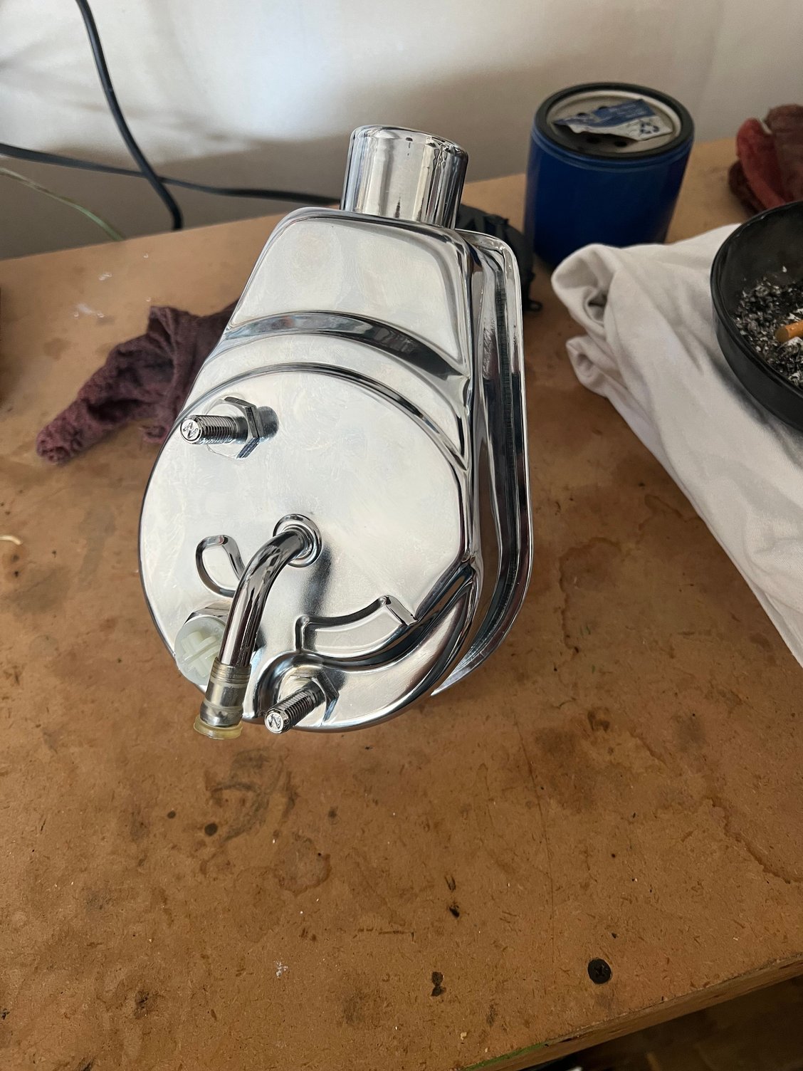

I recently purchased a Saginaw power steering pump for my 79 with a 350 crate motor with a short water pump in it. I am in need of a bracket for it, but after doing some research, there are way to many options out there to choose from, I’m not sure which one is correct, can anyone out there help with this? Maybe some pictures of your similar setup. Also I need a press on pulley.

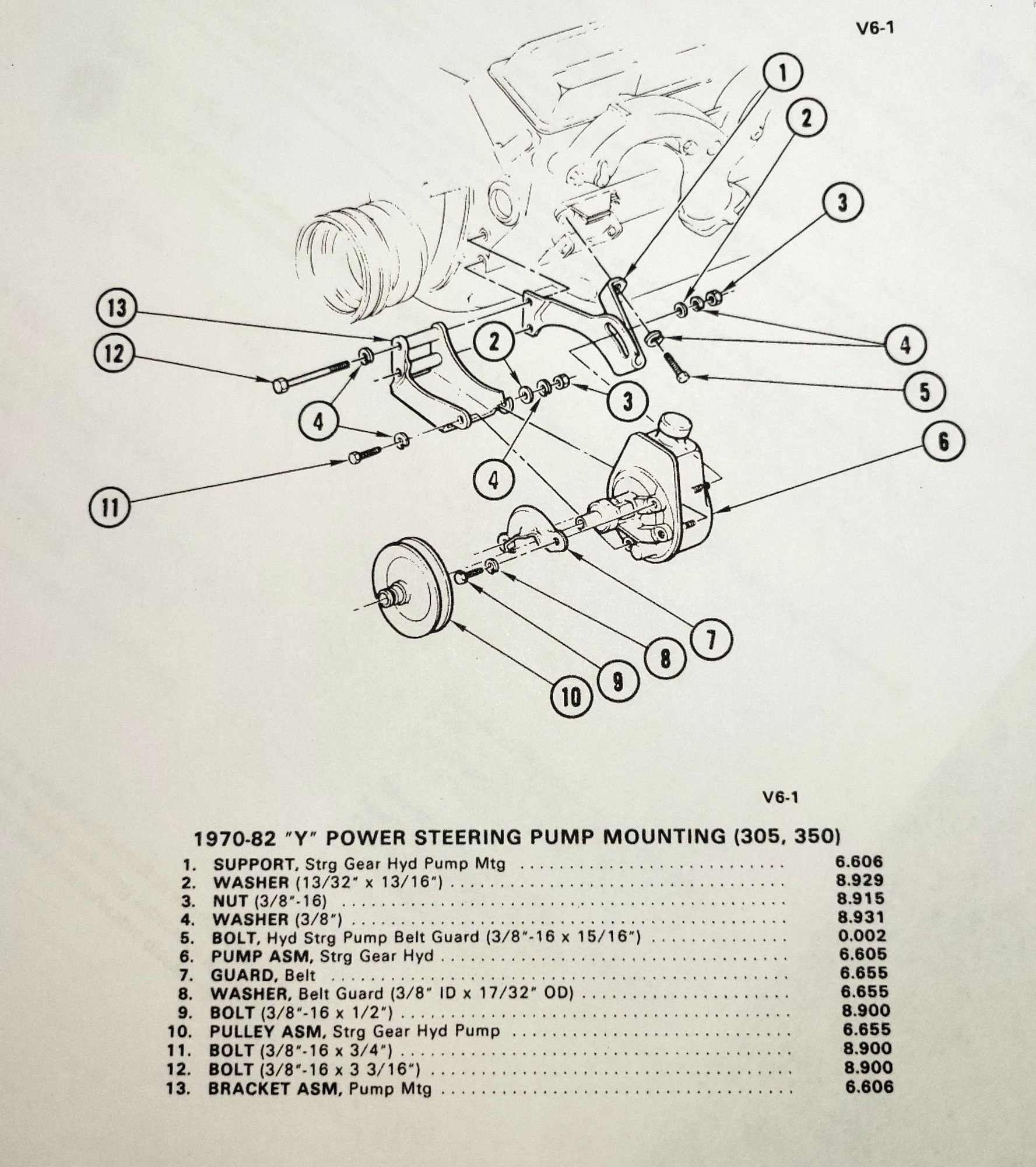

Check the attachment its the GM parts book parts and numbers you needed. Some ebay listings then Corvette Central
P/N 3928493
