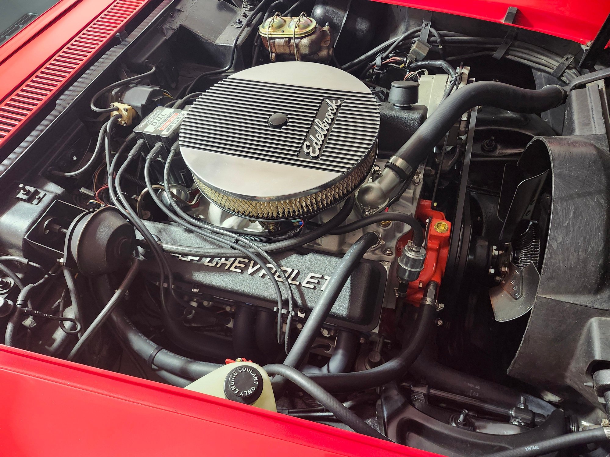

Joined: Aug 2023
Posts: 27
Likes: 5
From: Longview, Texas
Several of you asked for more info on what I'm running now. Good question. The numbers check out to be a 1971 block cast in St Catherines, Canada. I am assuming it has dished pistons, but you know what assuming does! It feels like about 275 HP right now. It currently has headers and a good true dual 2 1/2 exhaust system. Auto transmission. I am installing the roller Comp Cam noted, new push rods, roller rockers, ZZ-4 heads and an Edelbrock Performer intake manifold. I'm hoping for 350-375 HP. DickJ
