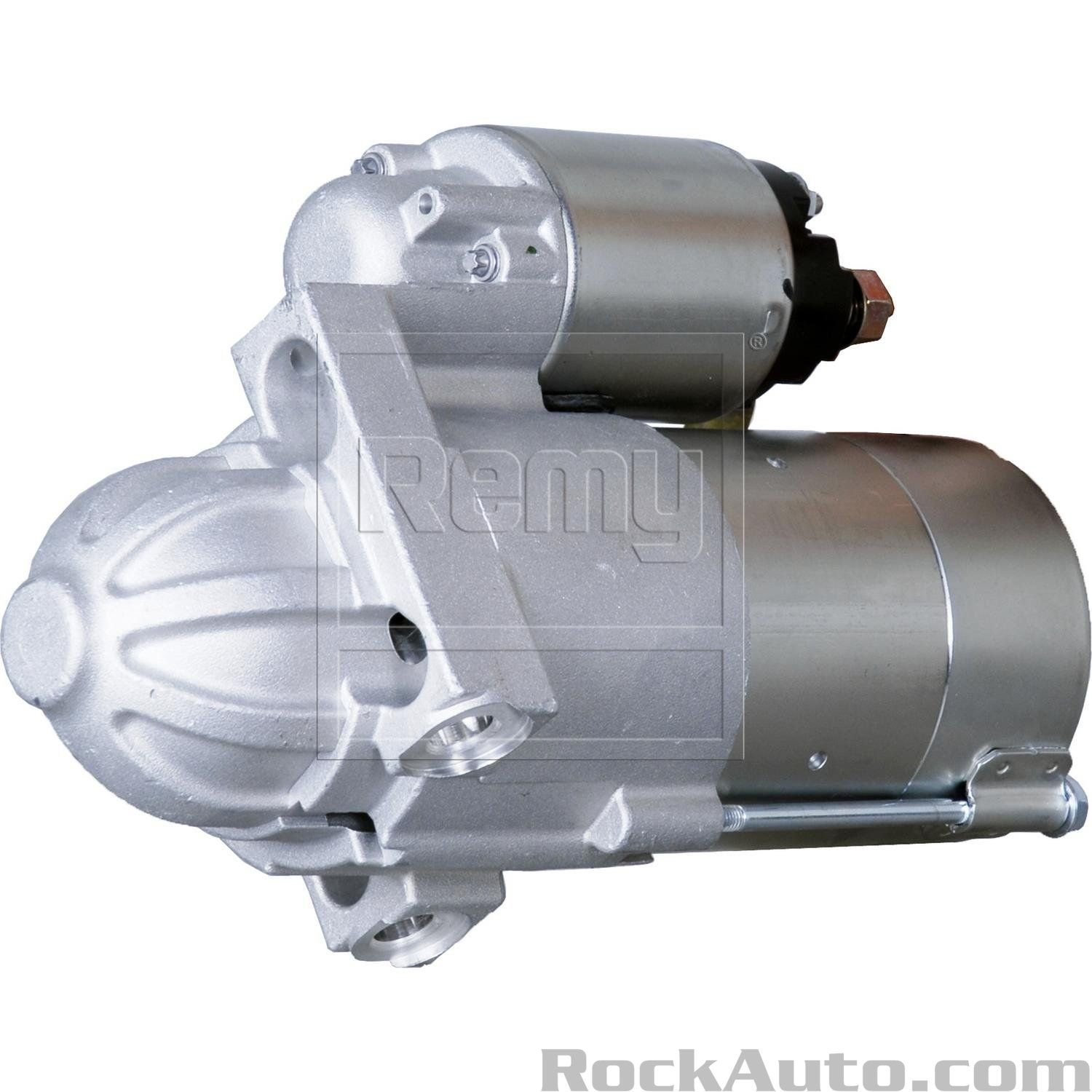

You are looking for the Remy RS41117 starter that has the "R" terminal but that part may be hard to find. Some clones on Ebay but starting to get pricy.
If you can get by without the "R" terminal (points ignition resistor bypass), you can use the Remy 96206. These are about $80 at Rock Auto. They require specific special bolts to mount them as the nose cone is different than original. This is what I am running and it works great even with my sidepipe headers. They are LIGHT!
