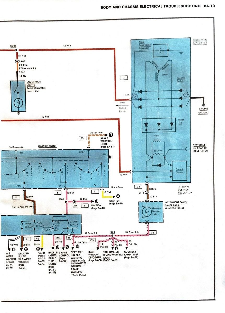

you can download electrical here..
https://www.corvetteforum.com/forums...-in-color.html
note selections and what is wired in acc.. ACC wipers and radio.. that's it.. although mine is set to also have USB charger and bluetooth to OEM radio

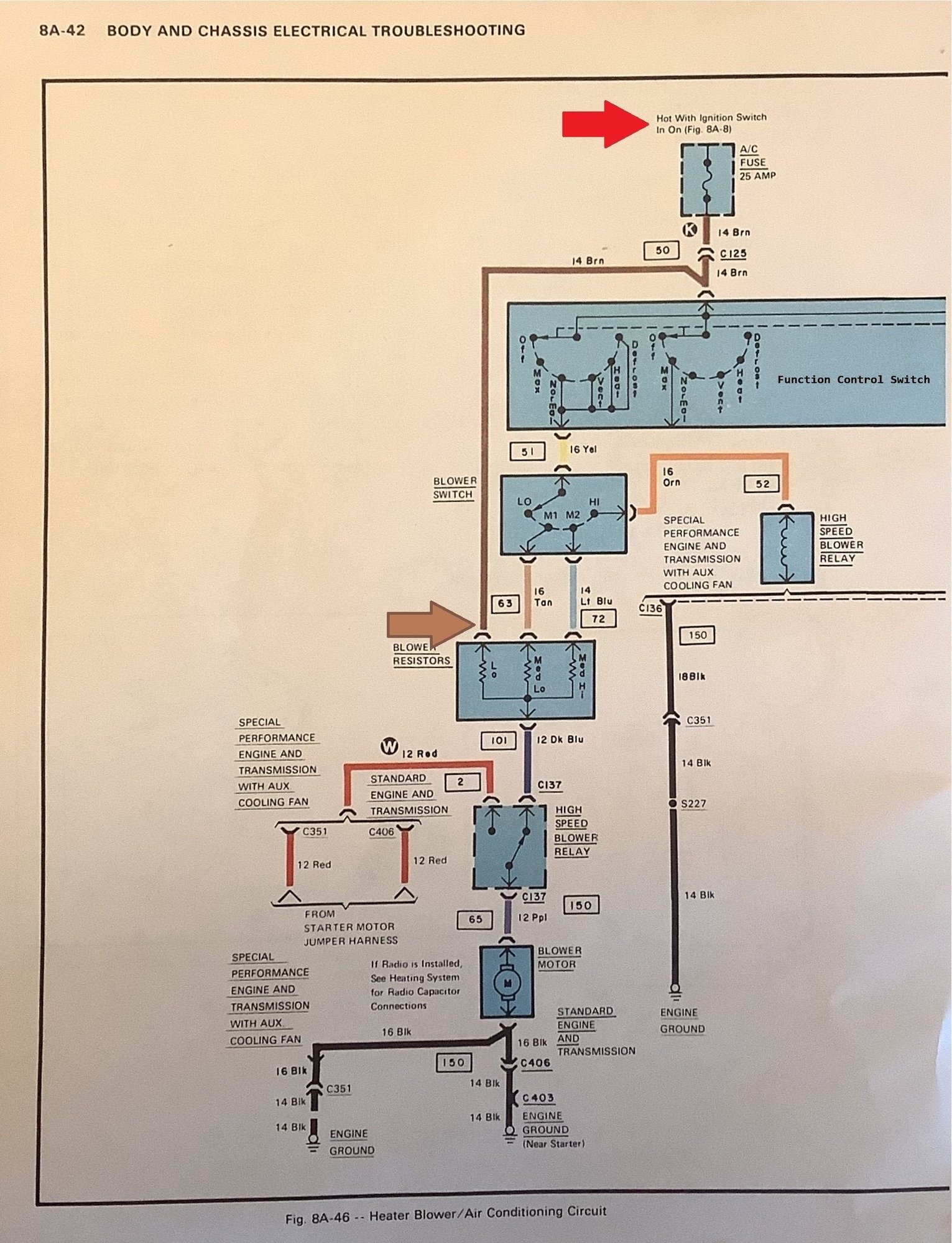

In the engine compartment there will be a fiberglass box containing the evaporator. On the top of that box you will see a 4 wire connector plugged into the Blower Resistor...
If you remove the Brown wire (Brown Arrow Circuit 50) from the connector you have bypassed the LOW speed of the Blower Motor...
If removed, you will want to put some electrical tape or shrink wrap on the now exposed F/M terminal as it is HOT when ignition switch is in the ON position...
The fan speed selector switch will still function normally...
