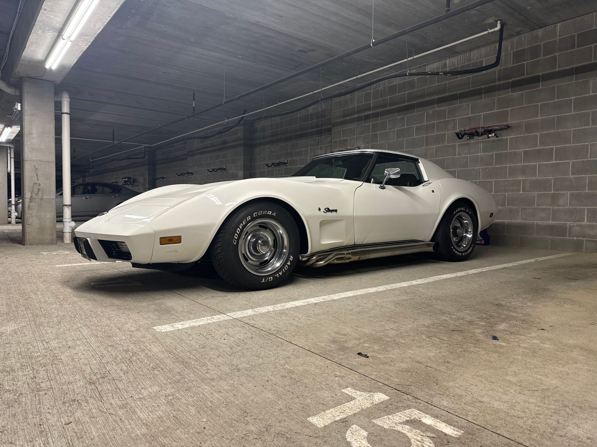

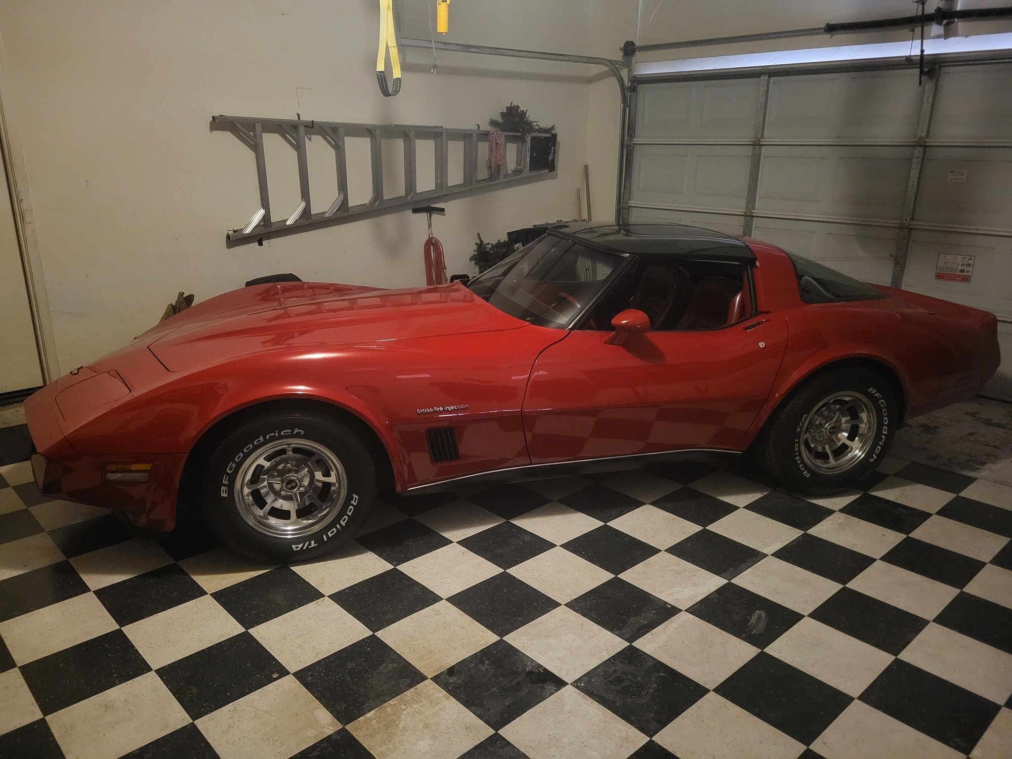

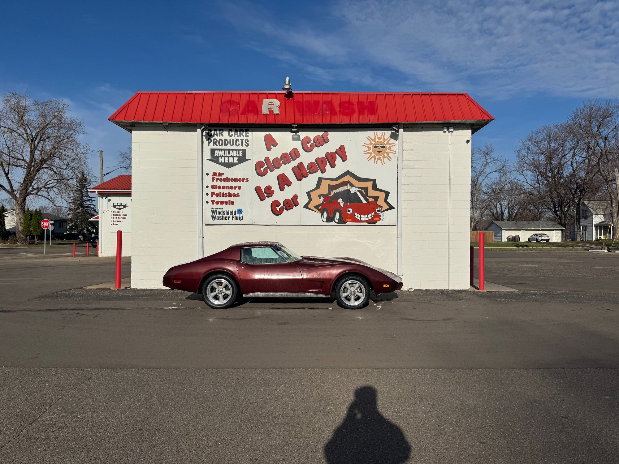

A 255/50r17 tire in the front would make it look even better and lower, but here’s a before and after of cutting a coil out of each front spring.

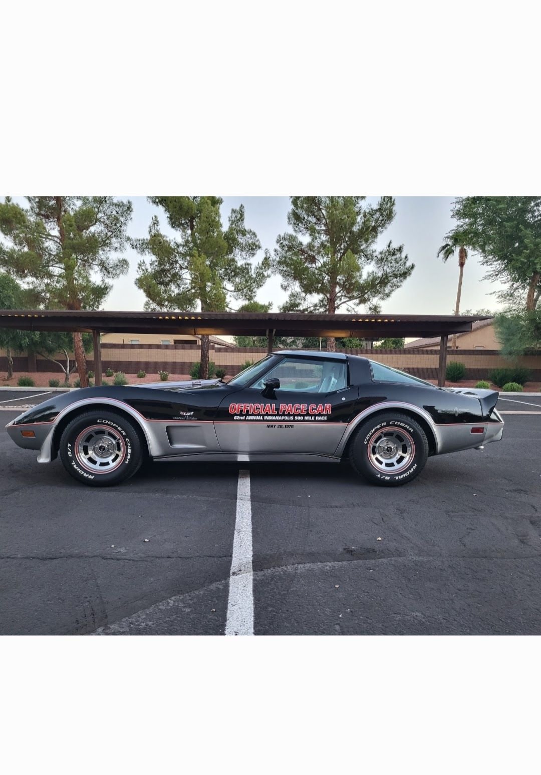

Good idea, pictures of a 77, aluminium heads, intake and radiator, electric fans. Etc.
One full coil cut out of original springs. 255/60-15's
even Bilstien shocks.

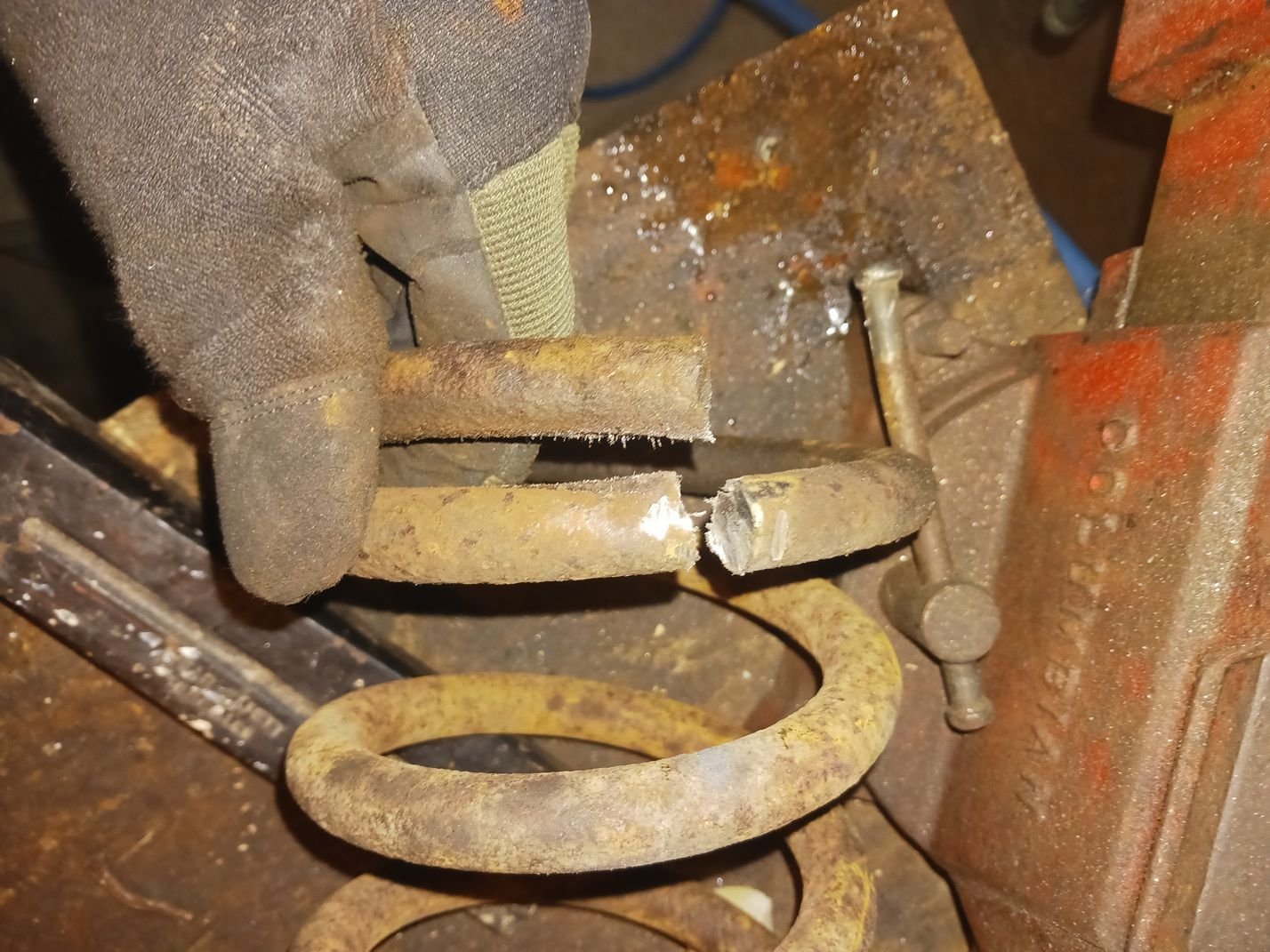

I still have all my fingers, so no, I did it outside of the car.
Funny enough these springs in the maroon car are the original ones from the white one. I’ve used the method in the video below multiple times with good success to take them out.

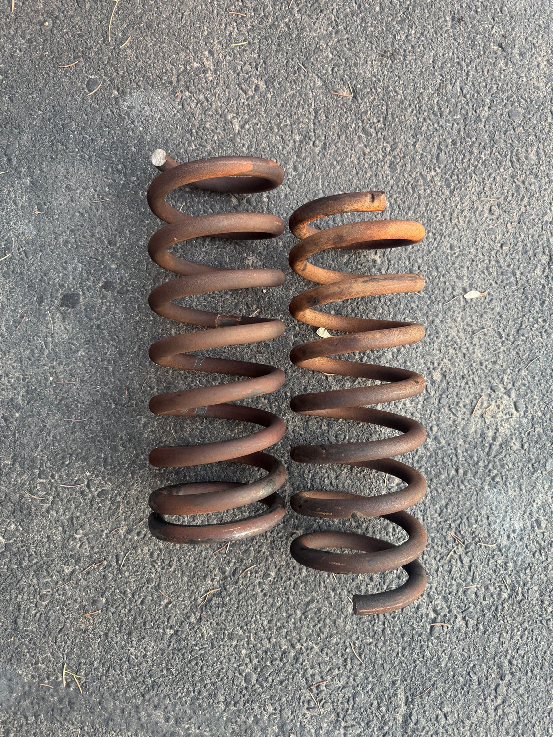

OK, pulled the coils, but both ends were flattened. Cutting one full coil looked to me like it would only take an inch off the ride height. Thinking maybe the un-flattened coil would flex more when it seated in the lower A-arm, I trusted the advice, cut the one coil, put it back together and got exactly one inch of drop when it was back together. WTF? Did I mis-understand, am I supposed to cut the flat coil AND one additional coil to get 2"? I'm down from 29.75" to 28.75", was looking for 27.5" or so.
The only consolation is that instead of three hours a side (nothing taken apart in 48 years apparently), I should be able to do each side in an hour now that everything's broken free and cleaned up.
Also, if I cut a partial coil, I assume I still seat the top and let the bottom end fall wherever it ends up? I ground and wire-brushed the cut end so it wouldn't be a wear point.
