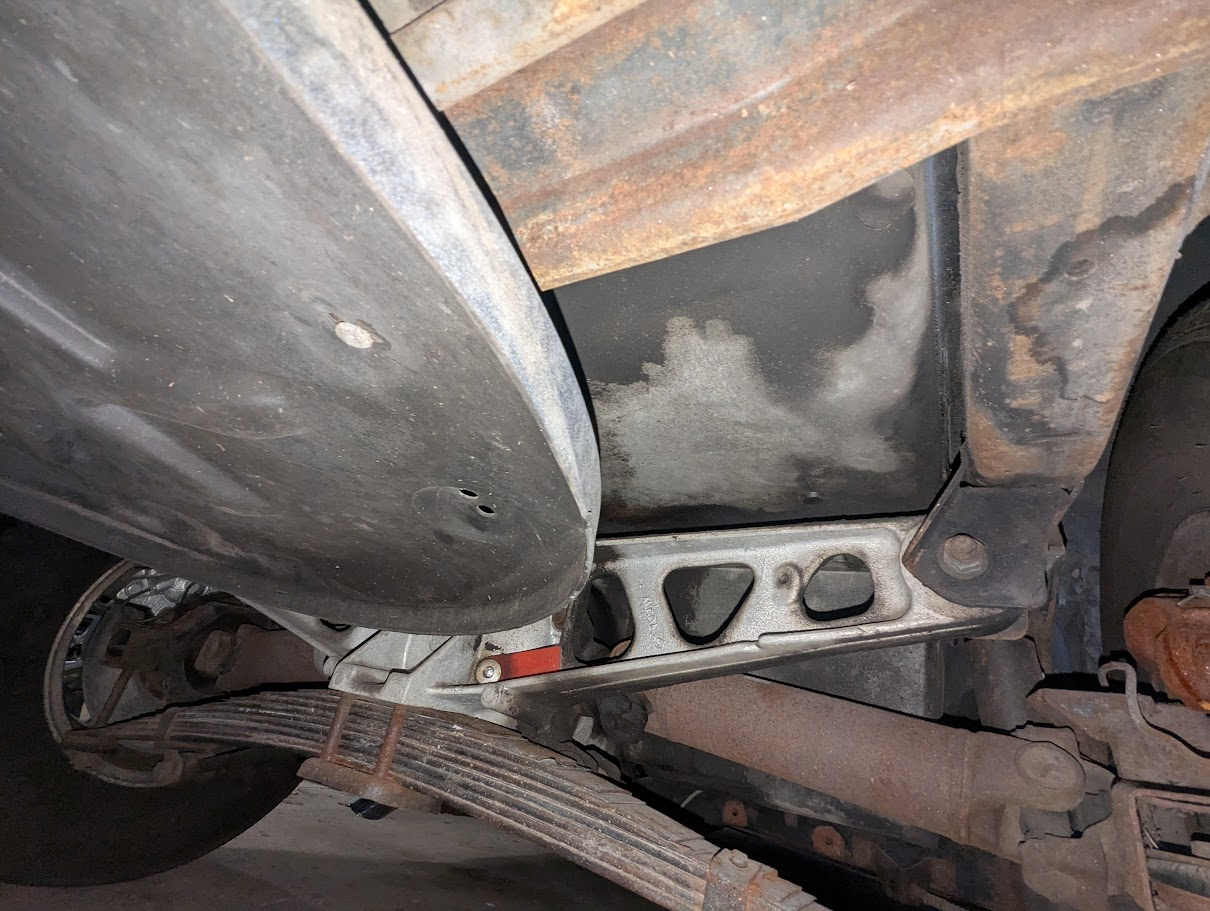

Hello, all! I am still a newbe for the Corvette world.
Last year I bought a 1981 as an impulse buy, and I keep finding suprises.
The car did not come with a spare wheel, and I am trying to find the missing parts, but I am having a hard time figuring out where the back 2 bolts of the spare carier are supposed to go ...
It looks like I am missing a frame cross member?

The bolts are 5/16" and the mid portion of the hook fit into the notch just below the bolt hole.

You have an 81 with a steel spring, yet I don't see a rear sway bar.
Do you know if your car originally came with a gymkhana suspension (option code FE7), or if that is a replacement spring?

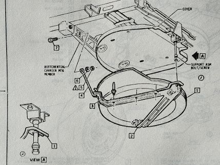

The front two spare tire hangers are bolted to the differential's aluminum "bat wing" crossmember, and the front of the tub's "Y" brace hangs from the loops at the ends of the front hangers.
Below are the pages from the Assembly Manual showing the installation of the front hangers and the page showing the rear lock bolt (though 1981's no longer came with a spare tire lock).
Gymkhana Suspension wasn't the only 81's that came with the steel spring in place of the composite one. 4 speed 81's came with the steel spring, and I think ZN1 trailering package used it too, but I'm not sure that's an OEM steel spring either. OEM springs usually have a slight upturn to the end of the leaves, and were painted gray.

Thank you so much! This is exactly what I was looking for!

Originally Posted by gbvette62
Gymkhana Suspension wasn't the only 81's that came with the steel spring in place of the composite one. 4 speed 81's came with the steel spring, and I think ZN1 trailering package used it too, but that's not an OEM steel spring either.
It is a 4 speed.
